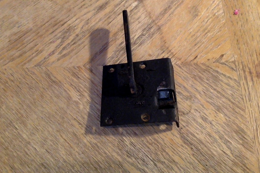

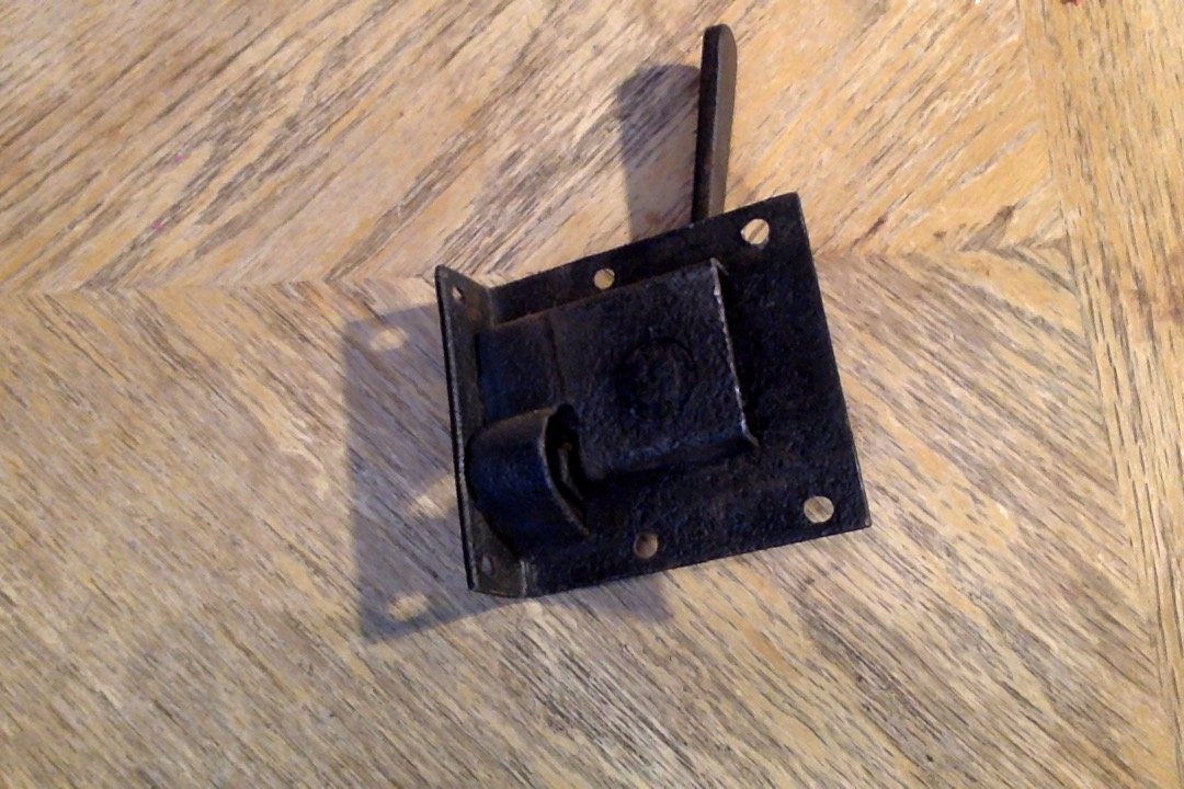

Could this door handle be repaired? It is from my 1916 Model T touring. The two pieces appear to be soldered together. Although the handle itself is good the spring mechanism has gone bad, and every time I get a few feet down the road the door swings open. What can be done?
Posts: 4404
Re: Door handle repair
Post by Jerry VanOoteghem » Tue Mar 26, 2019 8:33 pm
I'm pretty sure nothing has been soldered together, at least not originally. The back cover should have small tabs that fit into small slots on the mounting plate. Those tabs would have extended through the mounting plate just a bit when first assembled. Then the tabs got peened over. You can try grinding off the peened part of the tabs, tapping or prying the cover off, installing a new spring, then brazing the assembly together.

Thank you so much advice! I do not own any metal melting equipment such as a soldering iron or acetylene torch, so I will try and use a the chisel method and hope enough of the tabs are left.

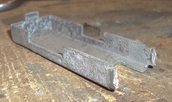

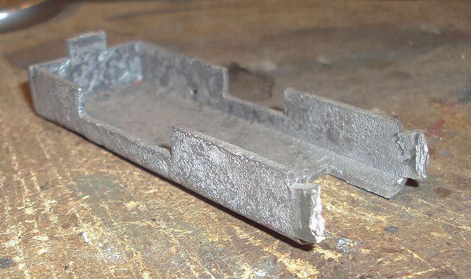

Post by Rich Eagle » Fri Apr 05, 2019 12:47 pm
This is a later one to give an idea what it looks like to any who haven't seen one. I'm sure Charlie's is a good method and I will try it. I'll still narrow them a little with a chisel first. Grinding the tabs would leave less metal to peen over so consider not doing that.
