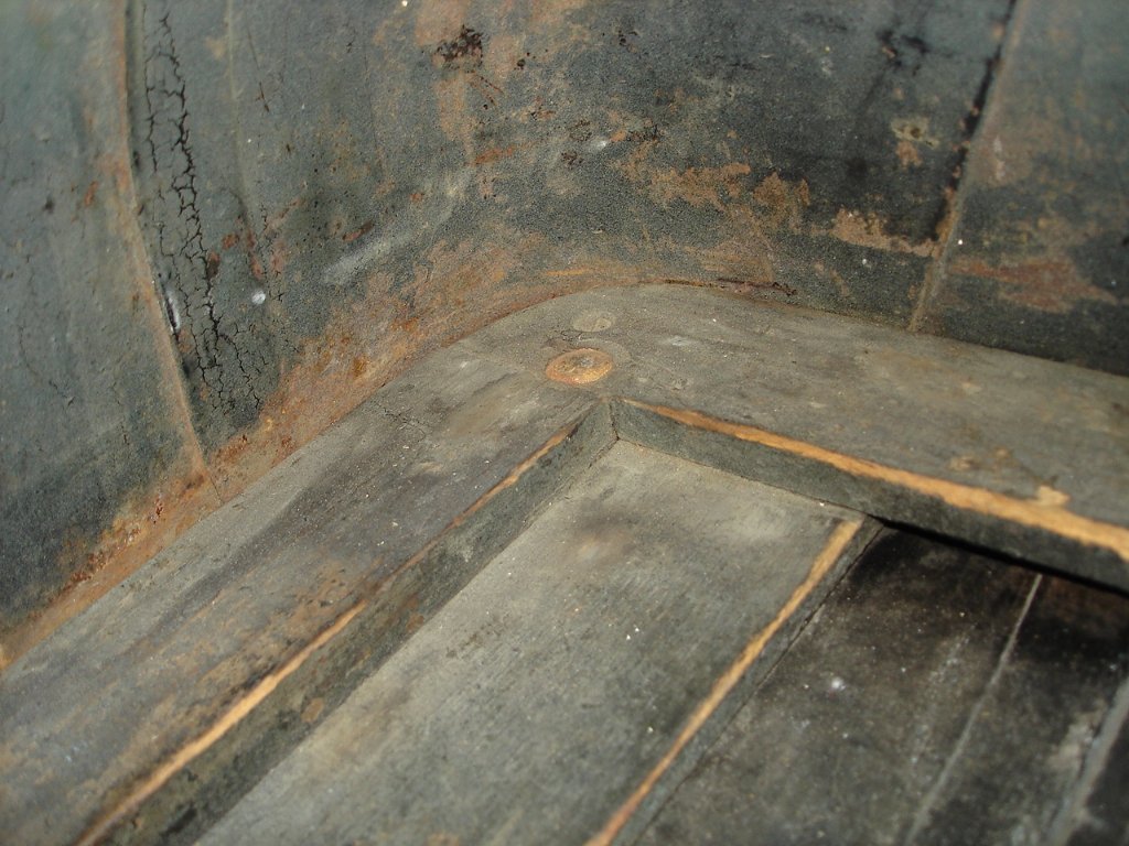

Below is a link to a previous thread about attaching the turtle deck on a '21, different year, same basic attachment. I do not have any photos of my '20 Runabout and its turtle deck mounting, but I can assure you it is the same as shown in the photos in the link (I have attached one to this thread).
viewtopic.php?f=2&t=20479&p=156646#p156646
I agree with Scott, it looks a bit low, but that may be because of it not having the right frame/base to sit on, also it is just a dry fit right now. The corners look a bit off to me as shown in the photo below, but that may just be the photo.

As otherwise mentioned, the turtle deck does not attach to the back of the front body or seat. It is held on by four bolts that go through the wooden deck and/or sills. One bolt in each corner, as seen in the photo posted by Pep C. The front piece of the wood frame is done a bit differently. Simple enough to do, but hard to explain.
