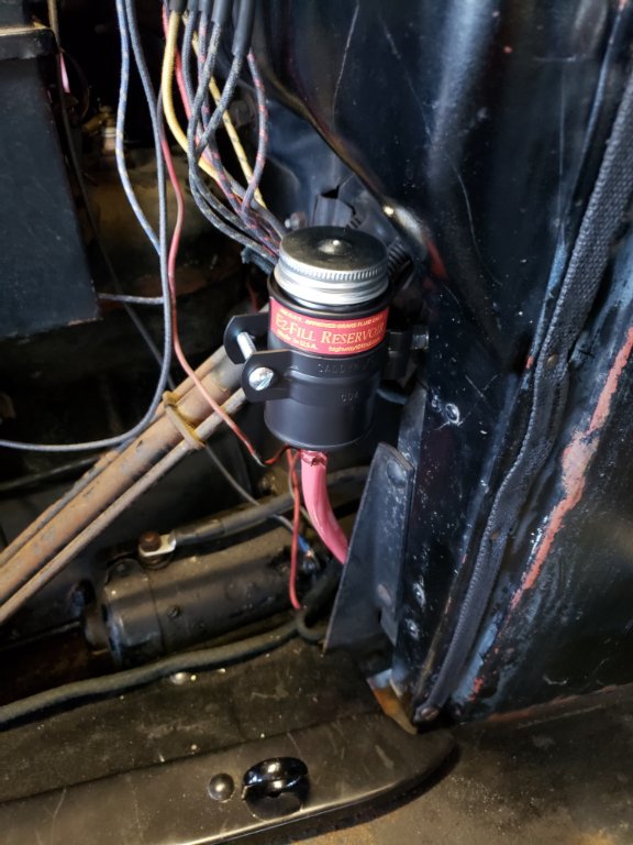

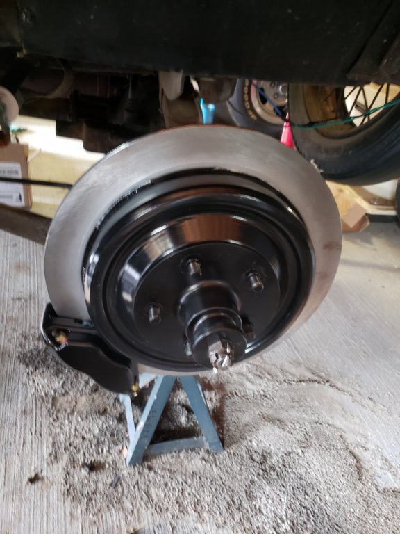

Just finished this project before winter rolled in on my 26 Touring. I used the pressure bleeding method. The master cylinder interfered with a wood support on the floorboards. My floorboards are the new solid wood ones I got from Lange's if I remember correctly. I carefully pried off the support and moved it over. I used the more time period looking EZ Fill reservoir and painted the calipers satin black using paint specifically made for brake calipers. Search this forum for the bleeding ideas and the EZ Fill reservoir. The reservoir required no drilling; I mounted it to the steering column mount using a longer bolt and an extra nut to space correctly. I also replaced both my hubs as one had a very worn tapered hole and the other was for a wood wheel redrilled for my wire wheels. My axles and bearings seemed fine but I did need axle taper shims to make the fit perfect. I needed two different thicknesses. Took trial and error to get the right combo.
