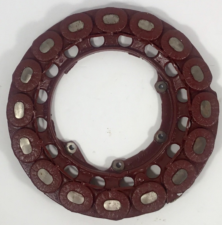

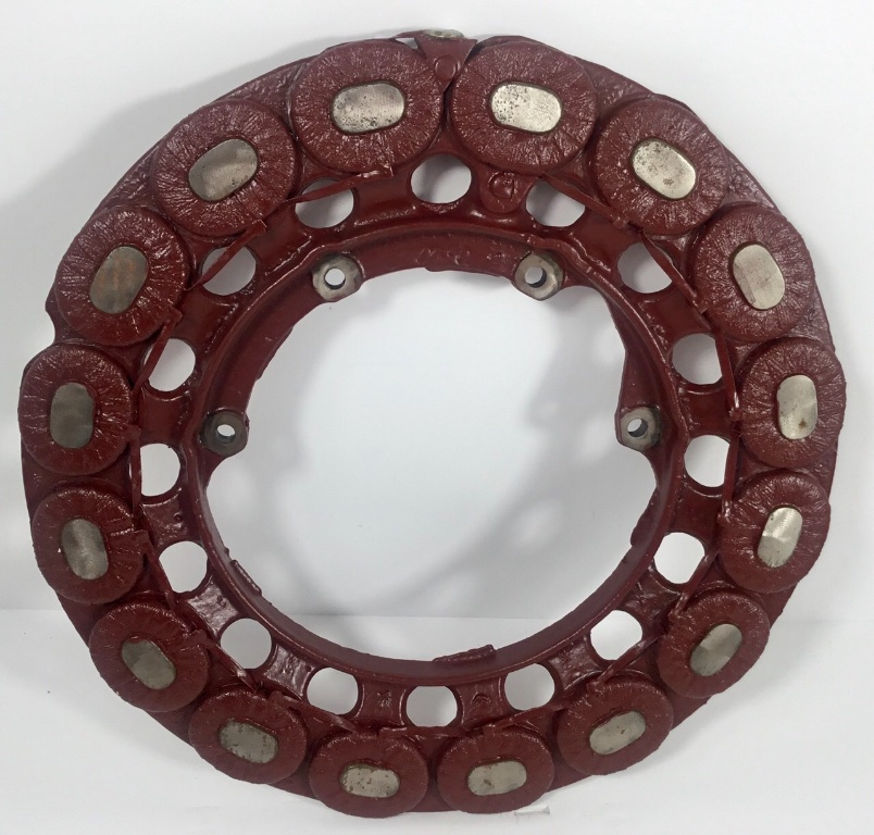

I am selling a rebuilt single stack magneto coil on eBay that was rebuilt in 2010 by Wally Szumoski of Chicago, IL. It is for use on 1919-1927 starter equipped cars. I remember that all of us were upset when Wally retired because he was the best. This mag coil has never been used because I originally purchased it to use on the engine rebuild of the 1926 Fordor sedan I am currently selling on eBay and no longer need it. Are the rebuilt magneto coils these days as good as the ones that Wally rebuilt? What kind of wait is there when ordering a rebuilt magneto coil? Jim Patrick

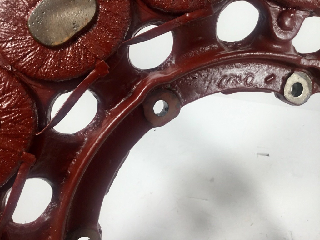

All the years I dealt with Wally they where never red glyptol, RV where red.

I agree Joe - Wally used a "clear" coat of some kind. He did mine for 30+ years !

Thank you for your input. A little clarification is in order on my part. The following information is listed in the description on eBay, but I figure I had better list it here as well. When I received the coil from Wally, I had never seen the clear yellow resin so I was unsure of whether it was heat cured or how well it would hold up inside the harsh environment of the transmission, but I was familiar with the protective qualities of Glyptal, so I took the extra precaution of applying a coat of Glyptal and heat treating it for two hours in a 250 degree oven as the instructions call for (www.mtfca.com/discus/messages/118802/152476.html). Since Glyptal is what Ford originally used to seal the magneto coils I figured it could only help. At the time, in July, 2010, I ordered two rebuilt coils from Wally. This one and the one I put in my 1926 coupe, which, at the time I was overhauling and applying Glyptal to the oil pan, engine block and hogshead. I applied Glyptal to the one I used as well and after 11 years, the Glyptal is still holding up great! The results of my curing the Glyptal coated magneto coils was a rock hard coating of Glyptal in addition to the clear yellow resin seal that Wally used so it should be extra well protected from the heat and oil of the running engine for as long as you own your T. I looked up the price of a rebuilt coil at Lang’s which is $299.00, which does not include the $50.00 core charge or the $25.00 or more shipping costs for the 16.6 lb. coil that will be incurred to ship the core to them. A $75.00 savings in addition to not having to wait for the coil and additional benefit of having a new coil rebuilt by Wally. Everyone have a Merry Christmas. Jim Patrick

Since Glyptal is what Ford originally used to seal the magneto coils...

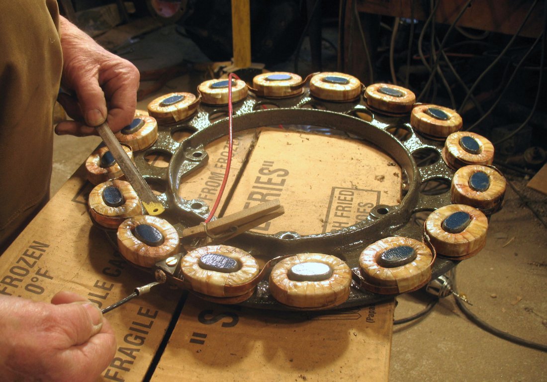

I'm not sure when Glyptal was first manufactured and sold, but I doubt its been around for 100 years. Thirty, maybe 40, is more like it. The Glyptal website says the average Glyptal employee has been with the company some 20+ years. At any rate, its a good product and has earned its place as a staple in industry.Steve Jelf wrote: ↑Sat Dec 18, 2021 11:36 amSince Glyptal is what Ford originally used to seal the magneto coils...

Glyptal is a Trade name of an alkyd additive to paint, and has been around 90+ years having been developed for GE in the late '20's. It's pretty much been co opted by the trades as "Glyptal" much as "Q Tip" is synonymous with cotton swabs.
It really is good stuff, but requires a bake as Jim mentioned, for it to become its best self. Few folks go that step and unfortunately don't achieve the level of protection that they could potentially get. Even when processed somewhat incorrectly, it provides very good protection within its design parameters.

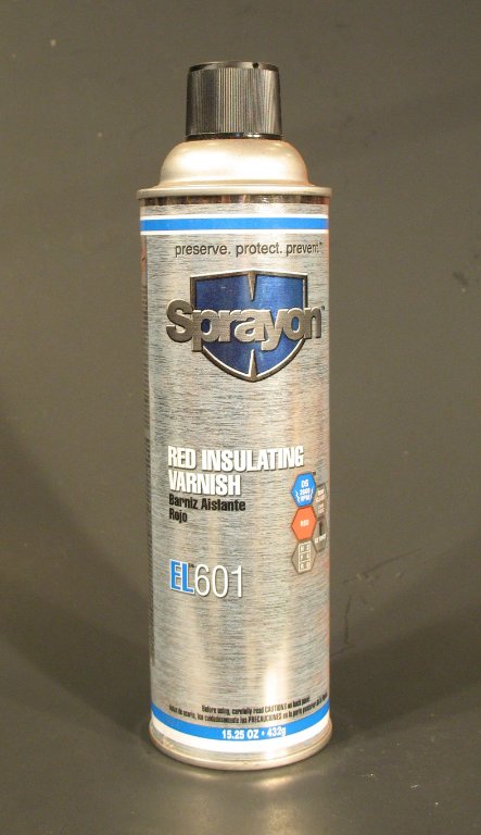

Another name is insulating varnish.
Sprayon makes it in red (601) and clear (600). Prices vary widely. It pays to shop around.
I used the clear in my mag coil ring.

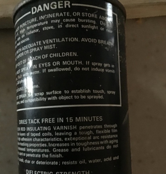

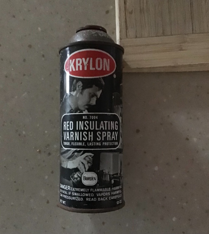

Here’s what I used in the mid 70’s. Krylon no.7004 insulating varnish and probably a form of glyptol. This can has been around 50+ years. I forgot I still had it. Then read this post and I remembered I kept the last can I had. Krylon was founded in 1947 and Glyptol was developed in the teens by GE or so I read online.
It’s interesting that Borden owned it along the way and sold its interests to others in the 90’s.
Reading the back of the can it must be some potent stuff. When I coated the mag ring on my first tare down of my 24 coupe in the seventies I sprayed it the same red color as J Bartows pic of his. It held up pretty well considering I cleaned up the mag ring with kerosene and dried it off, let dry and sprayed it! Nobody was rewinding them that Iknew off at the time.

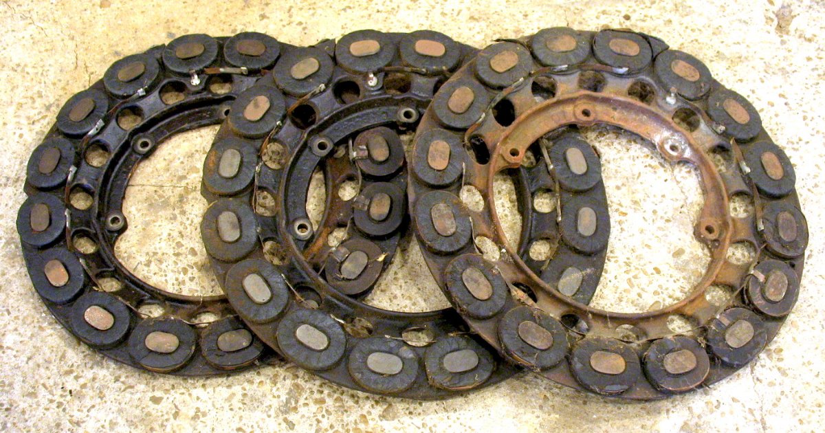

"Since Glyptal is what Ford originally used to seal the magneto coils................"
Shellac was originally used, its solubility in alcohols makes it easier to disassemble methanol soaked coils from the stator ring when doing a rebuild, and makes original mag ring coil insulation vulnerable to damage when alcohol blended fuel accumulates in the crankcase.

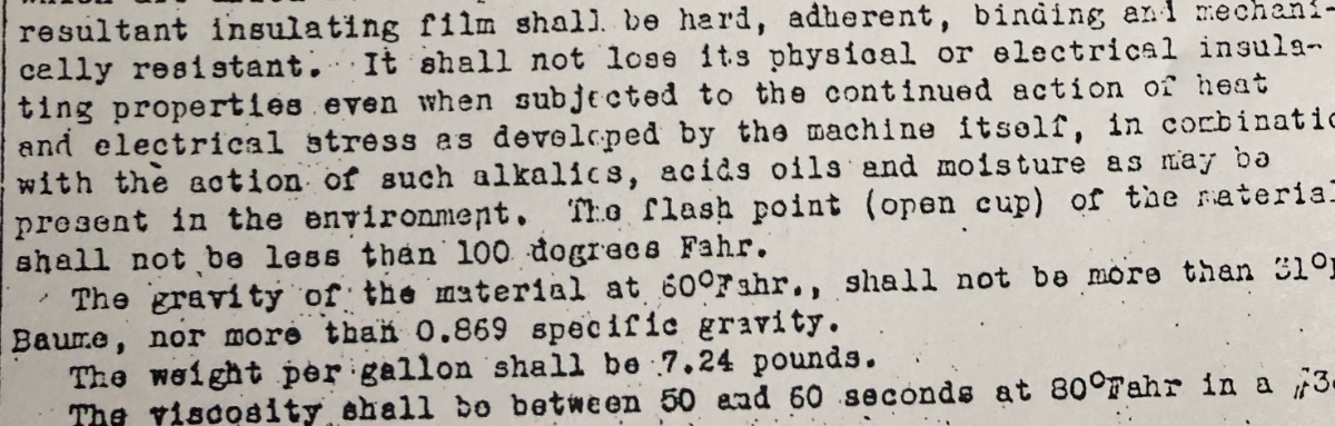

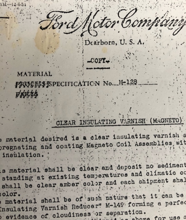

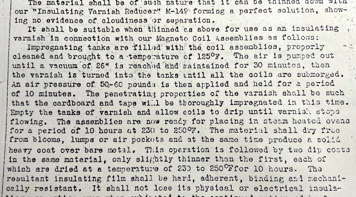

Here is the actual specification for the " clear insulating varnish" used by Ford, sure wasn't red insulating enamel!"Since Glyptal is what Ford originally used to seal the magneto coils................"
and the details:
And the process of application at the factory for coating mag rings, a submerged coat under pressure, and two additional coats with heating to harden the varnish coats. With this quality application, no wonders that some mag rings are still good after 100 years

Thanks Dan:
Do you have the full text of that specification? or the reference? My statement regarding use of shellac may not be correct for all years, but I still maintain the varnish was alcohol soluble. And apologies to Jiminbartow for extending his thread. jb

shellac is thinned or dissolved by alcohol. Varnish is impervious to alcohol.
