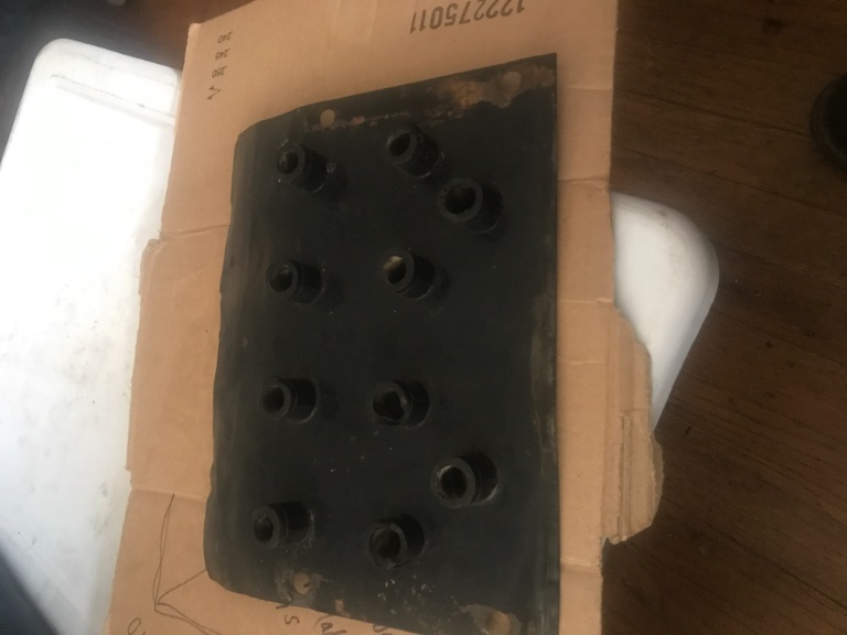

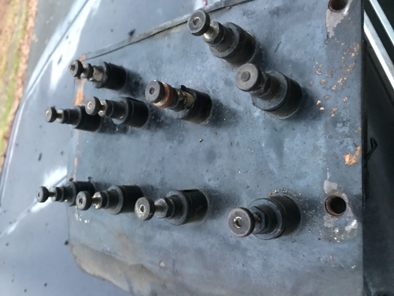

The engine timer is a "twin timer" , nothing about it shows in searches, is it going to be trouble?
There's this tin with rubber sleeves between the coil box and firewall--- I don't see parts to replace the rubber, is it something I should leave out?

Throw the "tin with rubber sleeves" in the garbage. Has no place on a Model T.
Edit: Sorry if that sounded angry or abrupt... As Scott suggests below, leave it out for now. Like your accessory timer, it's a variable that you don't need right now. Get everything "back to basics", with a known good set of coils and go from there.

it sounds like you are doing all of the right things. The rubber/tin boot is an accessory and as Jerry advised leave it out. If after everything is running right and you just love it...put it back in and see how things go.

If the rubber insulators are old, they have likely lost a portion of their insulating properties. If they were ever run wet or dirty, they may be carbon tracked. Most black rubber contains carbon black, which is a conductor . Carbon black does not decay, but rubber does, and old rubber insulation might be expected to have poor insulating qualities at high voltages, even if it's never been used.
Wouldn't do that to an old time Model T accessory......keep it, someone will want it as a display/wall hanger :D

Yes Dan, you're correct. I honestly didn't realize it was an actual T accessory. I thought it was a home made gizmo. Still think it will not help the OP's situation to leave it installed.
