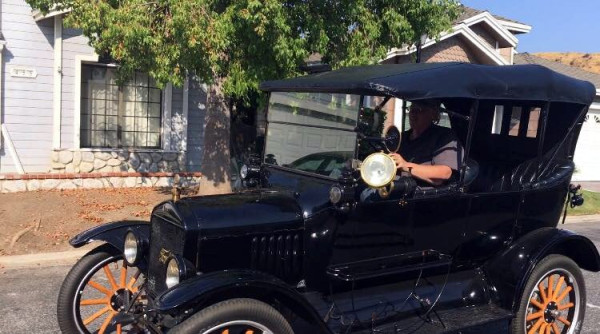

Post by Original Smith » Fri Dec 24, 2021 11:13 am
How many of you have built a Model T from parts? I mean every single part, including nuts and bolts? That includes building a complete engine and transmission, rear end and everything! How many know the difference between an original Ford bolt and nut and the Home Depot variety. The new replacement bolts that Lang's sells are an exception.

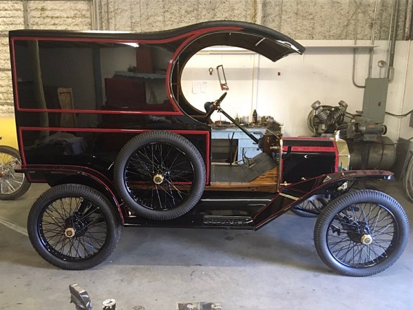

Post by Mark Chaffin » Fri Dec 24, 2021 11:27 am
Both built from scratch.

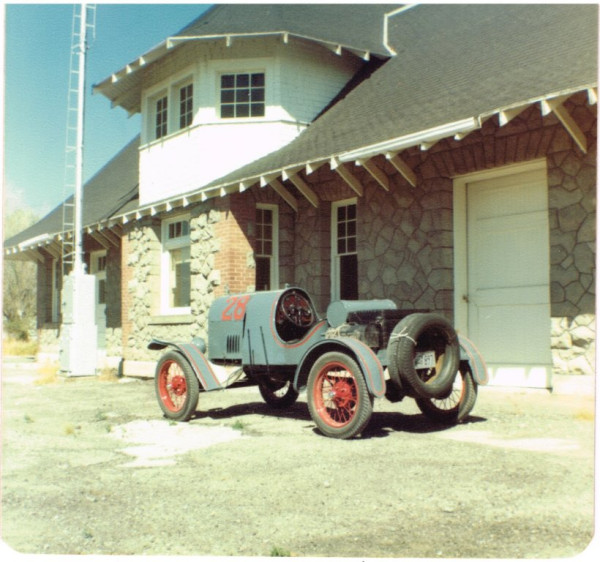

Post by RajoRacer » Fri Dec 24, 2021 11:44 am
Built this including the hand formed steel body near 30 years ago now, I guess - I'll attempt to fine a photo of my wife's '15 Fire Chief's rig - a works still in progress ! I "farmed out" the paint & leather.
Merry Christmas !

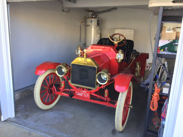

Post by Steve Jelf » Fri Dec 24, 2021 12:10 pm

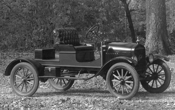

There are more 1915 Fords today than there were in 1915.
My runabout is one of those ersatz 1915's referred to in the old gag, but I wasn't the one who assembled it. I believe that was done about 45 years ago. The chap who did it used mostly correct parts, with a few glaring exceptions (frame, rear spring, drive shaft tube, steering column, dash shield). I'll keep the frame, but I've corrected all those other things except the steering column I still have to do. I didn't find any Phillips screws or other blatantly wrong fasteners. Where I've had to use modern bolts I grind and buff away the modern markings, strip off the cad plating, and paint. At the Model T Haven sale last month I acquired two boxes of hardware I hope will contain enough Model T bolts to replace the modern ones on my cars.

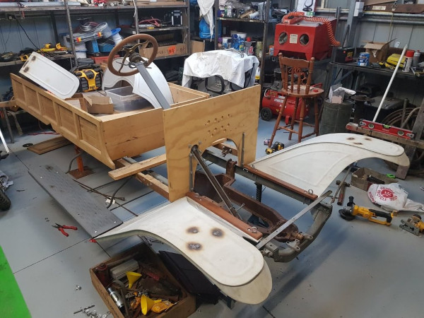

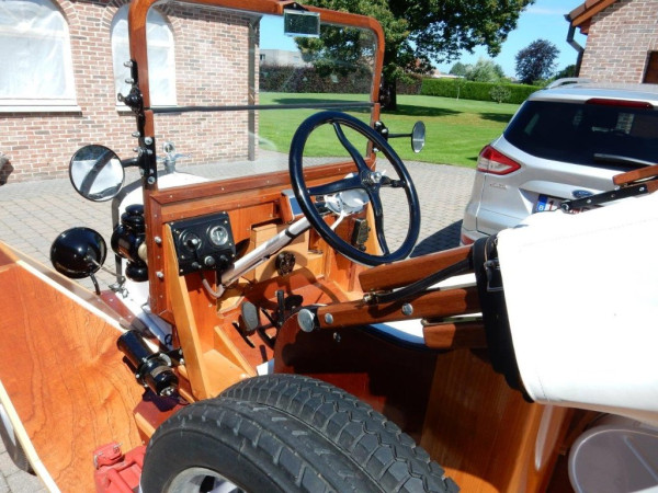

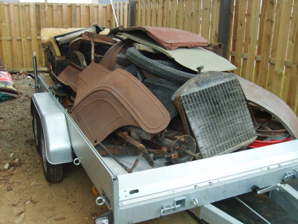

Post by AndreFordT » Fri Dec 24, 2021 12:37 pm

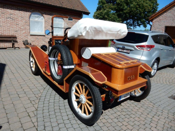

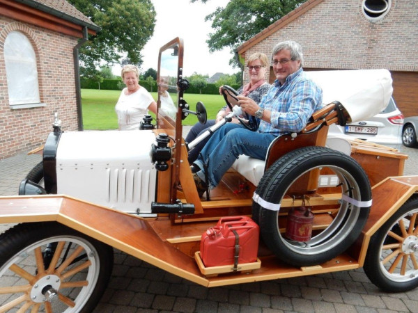

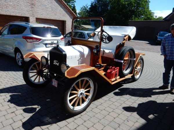

1922 parts and papers.
Body was toooooo bad and dicided to make one.

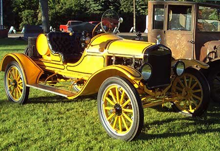

Post by Harry Lillo » Fri Dec 24, 2021 12:43 pm
Collected period speed parts and original parts for 10 years for my 13 speedster.
Took the frame apart and put in new hot rivets. Don't think they were Ford rivets but they were old.
Poured my main, rod and cam bearings and bored them.
Did my body, front and rear end including machining the lowering brackets after having them cast in manganese bronze.
I didn't tan the leather but had the upholstery done by a professional. The only work done by someone else.
Paint and body work was done here in my garage.
I believe I can say that I built this one from scratch.

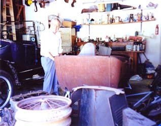

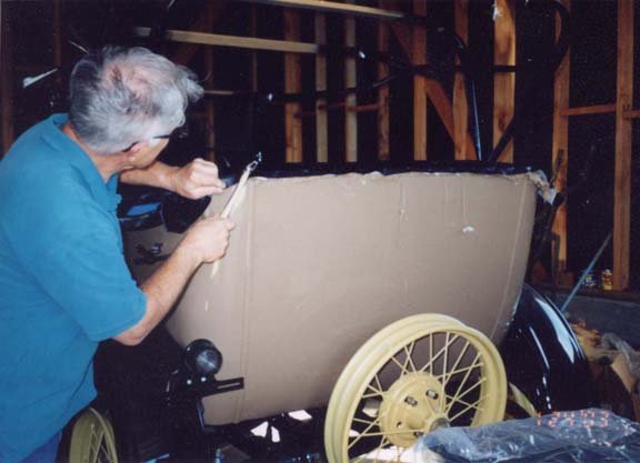

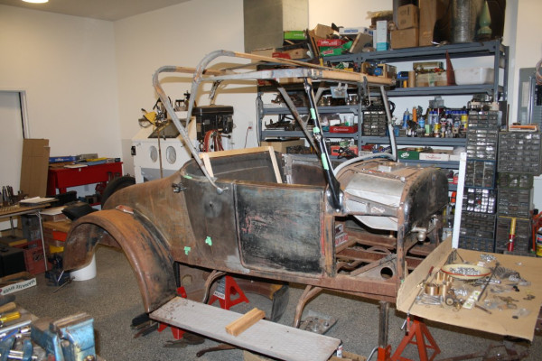

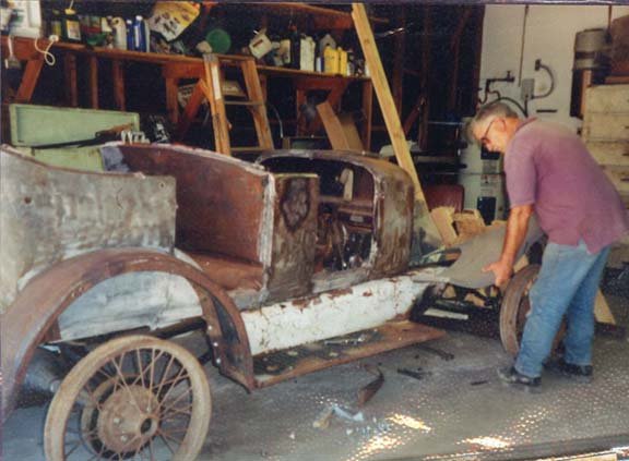

Post by Norman Kling » Fri Dec 24, 2021 1:42 pm
Day bought
Day bought
26 touring as purchased.jpg (61.04 KiB) Viewed 12352 times
Rusty parts
Rusty parts
pile of rusty parts.jpg (41.21 KiB) Viewed 12352 times
Fitting parts
Fitting parts
fitting parts.jpg (68.15 KiB) Viewed 12352 times

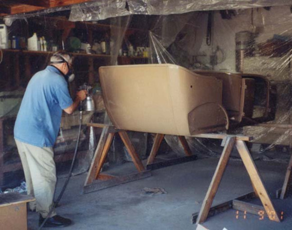

Painting
Painting
Tacking Upholstery
Tacking Upholstery
tacking upholstery.jpg (52.91 KiB) Viewed 12352 times
There are more pictures. You get the idea. I bought this car on Easter Sunday, but it took about 10 years to resurrect. I was retired when I bought it and it would have been a retirement project, but about a week later the phone rang and I worked another 15 years.

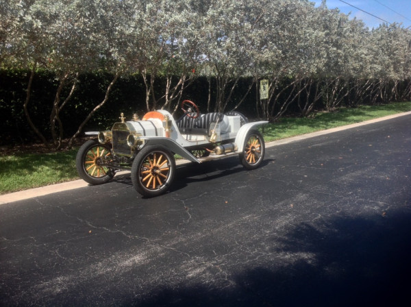

Wife wanted a speedster so the parts I had been collecting for 20+ years became one.

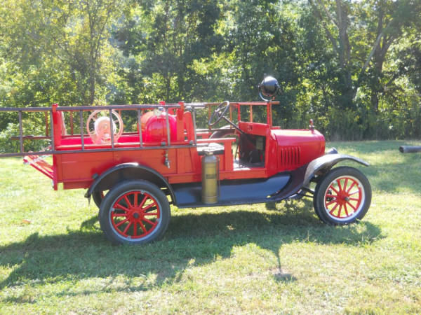

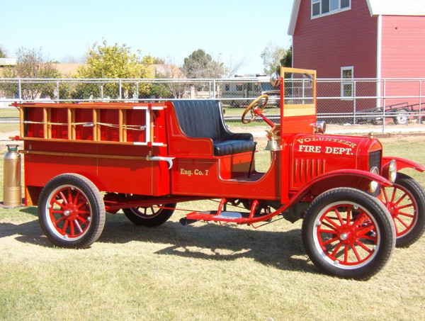

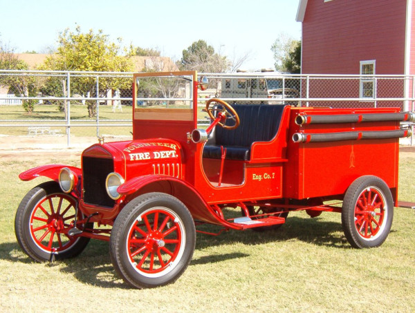

Built from scratch is about the only way I can afford one. The fire truck started as a frame bought at the swapmeet for $35.00
Craig

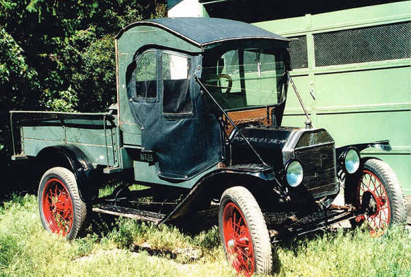

Post by Rich Eagle » Fri Dec 24, 2021 4:07 pm
This was all scratch build on a chassis I had scratch built previously as a racer.
These chassis parts came out of a pile. The body built from scratch and Rootlieb fenders, running boards and splash aprons. A Brassworks radiator and new top irons and bows.
The sheetmetal was mostly all from the same car. Everything else was acquired one piece at a time. Many items are more correct than a lot of pristine restorations.
This body was constructed with new wood and sheet metal from 3 bodies plus additional pieces. Having duplicate panels one can choose between rusted out, bent to heck or full of bullet holes. However the chassis had been a complete 1925 Runabout.
The Runabout was the only complete Model T I ever was able to buy.

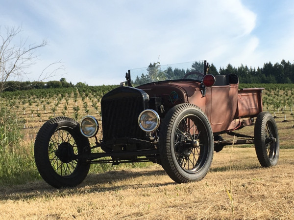

Post by Powerwagonmaniac1 » Sat Dec 25, 2021 12:52 pm
Everyone’s favorite Bitsa, Carston’s nuthin’ special. Starting in January we are rebuilding a new engine and transmissiofor her. Also adding Rocky Mountain brakes and iron vase Warford.
CB99FD17-6801-4D3F-9CB9-D1BC012F7ADE.jpeg[/attachment [attachment=2]E79013E5-2CBB-42BC-B6D9-3DAFEA47DA9A.jpeg
and my favorite my dad’s 1919 touring Tin Tillie we drove her on the national in Spokane last summer Carston and I had so much fun with our Bitsas.
A couple of other bitsas you might remember

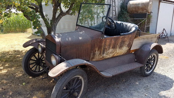

My speedster came to me as an '18 chassis with an unloved plywood pickup body, a brass radiator and repro '14 fenders back in the early '90s. The engine, fenders, running boars, brackets and wood wheels moved to another car and while I used the brass radiator for several years it now lives on another car as well. I kept the frame, rear axle, steering, fuel tank and headlights while the rest of the junk went to a land fill. I found most of the pieces for a 26 engine and transmission that is still in the car. Then came a Chicago aux transmission. I built the body from scratch with a wood structure and plywood skin. After enjoying the car for several years I opted to build an improved body - still a wood structure but a cedar strip skin. Various updates have happened over the years to steering, brakes, suspension and the engine that now has a Fronty head. There is nothing on the car that I haven't touched and massaged, much of it multiple times since it first hit the road in '94. I've had more fun with this car building, maintaining, updating and did I mention driving that any other car I have owned.

Post by A Whiteman » Sat Dec 25, 2021 8:15 pm

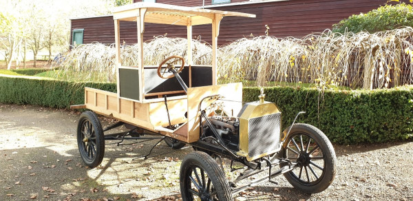

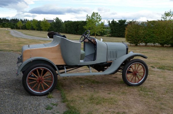

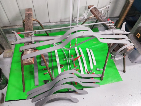

Registered 21-02-09 (2).jpg (64.1 KiB) Viewed 11553 times
Every nut and bolt - still working on it, but at least it is going :-)
How do I tell the nuts and bolts? With care, comparing to other Ts, with advice from more experienced Ters and by carefully keeping each bit when a part is dismantled.

Post by DJPeterson » Sat Dec 25, 2021 9:36 pm

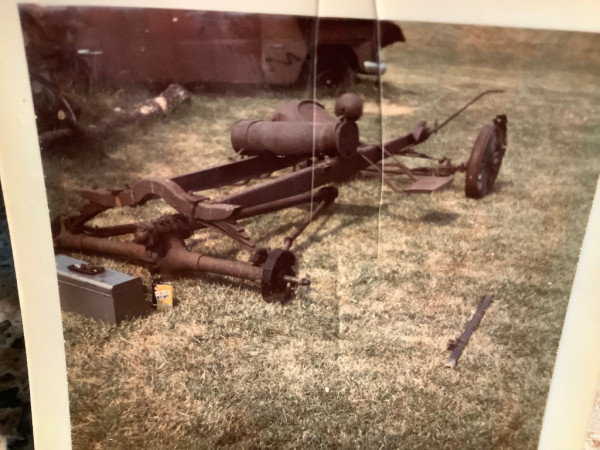

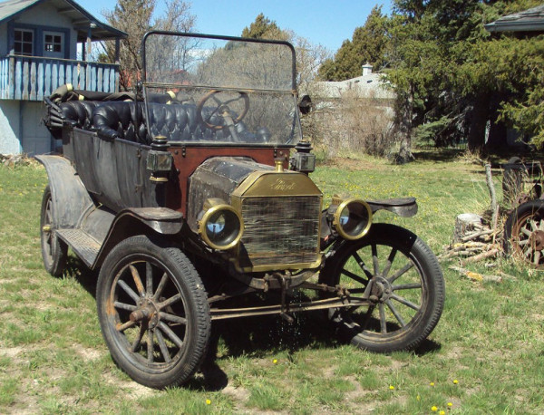

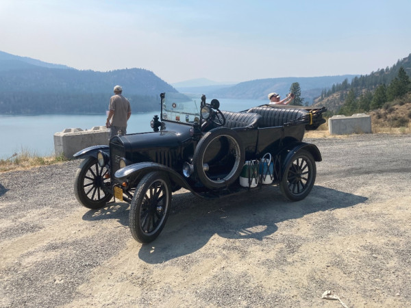

Not built from parts by me, but by my Uncle LaVar. He restored several Model T's over the years. The last one started with a 25 running gear he put together, then intended to put together a runabout. On mocking up the body he decided midstream he had enough shiny T's and shifted direction mid project. He pieced together a roadster pickup with home-made bed, leaving it rusty. He got much more attention with this one and the kids could climb all over it without worries about scratching it. It became his favorite T, and when he was no longer able to drive the T's, Rusty was passed on to me. The picture is of Rusty when pulled out of the shed to be loaded up for the trip to Washington where it continues to be loved, maintained as is and driven often.

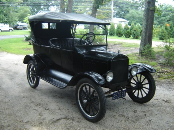

My dad and I built this 1919 as I was growing up..

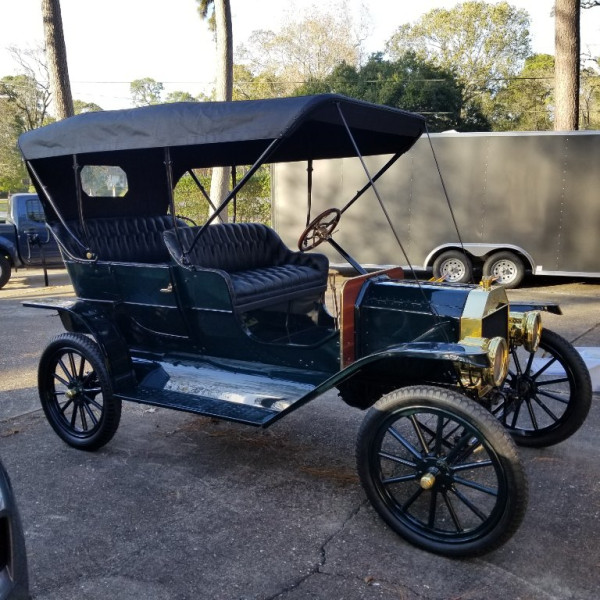

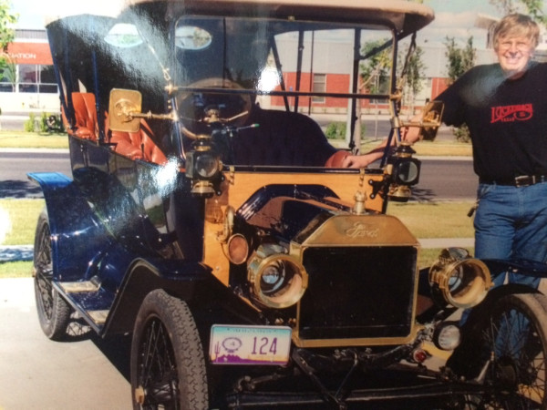

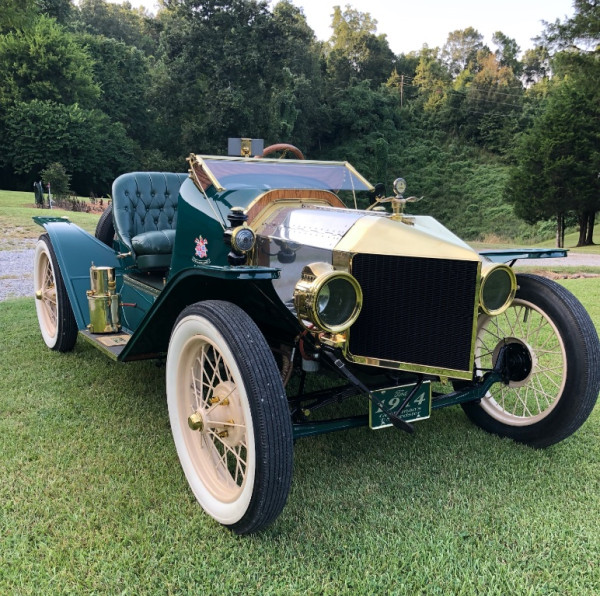

Just about finished with my tribute "1909" touring. Body by Ray Wells and upholstery and top by Ernie Romero.

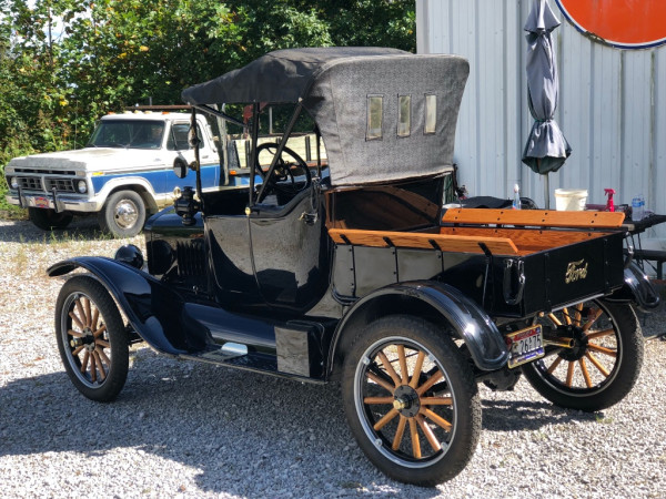

I have a 1926 roaster build from pats in 1993 that won First Junior and Senior that next year. Still have it and it’s currently on its third set of tires and second crank shaft.
