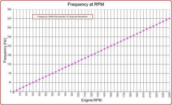

Post by BE_ZERO_BE » Tue Dec 28, 2021 2:26 pm

I got the same formula (only in correct units from start).
When the engine is running 1200 rpm (I guess this will be approximately the case at 30 mph), the frequency will then be 1200 x 8 / 60 = 160 Hz or in other words, 320 Half Waves. So one half wave has a length of 1/320 second = 0.003125 second = ~3 milliseconds
From this length approx. 2/3 of the time the voltage is above 6 Volts (another estimation) and therefore usable by the buzz coil.As the voltage is lots higher than 6 V (somewhere around 20V, the rising and falling edge is very steep, so I can approximate it by a square wave.
So I know now the timing for testing one coil in a stroboscope way:
One coil will receive 4 pulses of ~24V within 12ms (interval time is 3ms), each pulse has a duration of 2ms followed by a pause of 1ms. Then a pause of 12 pulses (=36ms) follows (this are the other 3 cylinders). This will be relatively close to reality.
Adding a rotating pointer will give me the possibility to see double sparks, this is what I want to have. I will make a gap of 5mm between pointer and scale where the spark will jump over.
Thanks for your kindly help, it is much easier now.

Post by Matt in California » Wed Jan 05, 2022 11:46 pm
jab35 wrote:
Tue Dec 28, 2021 12:40 pm
I recall someone in past year? or two? or? posted their progress in developing a coil testing device that used a tuna can and rotating pointer to display the spark, basically a scaled down hcct pointer and brake drum. I think he used a cam operated switch to intermittently energize the coil and a small electric motor to drive the unit. For the life of me, I cannot find that thread, but it's out there, and it describes a very clever device. jb
Yes James, that was me. Here is the post on the MCCT (Motor Controlled Coil Tester): viewtopic.php?f=2&t=3153
Rainer,
I did spend some time using a little motor and switch to make a coil tester. For determining the time to fire it worked good. An improvement would have been to have the switch on for less time, so the measured current of one spark could be used.
But soon after I worked on that the FACT (Ford Arduino Coil Tester). Click this link for more info:viewtopic.php?f=2&t=3153. And I think that it hit the price point I was looking for.
If you have any questions don't hesitate to reach out to me.
All the best!
Matt
