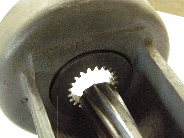

Ron Patterson
Re: Reaming Transmission bushings
Post by Ron Patterson » Wed Dec 29, 2021 10:11 am
Dave
You might want to consider finding someone who has a Dearborn Model T ford transmission drum bushing reamer. and know how to use it.
The benefit is the drums are indexed to the newly installed gear pitch circle to ream the new bushings. And if you think about what is going on insdie the transmission that way makes more sense than indexing to any other surface.

Ron Patterson
Post by Ron Patterson » Sun Jan 02, 2022 4:38 pm
NV Bob
Indexed to what??
Ron Patterson

I think the idea of the reaming fixture is to ensure the bore is concentric (indexed) with the pitch circle of the gear teeth and parallel to the gear axis. Neat idea plus it holds the drum assembly secure while reaming. Although quality machining will achieve this and all surfaces will run true and straight. Dave’s parts will be spot on. If it was me, and it was a couple of times, I would rather bore them in a lathe. That way everything can be checked for runout. Especially if a person was using old worn gears.

Ron Patterson
Post by Ron Patterson » Mon Jan 03, 2022 10:22 am
Until someone shows me the fixture for reaming OR boring the new drum bushings on a lathe while indexing the cutting tools to the gear pitch circle I am not convinced.
Can someone show me this fixture?
Ron Patterson
Ron Patterson
Very accurate 3 jaw chuck. .001 max indicated run out. All gear teeth are multiple of 3's. Remove burs from gear teeth. No fixture necessary.

I wonder how Ford did it in the factory? Anyone know? besides quickly.
New assemblies should he made quite concentric. Literally, if the bushings were made correctly you should be able to indicate the face of the drum hub that is machined and the outside diameter of the drum then check the bore to be sure. Bushings of any quality should be finished on the OD and ID at the same time when manufactured. Provided the bore in the gear is round. There’s a lot of factors in that transmission that can have run out. I would imagine a couple thousands wouldn’t matter a whole bunch. All being said, if I had to choose between two, a little run out in the gear or the outside diameter of a new drum I would lean towards having the drum run true. That would affect balance the most I would say.
I suppose if a person wanted to indicate to the pitch circle of the gear it could be indicated over pins of the correct size laid into the teeth of the gear.

Posts: 4399
Post by Jerry VanOoteghem » Mon Jan 03, 2022 7:21 pm
Dave
You might want to consider finding someone who has a Dearborn Model T ford transmission drum bushing reamer. and know how to use it.DSCN2006.JPG The benefit is the drums are indexed to the newly installed gear pitch circle to ream the new bushings. And if you think about what is going on insdie the transmission that way makes more sense than indexing to any other surface.
Ron Patterson
Ron,
That's a wonderful looking fixture. I must say however, that in manufacturing, it's very poor practice to modify/correct the location of a bore with a reamer. Reamers are notorious for following the bore they are enlarging. How well is the reamer supported by the fixture? How close a fit is the reamer shank to the fixture? Not trying to be contrary. Wish I had one of those!

Scott_Conger wrote:
Mon Jan 03, 2022 8:32 pm
Jerry
this will answer all of your questions: http://www.mtfca.com/discus/messages/17 ... 1325030711
It did!!
Yup, that's a great fixture and those reamers should indeed recenter the bore. Not your garden variety reamers to be sure!
