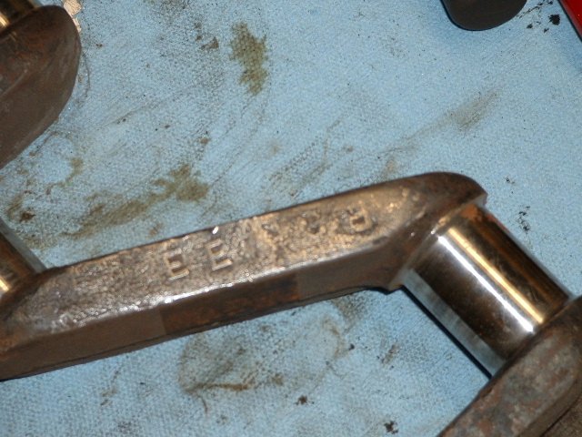

Does the designation EE on crankshafts indicate there is no chrome in them?

Re: Ford Metalurgical Standards
I see the chart says no chrome.
Is that what EE means on an EE crank?
Doesn't directly mean that it does not contain chromium. It means that it's manufactured from "EE" grade steel, which incidentally contains no chromium.KWTownsend wrote: ↑Thu Jan 06, 2022 3:34 pmI see the chart says no chrome.
