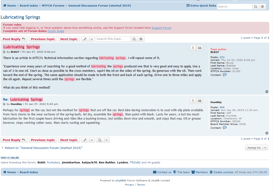

Lubricating Springs
There is an article in MTFCI's Technical Information section regarding lubricating springs. I will repeat some of it.
"Experience over many years of searching for a good method of lubricating the springs produced one that is very good and easy to apply. Use a can of 3-in-one oil. Start as close as possible to the cross members, squirt the oil on the sides of the spring. Be generous with the oil. Then work toward the end of the spring. The same application should be made to both the front and back of each spring. Drive one to three miles and apply the oil again. Repeat several times until the springs are flexible."
What do you think of this method?

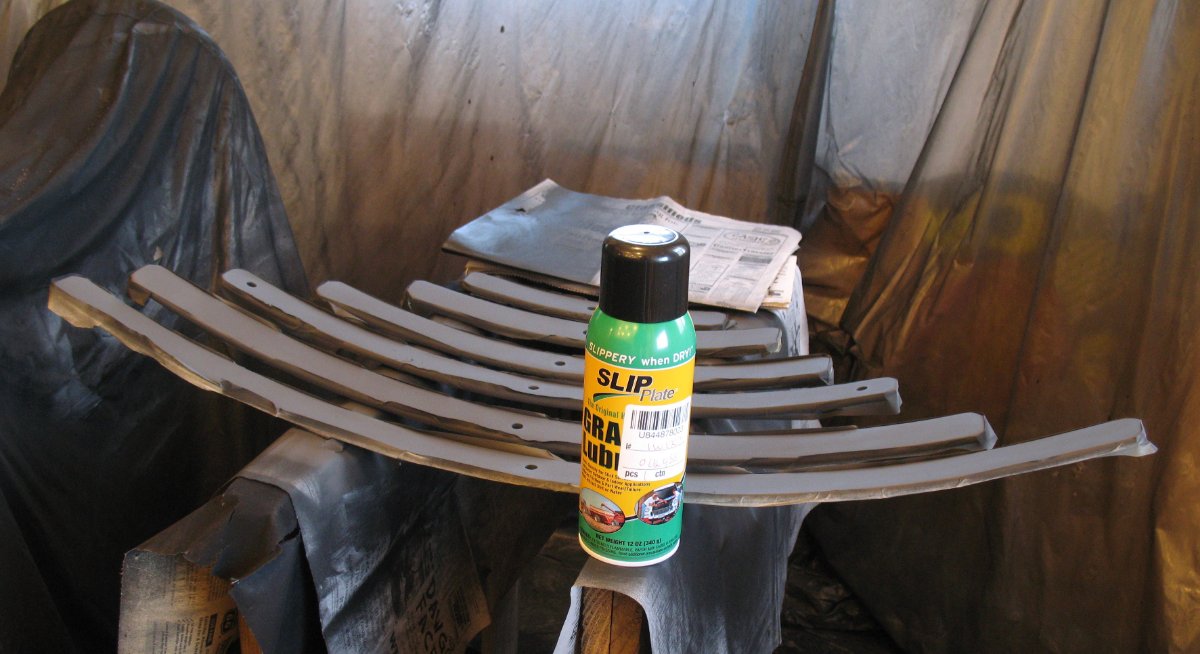

Perhaps for springs on the car, but not the method for springs that are off the car and taken apart. Best lube during restoration is to coat with slip plate available from farm stores to the wear surfaces of the spring leafs, let dry, assemble the springs, then paint with black. Lasts for years. A bit too much lubrication for the first couple hours driving and rides like a bucking bronco at first, but settles down nice and smooth, and stays that way. Oil or grease however, stops working rather soon, then starts rusting and squeeking.

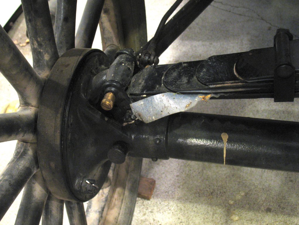

Reading on the forum about UHMW tape I thought it sounded wonderful, and used it.
This was the disappointing result.
For the next spring I assembled I used Slip Plate graphite. No problems so far.

I have been using Mckay spray graphite on leaf undersides. It goes on like a flat spray paint. Its very dark grey to black. Build up several coats.
When spring is reassembled, a quick coat of semi gloss black finishes the job.
