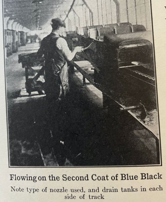

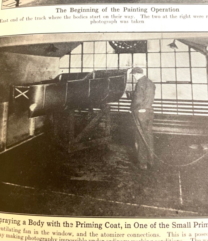

To add to Trent's reply, there is multiple pages in The Ford Methods and the Ford Shops, 1914-1915 with illustrations to show the early process of the 'color varnish'.
One of the first steps was a spray coat, yes spray from a gun noted as 80 psi, not withstanding the typical Google info that DeVilbiss invented the spray gun in the 20's, pneumatic paint guns were much earlier. The prime coat was allowed to dry, then sanded, then the body was back on the track.
The bodies were placed on conveyor and ran at speed of 25 feet per minute. When on the track a 2nd blue-black priming coat was placed using gravity flow guns, drip pans returned the varnish to the the gravity fed system, so that 2 gallons of liquid paint is flowed on, about 200 feet of track needed per body, it was found that 1 gallon was needed to cover 11 bodies with the gravity flow paint method. After 200 feet the body was dry enough to be pulled off and stacked for 24 hours. Then the body goes back on a cross track and gets on the 'color varnish' line, for the distance of 200 feet, pulled and stacked and 'mossed' by hand, the given a 2nd color varnish coat as before and stacked and dried, ready for upholstery.
Lastly the bodies were hand pumiced with water ( the very blurry left side of the photo shows the workers on both sides of bodies on the line) to brighten the gloss of the color varnish.

The statement below is from the MTFCA encyclopedia, I hate to be part of the problem with regard to posting hearsay Google garbage, like Ford made car floors from screw boxes. The original poster referenced early cars, were is the correct info for paint process for pre 14 cars. Is this a case of semantics , primer was spayed but paint (color varnish) was flowed on, all reference looks to be black era cars.
I will edit my prior replies as to not perpetuate incorrect information , statement below if not correct should be edited on MTFCA encyclopedia.
Application of the Paints Spray guns for the application paint were not developed until the early 1920s. Credit for their development belongs largely to the De Vilbiss Company. Prior to that time Model T parts were painted using brushing, dipping or flowing methods.
- Posts: 5497
Re: Early Brush Painting?
Depends on if the information came from Ford factory letters or internal memos. There are other ways to move paint besides the De Vilbiss Company type paint gun, siphon feed would be one, like many of the air brushes.
A siphon feed spray gun works with compressed air. Although there are many sprayers on the market today, many professionals still use a version of the original siphon feed gun developed by Joe Binks for the 1896 Chicago World Fair.

Hi Mark,Mark Gregush wrote: ↑Mon Jan 17, 2022 10:26 amDepends on if the information came from Ford factory letters or internal memos. There are other ways to move paint besides the De Vilbiss Company type paint gun, siphon feed would be one, like many of the air brushes.
I mentioned syphon type 5 posts above, Dan stated "One of the first steps was a spray coat, yes spray from a gun noted as 80 psi"
I was saying that if the information I had posted early on was not correct I would remove it. Again the original poster asked about method of painting on early cars and without stating a year was assumed to be pre 14. So, how did Ford cars get painted prior to 1914.

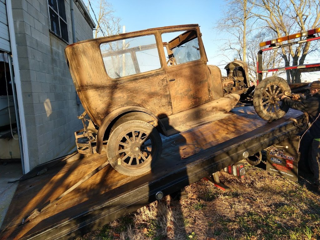

You are correct, Dean. My original question was vague enough to have prompted discussion of later painting processes in the Model T production era. But, I'm really interested in how the early (pre-14?) outsourced bodies were painted, bodies not necessarily manufactured in-house by Ford. There may have been a variety of application techniques: dipping, flowing, brushing, etc. Trent's research did not seem to uncover any specification from Ford to his body suppliers mandating a specific paint application method in those early years. I'm guessing there was none, but it's only a guess.
So, if I may, let me ask this. Have any owners or custodians of early original Model T's seen evidence of brushed-on original paint on their cars? If so, on what years and body styles?

I don't know if this helps or not. Here's my 27 Tudor the day I purchased it a year ago from a warehouse where it sat for decades. Birds christened it as well as mice vacationed in it. I think is shows the brush strokes from original painting. I'm not certain of this though.
John
John

Thanks for the photo, John, and for the article, Dan . . . both appreciated.
John, I can't tell from the photo if those are brush strokes or marks left from rubbing out paint applied using another method. Research would indicate a car built this late was painted using a flow technique. Were the finishes rubbed out after flow painting? I thought the whole point of flowing the paint was to delete the hand-rubbing requirement. My '17 Touring still has original Japan paint on the back of the front seat. It was obviously thinner at the top and thicker at the bottom when it dried and has worn accordingly.

Flow coating was common before spray, as covered in previous posts. There are examples to be seen in vintage movies online at YouTube of this being done.
For great information about brush painting, search on the internet “coach painting” and look in British sites. This is still practiced in the UK to restore old carriages, busses, trucks, and canal boats, because this is typical of their original construction. A very glossy and high quality finish is possible, using the correct paints and brush techniques and what they call flatting, which we call wet sanding and buffing. I was intrigued when I found some of these sites accidentally several years ago. It made me understand tge high quality results that could be obtained without expensive equipment.
