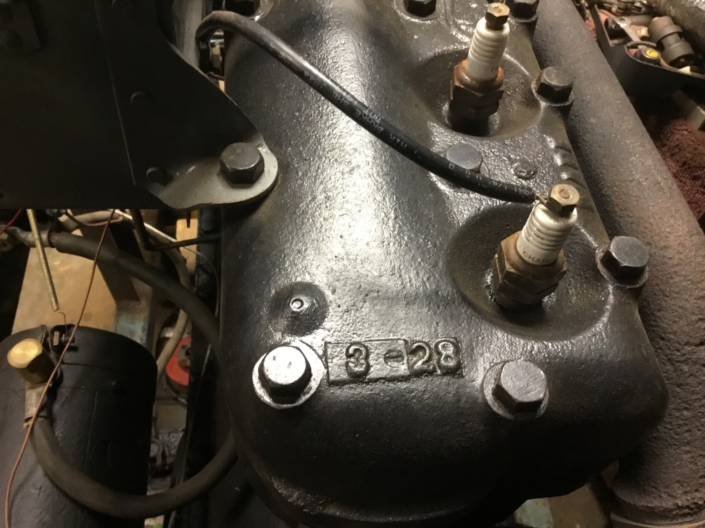

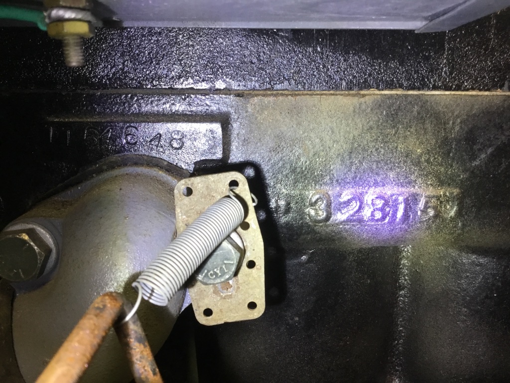

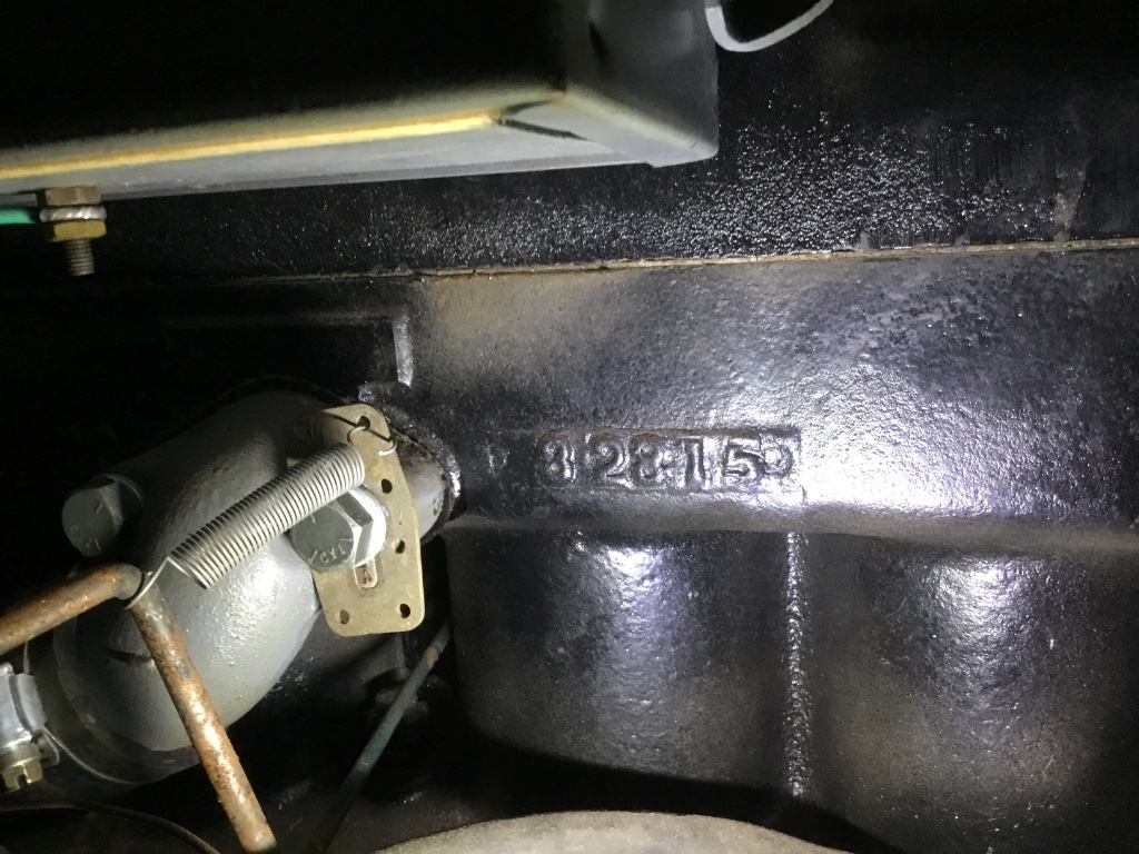

How common is it for a15 block and head to have same casting date?

Post by TRDxB2 » Wed Jan 19, 2022 3:51 pm
Happenstance or construed ?
I am not that knowledgeable about casting dates (too many variations in pictures) but the head casting month seams to have a slotted screw holding the month portion in place and is not a dash. Was this done?
The casting number on the block may have an additional number after the 15 but the engine serial number is in the March (3rd month) 1916 range.

Re: Matching dates common?
Post by BobShirleyAtlantaTx » Wed Jan 19, 2022 4:22 pm
In real life, the last part of the date looks like where they secured the date tag in the molding process. And yes the date in the head looks to have been secured by a slotted screw. And then that brings up the question why is the casting of the screw not reversed? With the slot not sticking up instead of looking like a screw slot
Post by Kerry » Wed Jan 19, 2022 4:33 pm
Ford didn't make a new mold every day just to change the date, they changed per day by screwing the numbered plates on.
Post by Wayne Sheldon » Wed Jan 19, 2022 5:08 pm
Interesting. I had not looked closely at the serial number pad before. But there is another anomaly. As production neared the one million mark, Ford enlarged the serial number pad for the blocks on the patterns and/or molds. The earliest I have noticed the larger pads is around the Fall of1915. The smaller number pads continued to show up as Ford continued to use the already made patterns and molds with the smaller pads already in place. I have seen smaller number pads well into January of 1916.
This block has the larger number pad common for 1916. I could be wrong? But I do not think a March of 1915 block should have that size number pad. Do not ask me how or who, but I do know for a fact that it is not difficult to convert a 6 into a 5.
As for the casting dates themselves? These are typical. Molds and/or patterns had places for date numbers to be attached before the iron was poured. Several variations of attachment were used, among the most common was slotted screws. The slotted screw can show up as either a positive or a negative depending upon where in the process it was changed. The level of the numbers often varies.
Post by BobShirleyAtlantaTx » Wed Jan 19, 2022 6:55 pm
You guys are right as rain. The serial number is a March 1916 not 15 I guess at some point in the past someone tried pull one over. I sure stand corrected. That’s the reason the 5 look’s funky.
Post by kmatt2 » Wed Jan 19, 2022 11:01 pm
I would not worry about the 15 casting date and the 16 engine number. The longer number boss blocks were cast at the same time as the older shorter number boss blocks were in 1915. As the molds wore out they were replaced with longer boss molds. The shorter boss blocks would have been used up first while the numbers were under 1M by stacking the long boss blocks in bottom of the stacks ready to go to machining. I don’t think your 5 is a changed 6 in this case because the engine number would have also been changed to a 15 number. One case I can think of is a Ford dealer had a 1915 unnumbered new replacement short block in stock for a while and a customer with a 1916 T needed a replacement for a damaged block and the 1916 engine number of that damaged block was stamped on the unnumbered short block in that car.

TXGOAT, FWIW, Most of the wires I have seen inside cast blocks or heads were remnants of the wire used to hold the inner sand molds together long enough to complete the pour. Most of those wire pieces were pulled out as part of the cleaning of the block or head before major machining.
Sometimes part of the wires would be exposed on the edges of the sand, and weld into the casting when the molten iron was poured in. They would pull out as much as they could in a minute or less, then leave the rest as long as it was not enough to fail QC.
Derek K, FWIW, In past discussions (must have been about fifty of them in the past twenty years? Just try to find the right two or three of them?) ( I am joking!), people that know a lot more than I do quoted information from back in the day that the numbers as pictured on the head in question were in fact month and day casting dates. And, yes, some heads (apparently mostly 1913 and a few 1912 (from memory)) did have the year following the month and day numbers. This was mostly done during the mid and late brass years. Casting dates as I recall were not on all earlier heads, and were often near the middle of the head instead of the rear.
Later heads, the high heads, rarely had casting dates on them for USA production. As I recall, some Canadian heads into the 1920s had the circle design casting dates..
Many heads also did have mold or pattern numbers or letters. I am not aware of any consistency in location or meanings.
I cannot say I know all of that for absolute certainty. But that is my firm belief.

About the remark about the screwhead not being cast in the "negative" : the small plate is screwed on the wood 'plug' or 'core' (officially called the 'pattern' ) and not on the sand mold, so will end up in the finished casting just the way it looks on the plug, chewed up slot and all.
