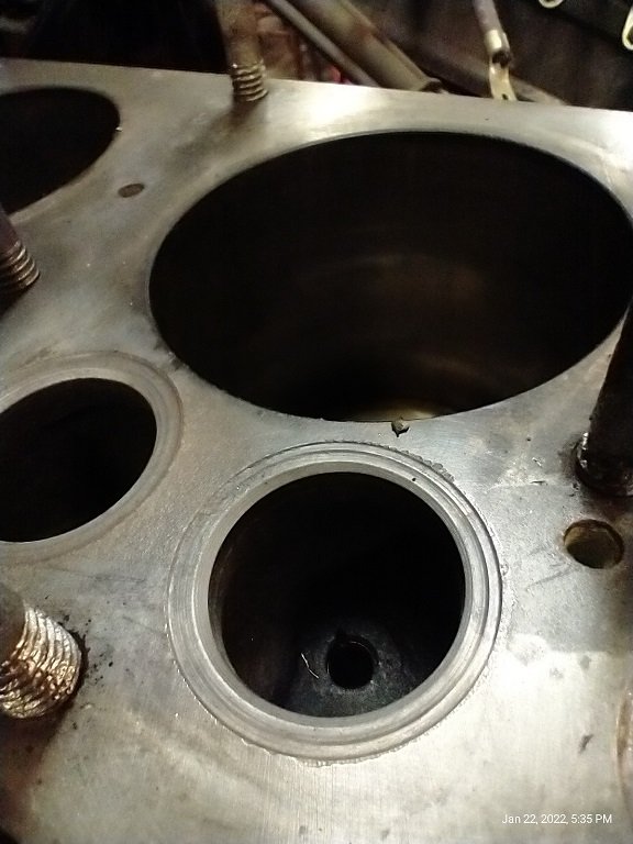

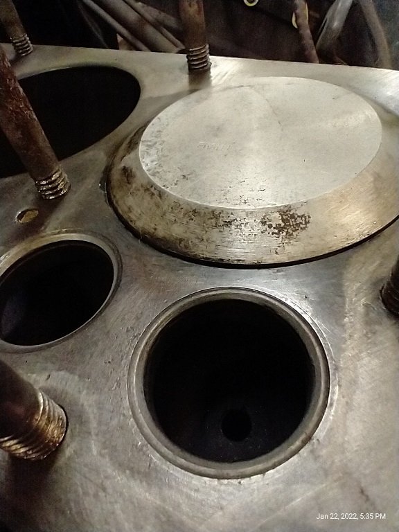

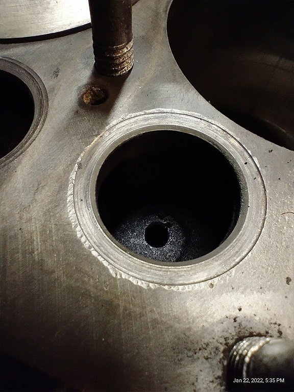

Identifying replacement valve seat inserts
Is it pretty obvious when your T has had seat inserts installed? Below are a few pictures of my valve seats. Seems to be an excessive amount of concentric circles around most of the valves. Are these inserts? If so, are all inserts hardened?
- Posts: 4849
Re: Identifying replacement valve seat inserts
Interesting variety of sizes used. If memory serves, there are or were 3 harnesses. 1) cast iron. (soft.) 2) hardened. Normal for unleaded fuels & 3) real hard (for propane)
Yes Ryan, those are aftermarket inserts of some kind. The valves in both my 1924 and 1925 engines have seats machined directly into the cast iron of the block.
