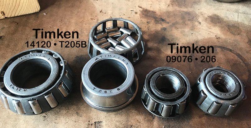

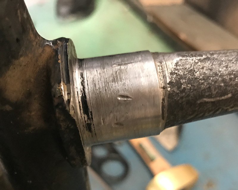

With the help of a friend I was able to pull the front wheels off my 1917 Touring today. I was pleased to discover that somewhere in the past the ball bearings had been replaced with roller bearings although I was surprised by the different appearance of the two outers (see first photo). The left wheel was reluctant to come off after the outer was removed and when it did the inner bearing came apart and scattered rollers all over the place. There were some tiny burrs on the spindle that were jamming the bearing. I carefully filed the burrs on the spindle and now the other inner slides on and off easily (photo 2). I don't believe the spindle needs to replaced but would appreciate hearing from others.
The races look OK so I think I can get by with a new inner bearing unless there is a reason to replace one of the dissimilar outers.
Other than that, the right kingpin bushings are worn so it looks like I should probably replace both the right and left just to be sure. If I have to take the axle off to take it to where it can be repaired (I don't have a Steven's tool) I was thinking of just unbolting the springs from the frame and taking the whole thing. Anyone have a better idea? My assumption is that if I removed the springs from the shackles on the axle it might be hard to get them back in. Then again, if I decide to replace the shackle bushings they'd have to come off anyway :-)

It looks to me that someone used the old technique to increase the spindle size so the bearing would be snug. The is a popular technique applied to the crankshaft pulley when it is loose. Some take a punch and dent the shaft which raises the surface. I would not think this is a good idea for a front spindle bearing. But what do I know?

"Raspberrying" involves pricking the surface with a hammer and punch to create rough surface, like a raspberry, in order to eliminate slop. It's an old trick that has been used to solve a wide variety of problems.
Unless someone filed flats on the spindle, it is not from 1917. The two flats easy removal of the ball bearing race or the roller bearing from the spindle by tapping them in the back with a drift and hammer.

We call it "strawberrying" over here ! Somewhere I have a photo of the front of a crankshaft that came into the shop because of a "rod knock" - nope just a loose front fan drive pulley BUT the front of the crank musta had a 100 prick punches !

I would not recommend using the old outer races. It is best to replace with new bearing and race. The outer race may look good, but the wear on it may not match the angle of the new bearing.

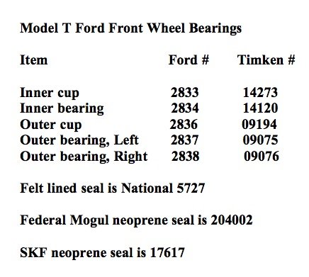

If you need to replace anything, these are the numbers:
Bearings, Front Wheel.jpg (37.13 KiB) Viewed 11742 times

OK - One of the guesses we made about the marks on the spindle was to tighten up the bearing so you're probably right. Question - how tight is the inner bearing supposed to ride on the spindle? If it turns easily (the whole bearing) should it be tightened and is there a way to do that short of replacing the spindle?
Also - I repeat the question.... do you think I need to replace the funny looking outer bearing?
John - if I keep the outer bearings I suspect it would be fine to keep the outer races if they look good.

Tim, the "funny race" is actually just what's called the cage that's different. It just holds it all together and really doesn't do anything else.
Clean them all good and blow dry (don't spin with air)...then put them against the mating race and turn and feel. If smooth they should be fine. And you should see no pits in the rollers or races.
And no, the whole bearing should not spin on the spindle. I would redo the "raspberrys" and make it a snug/slip fit.

Just use the bearing in the same race it ran on. As long as you keep the bearings matched you will be good.

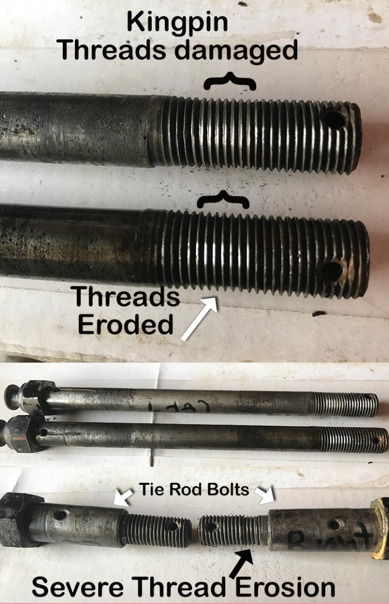

I got most of the axle apart today and decided that I need to replace the kingpins as well as the bushings and also the tie-rod bolts. The threads on the kingpins as well as the tie-rod bolts show some damage which is unfortunate inasmuch as I understand those with "manhole cover" oilers are a prized item. I've attached a photo to show you what I found.

The saga continues... I received my new 14120 bearing today. It fits snugly on the spindles so the looseness I reported must have been due to wear on the old bearings. I also noticed that the old 14120 had only 14 rollers compared to 17 on the new so I'm going to get another inner and keep the old one as a spare.

Check your front axle kingpin threads. You may need to helicoil them,
Better yet find someone with a Stevens front axle tool and set it up correctly.

I’m taking the axle to a guy with the tools and experience to use them. I believe in doing things right the first time. A friend is getting his axle done at the same time so it’ll be a social event of sorts...We have the helicoils if needed along with new kingpins, tie rod bolts and bushings, etc. I’m looking forward to observing the process and adding to my store of knowledge...for me that is a big part of the fun of owning a Model T😁
