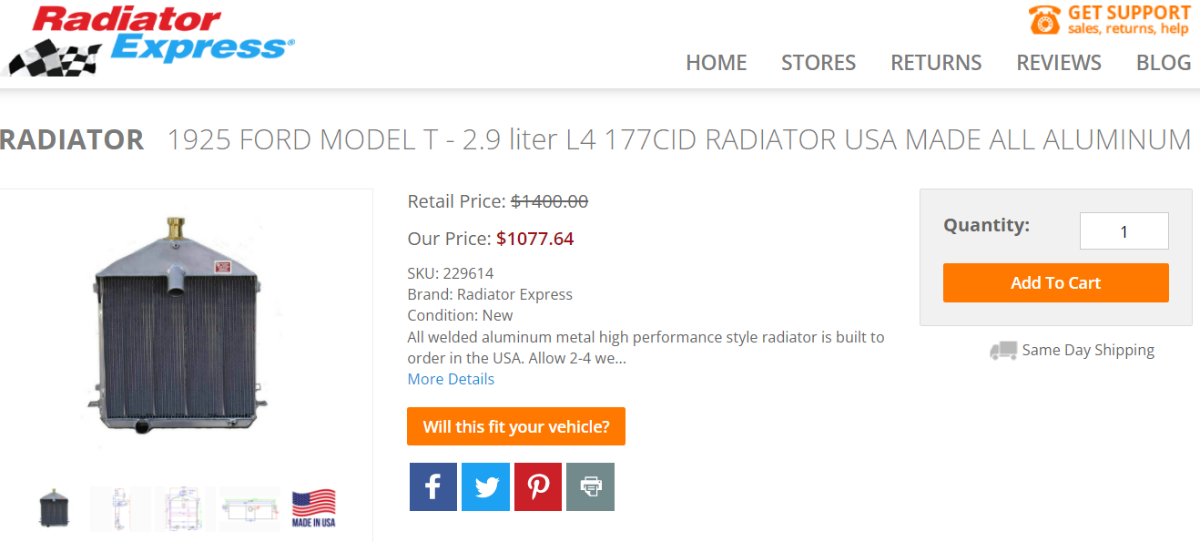

Not the early radiators, but apparently, Radiator Express makes a version of the "black radiator" style. From what I can see, they look terrible and are expensive. Interesting though!
https://www.radiatorexpress.com/product ... 14/1485417

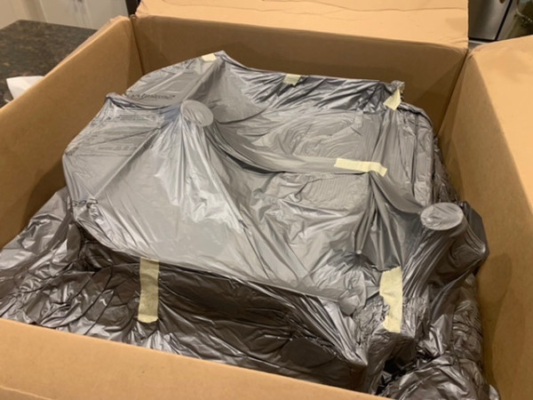

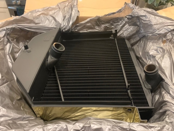

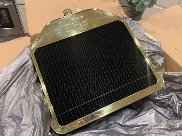

Post by greenacres36 » Mon Feb 07, 2022 2:59 pm
I bought a Brassworks round tube for my 15 runabout last year. No cooing problems at all even during break in. Heck it even survived falling off of the turtle deck. I hadn’t even put it on the car yet. Of cars on the way down it fell out of the box and landed face first on a floor jack. My heart dropped, I said some bad words but it came out without a scratch somehow. I would like to say lesson learned. But it survived the shock test.
