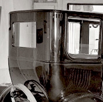

window shades 1925.jpg (51.28 KiB) Viewed 1746 times

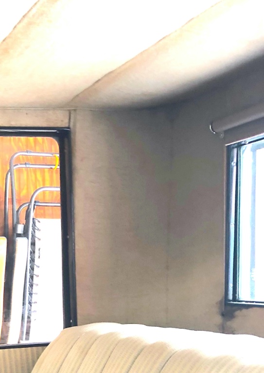

'25 Coupe used to own had non-stock tan upholstery, but no shade, so ordered a new tan shade and brackets, measured the distance across the rear window and mounted new brackets into the wood frame. Mount the roller shade so that it pulls down against the window, under roll, you don't want it to pull over the front of the roll.
