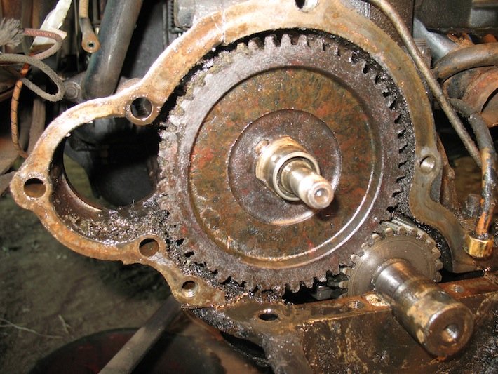

I now see the timer arm is not turning, I pulled out the motor and make a revision
what can that be...
not good i think..
what can that be...
not good i think..

Re: Electric problem
I think you'll find the timing gear has let go.
No need to pull engine to fix.

I think als it has something to do with the timing gear, but why that happen if it is so
do you have any idea?
If I look through the oilfill cap and turn the crank I see a gear turning
Bert
Bert
Well, if you see the gear turning, maybe just the timer roller is loose ?
You can turn it over 2 revolutions and check all the teeth on the gear. Fiber timing gears can peal off a few teeth in one spot, but usually don't turn after that.
Or the key is broken and the gear turns and the cam is not...

at the end I earth every coil (what the timer normaly does) and they work all proparly, so the coils are oke
the reason why only one coil was working is that the timer doesnt turn
now I saw that the gear was turning through the oil fill cap i hope that it is only some connection between the timer shaft and the timer....
does any one has some picktures of that or illustrations in that aerea
because it is late now (1.30 in the night) its better to go sleep now and see tomorrow further
I will come back tomorrow

Had that happen once and found that pin that turns the roller in the timer had fallen out of the cam hole so the roller would not turn ,made it fire on one coil only

If the timer doesn't turn, I wonder...
But if the gear is OK, perhaps the pin has fallen out of the timer as David suggested.

at the end I found the problem, the 2 pins were out of the valve shaft, I have this fiber gear in the car, the theets looks good but I think the center is a bit to fat so the centre bold doesnt pusch the pins down and regarding the lenght of the pins the can come out without losing the center bold.
I think thats happend.
I can see they were a time out of there position, and I found the motor also a bit weak, afterwarts because of the wrong timing of the valves, I sugested.
Toon Boer suggested also, it is the best to change this gear because of the bad experiance of fiber gears, in combination with a dynamo.
so I will do that
thanks all for all the nice input,
Bert
so I will do that
Bert

that's is a surprising finding! Those pins are not supposed to be loose at all. You may wish to consider using a retaining loctite compound to reset them into the cam shaft to ensure this never happens again.
