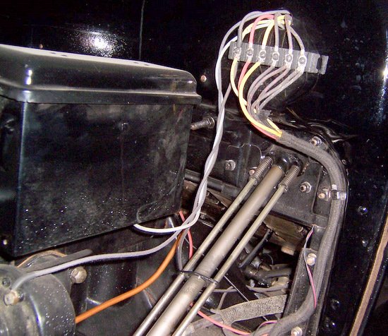

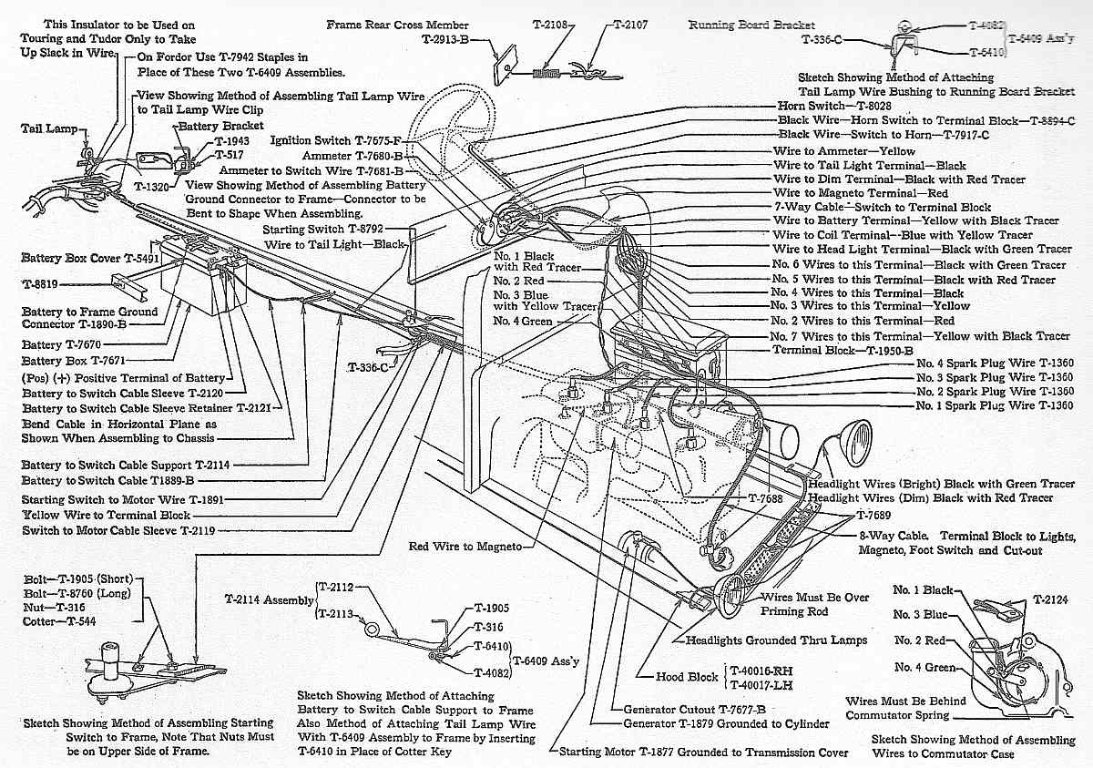

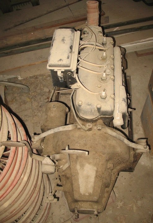

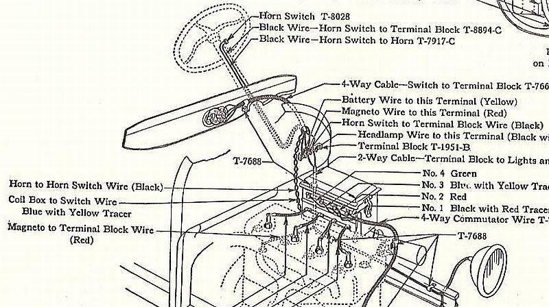

I am looking for a couple photos of a '26-7 firewall with the Wiring & retainers in place. I also would like a photo of the retainers for the timer harness near/at the water outlet on the cylinder head. George

Here you go - check the links for additional photo's

There is lots of photos in the revised edition of the Ford Service book in the improved section.

Frank & Larry, I did not bring down a copy of the Ford Service Manual with me when we left for Florida, my friend in NY is working on his"27 RPU, so I am trying to help him "Remote Control. Frank what you sent should get the job done. So, thank you Gents. George
