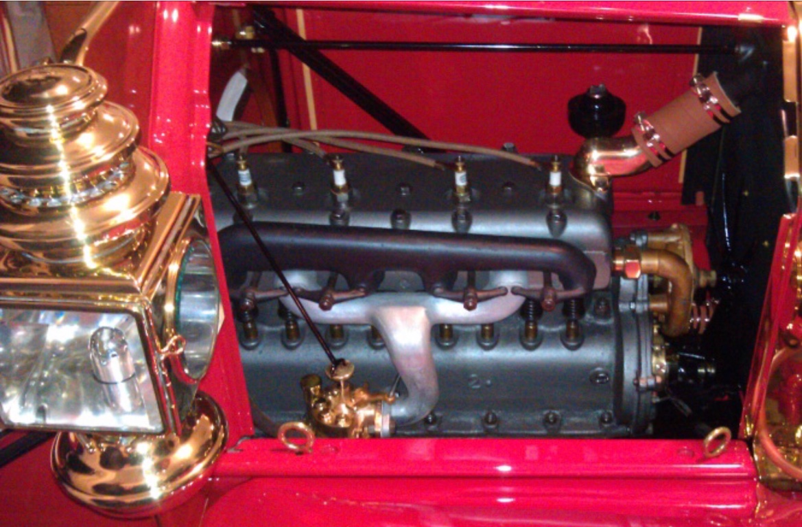

I’d really like more pictures of the motor as after a long conversation with Charlie Shaffer (RIP) I know what he did to convert a 1914 motor into an early (lower than 1000) look a like. He did most of the changes in lead and with a small pocket knife, you can determine the real provenience in a matter of minutes.
Tony Bowker

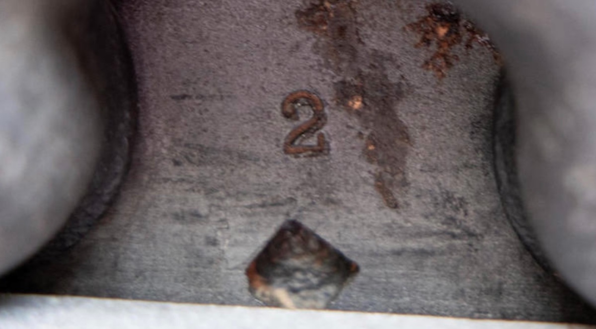

This is right where the serial number would be for one made in 1908.

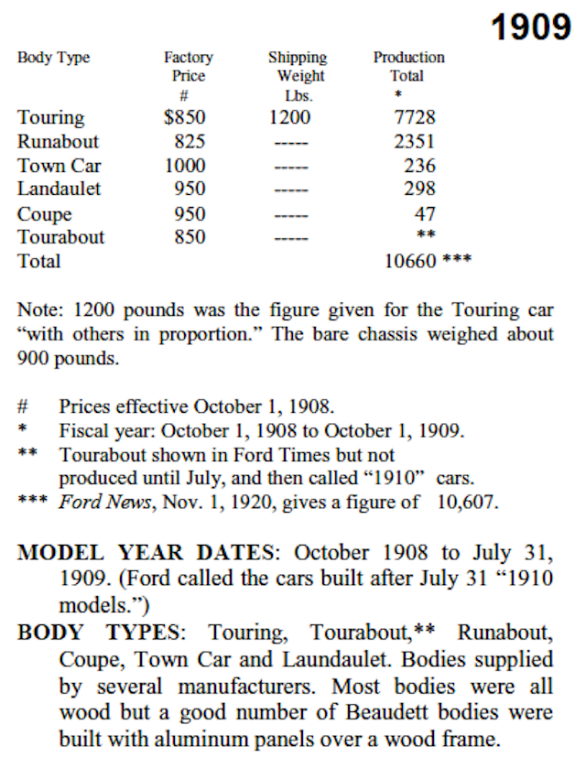

Bruce begins the Encyclopedia with 1909, not 1908, for a reason.
Ford designated cars not by calendar year, but by model year, which usually (but not always) began August 1, coinciding with the "fiscal year". The practice continues today. If you buy a Ford manufactured next October, it will be a 2023 model, not 2022. According to Ford, the approximately 300 Model T cars made in 1908 are 1909 Fords.

Has anyone noticed..FWIW, the "serial number" 2 on the auction car is embossed, whereas #220 is STAMPED? Me thinks they woulda been stamped from the get-go but then who am I to say? As far as the engine goes, open it up and then you will know if its the real deal or not. As I understand there was a few internal changes in the blocks for strengthening purposes early on. Like I said earlier, yes it's a gorgeous car as it sits. Just how authentic it REALLY is, well, is any man's guess. It'll still pull in a hefty bid I think. I could be wrong.

I agree with the qualifier, "a 1909 Model T made in 1908". That clarifies things for those who are wondering.
This is one of those times when the model year and the fiscal year don't coincide completely, though they begin at the same time.

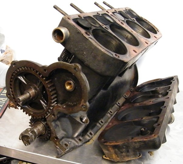

Tony B, to replicate a block in the pre 2500 from a 14 block in lead would be no more than a piece of art, functional I doubt very much

It appears that #2 and #220 both have had the manifold surfaces machined. The threaded plugs they used in the water jackets were never ground smooth at the factory. They used these plugs well into 1913. What I'm driving at is if the surface was ground, how could the 2 and the 220 be so clear?
