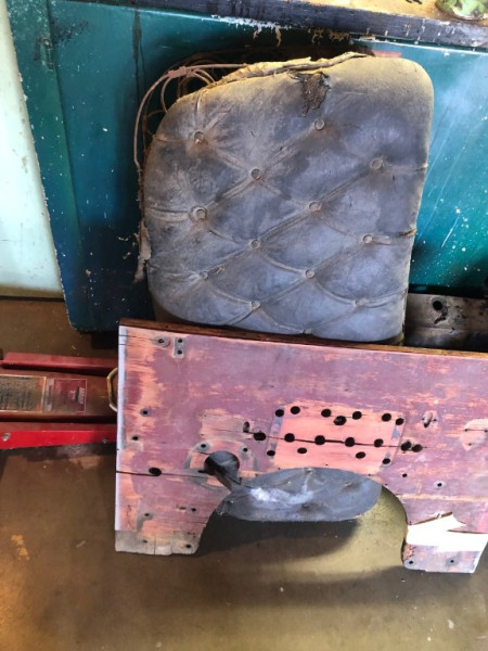

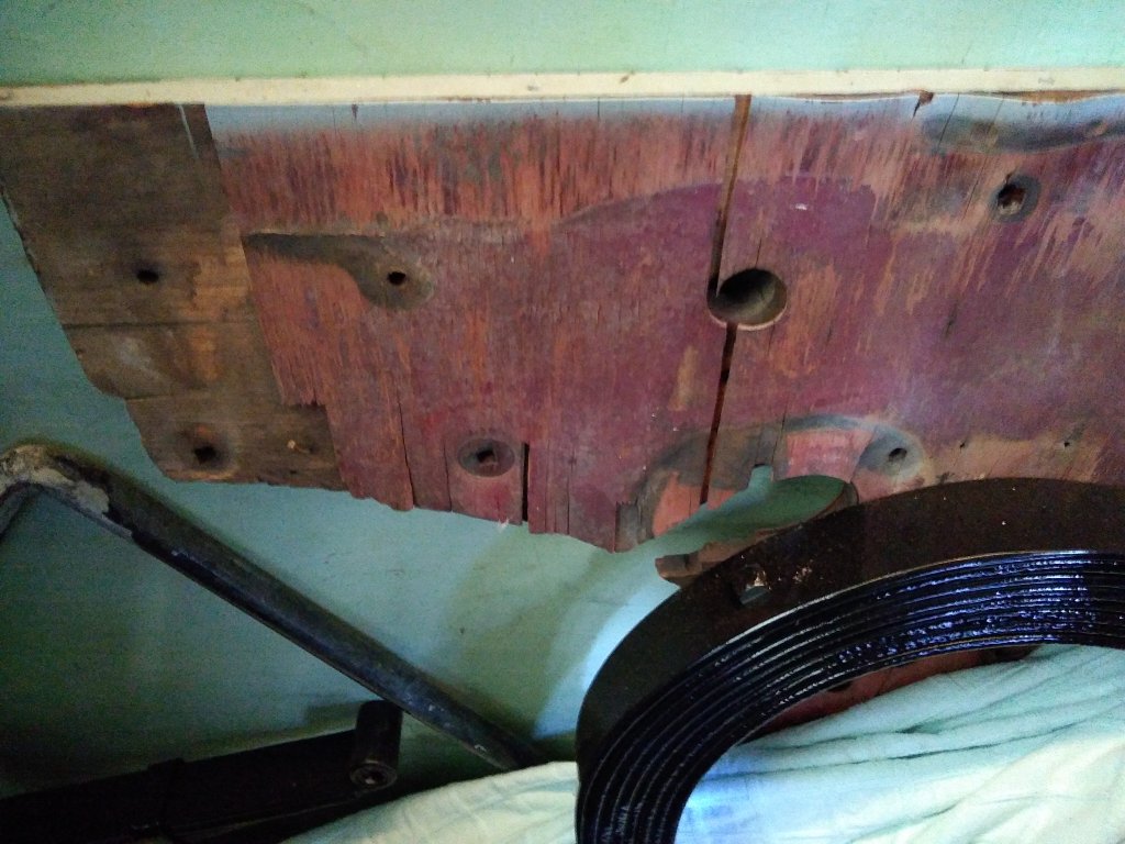

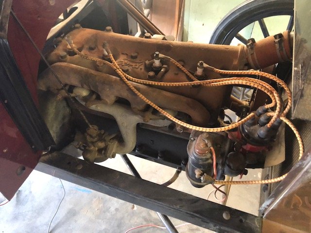

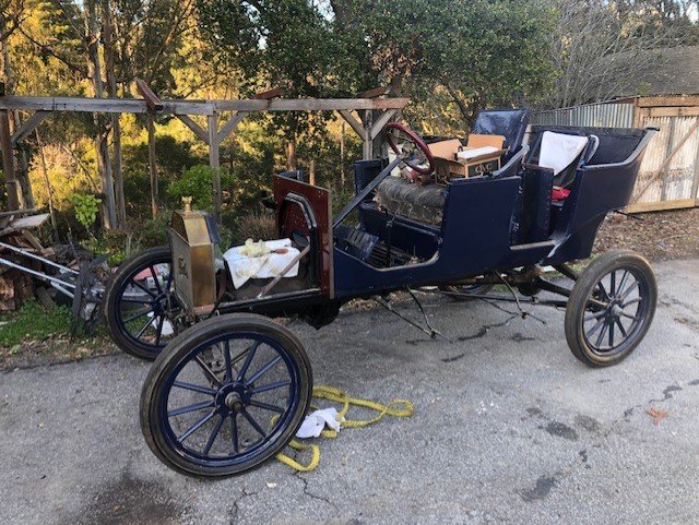

Hi Everyone. I'm trying to do a reasonably authentic restoration on my new 1912 touring. Serial is around 130000. It's a June car and a better than average original. It came from Colorado and I am the third owner.
1) The car came with a "Dodge Brothers Mfg" steering spider in steel. The acorn nut is also steel. All very nicely polished and painted black. I assume this is correct?

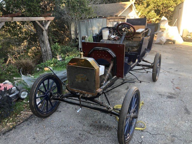

2) The original firewall under the coilbox is so red it looks like dull paint. One can almost see no grain in the wood?
What is the correct finish? It kind of looks gawd awful.
3) Were the knobs to hold the top on black steel? Solid or pressed sheet metal?
4). Were the hood shelves painted black?
5) The radiator appears to be a recored original. There is no Made In USA on the front. Likely correct?

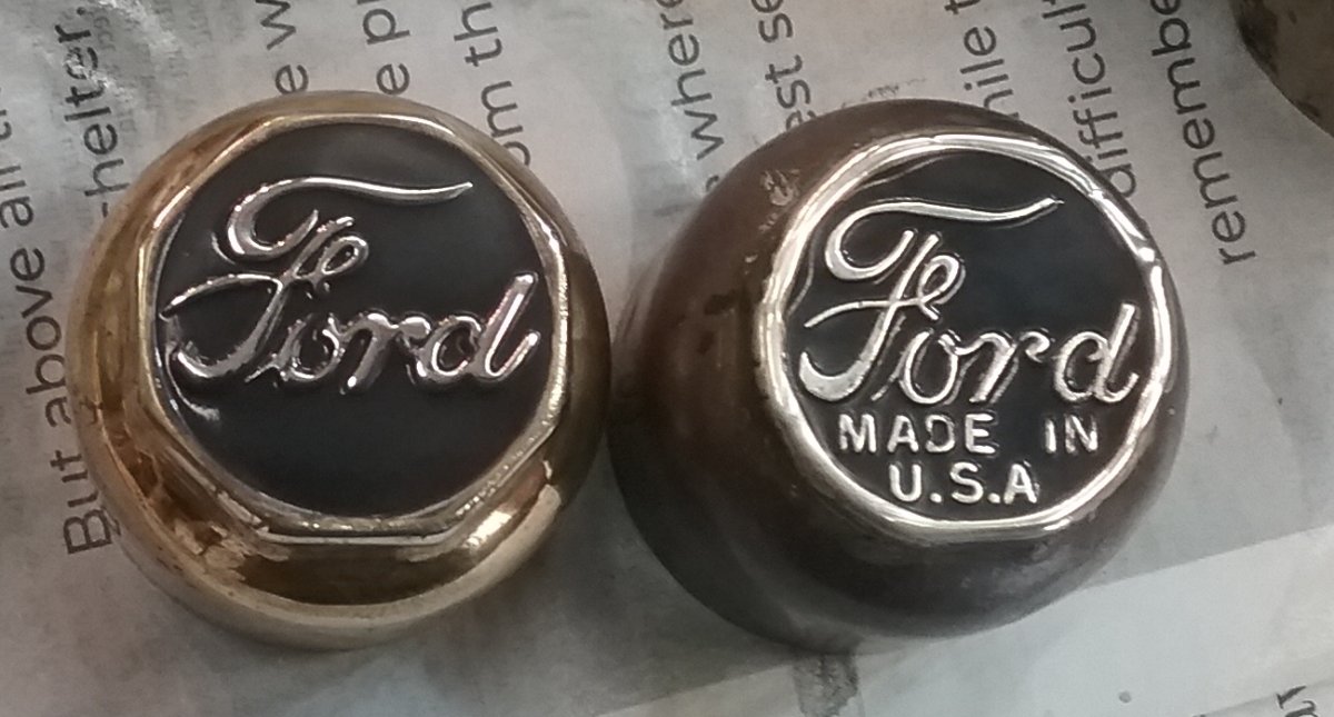

6). There were no original hubcaps as the wheels were changed. Were the hubcaps a tall F with no MADE IN USA? I have a nice set of original Tall F MADE IN USA caps that I collected for my 13. When did they change? Anyone got an all original car around that month?
7) The horn is a high quality reproduction1911 style. I think double twist Rubes. Correct within reason?
Really appreciate the help. I know that many different parts were used simultaneously at different assembly plants. Brian in Santa Cruz CA

Re: 1912 Authenticity Questions?
As I recall the spider should be brass. Both my former 12s were.
Hood shelves are black.
Hubcaps are tall F.
Radiator started having "Made in USA" early on for 12s, so yours certainly should being a June car, that is considered a late '12.
Firewalls were cherry stain. Various people use various brands to achieve what they like.
Hubcaps are tall F.
- Posts: 3743
- Last Name: Wrenn
Laurel Mountain Velley Forge seems to.l have what most consider to be as close to original as it gets. I used it on my 12 and 13 and it looks great.
Wow. Thanks. That's a great look. I will buy it. Thanks guys
So lucky to have what surely is original firewall. Hope you can keep it alive. And the stain behind the coil box sure looks like the Laurel Mountain cherry to me! Close enough for who it's for as they say!
Do you think I should try to salvage the original firewall? I do have the original brass trim and screws. I'm not so good with wood but I will give it a shot

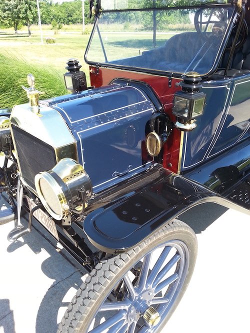

I just had a new '12 dash made by Jon Anderson.
Excellent job. He uses the original drawings so you get an exact repop. I plan on finishing it with the Laurel Forge cherry stain, as I did for my '14s.
I had all the wood in my 1912 "saved" by judicious use of a water-thin, penetrating epoxy (epoxy, not polyester). You might be able to adequately solidify the firewall from the edges, keeping the faces free to accept whatever stain you put to use, if you even bother to add stain. Try a good cleaning with TSP then rubbing with turpentine mixed with linseed oil on a small, obscure area. You may be able to bring back enough original finish to keep things original. If the above works, you can dissolve some shaved bees wax into the turpentine/linseed oil mix to make a French polish, bring out more good looks.
As for the rest, it doesn't matter. 1912 was a year of absolutely massive changes, you can put amost anything on the car and find an acceptable picture or sales brochure showing that part to be correct. There were three different coil boxes and coils used, the earliest cars have no front doors, later ones have seriously interesting fillers for the drivers side door, an opening front door on the passenger side, some cars had leather straps running from the front top bow to the base of the radiator to hold the top, later had short straps from front top irons to the windshield hinges, etc etc etc. Some cars had leather upholstery, some leatherette. There seems to have been little rhyme or reason to the changes, and definitely no standardisation. Whatever came out of the stock room got put on the car. My take on the situations is that in 1911 Mr. Ford decided to start building automobiles rather than horseless carriages, began in the 1912 model year, but ever thrifty, used up all the existing stock in the process. Beginning in 1913 things became much more standardised.
Some folks remove the front door and filler to make the cars look "older", I see these often. Very sad, really, because the after-thought fillers are much more interesting, found primarily only on 1912's with a very very few on late 11's or early 13's, and if you want an open front car then just buy a 1909-1911. Your "June" car should definitely have the filler and front door.
As you get into your 1912 you will find it to be one of the most fascinating years for Model T. Don't panic, and take all expert advice with a big grain of salt, including from me. Given the history of your car, I would go to great lengths to keep things as original as is humanly possible, and consistent with your plans for the car: will you be a driver, or a show-er?

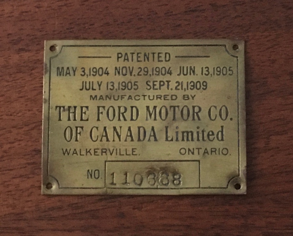

Top 'O the mornin' to ya!

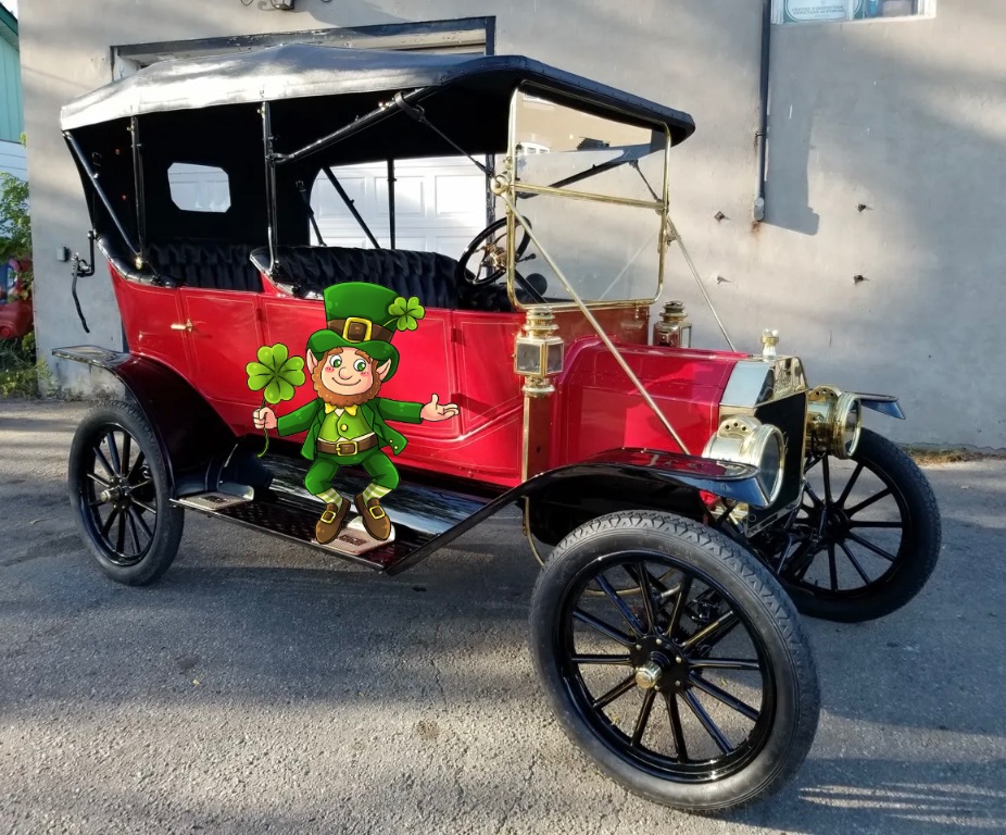

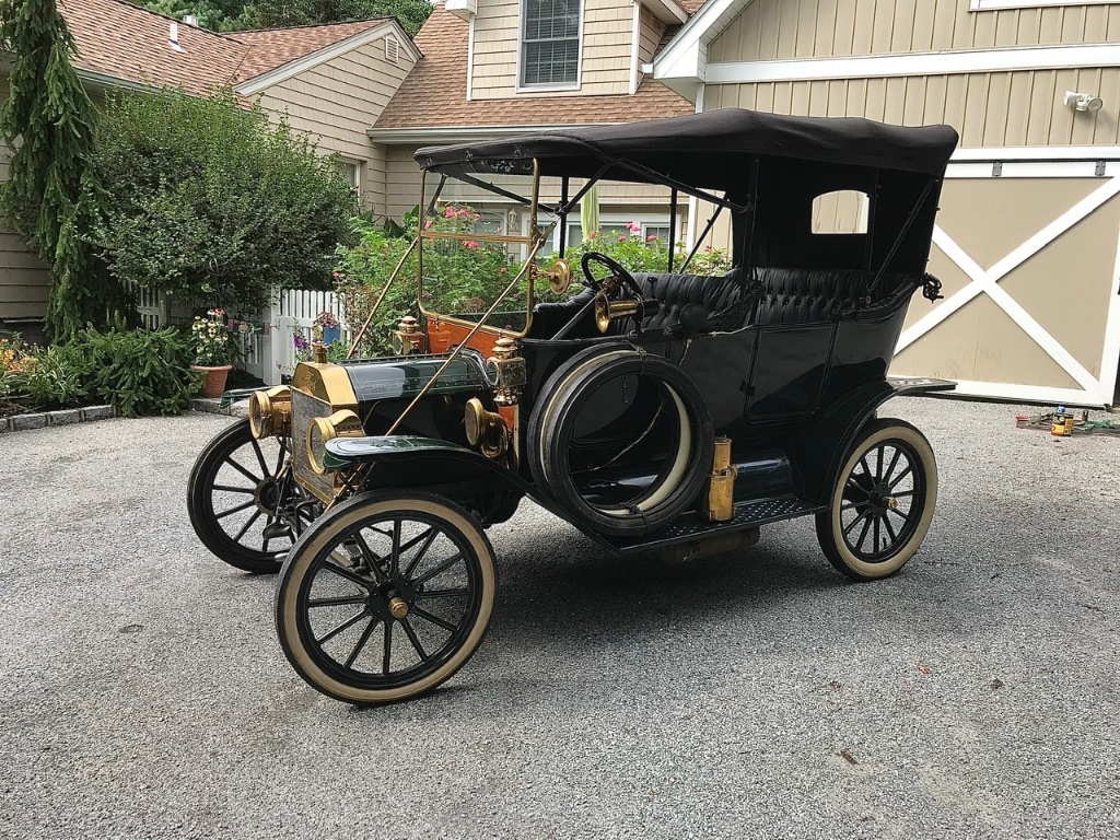

Perhaps a few of us can post pictures of our '12's to give you some ideas as to how you may want to finish your car.
Mine is done up as a good driver and not a show car. The color on my '12 is probably wrong for a touring, the tires should be smooth white ones and I put brass step plates on the running boards! Other than that it's pretty original. Leprechaun optional.
I believe my Canadian T is an April? build. The stamping isn't great on my dash plate but it matches my engine stamping. It reads 110338. Please note: my door handle should be vertical when locked. I had an August 1912 T touring and it didn't have outside door handles on the back.
Mine is original except for the prestolite bottle. Wrong color of course and whitewall tires but I like the look!

Brian, the hub on the left would be correct for 1912.
1913-14 on the right.

Anymore details available on that photo with HF in the 1912? Who, what, where occasion etc etc
Alan in Western Australia

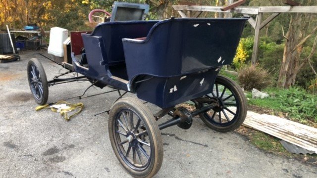

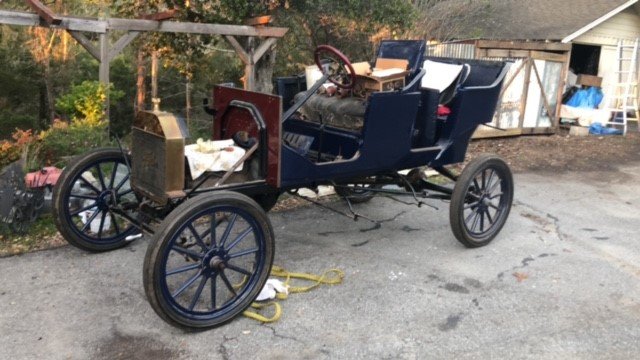

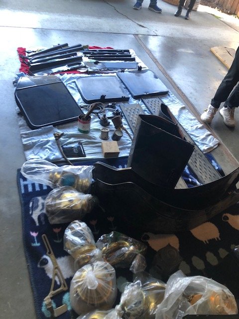

People have asked to see photos of my 12. Here they are. They stopped restoring the car in 1978. There was some paint adhesion problems with the Dulux Paint. I will repaint it a darker blue. It will be a driver, but I also want to do a reasonably correct job when I am at it. Brian
PS: I should note that the body is a Monroe. The serial numbers are stamped on the tops of the doors under the "wood garnish moldings". Also, the back half of the body was rebuilt as it was cut off. They found original Monroe doors for the rear including latches, hinges and one original outside door handle. The serial number on the front half is higher than that on the back half. Rear doors hinge at the front, but have door handles on the outside.

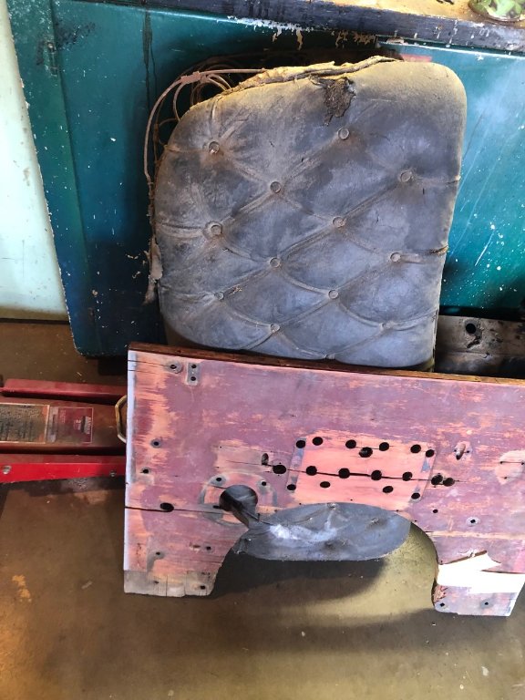

It looks like your original dash is drilled for right or left hand drive
- Posts: 6547

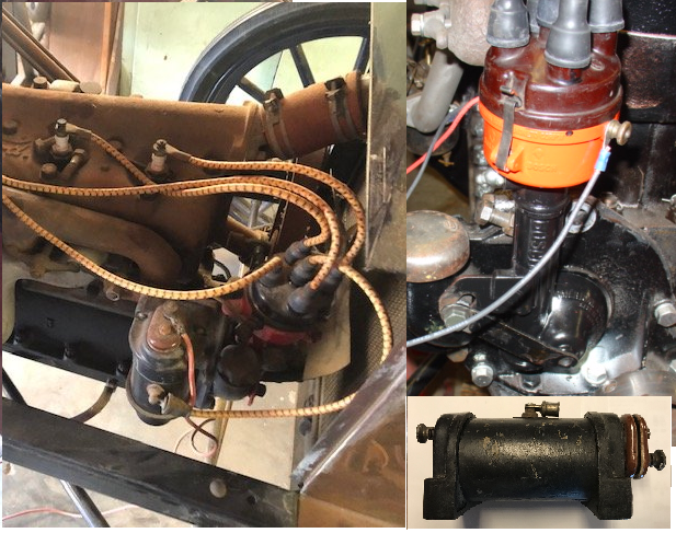

Pretty sure you have both an original AMERICAN BOSCH coil and distributor. American Bosch is not Today's Bosch (Robert Bosch), it was prior to WWI then the US Government seized it and never gave it back. Not sure what model distributor but some models had centrifugal advance. The tell is the color, the body was a burnt orange. VW Bosch, Texas T Bosch parts will not fit. The original can run on buzz coils as well. I have documentation on maintenance. Not sure when the various models were introduced but I think that yours while its period correct but not authentic to the year of the car. AND not authentic to the car. If you don't want it I'll buy it and the ignition coil or trade for some coils
I have removed the distributor. The car came with a very nice Heinz coil box. They rebuilt the original engine with a flywheel from a different car. I will charge the magnets and install it and the newly rewound 1912 coils that came with the car. I have some Bosch plates that I am using on some speedsters I'm building.
