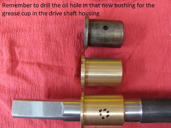

I cannot get grease through the driveshaft bushing, is it a hole straight through the bushing or is it a channel that delivers it to multiple locations?
Posts: 5495
Re: Driveshaft bushing
Post by RajoRacer » Thu Mar 17, 2022 6:39 pm
Depends if it was installed correctly & either an original or a correctly made repro but yes, there is a grease galley.
Posts: 6549
Post by TRDxB2 » Thu Mar 17, 2022 7:25 pm
I believe the process : The bushing is to be inserted with the oil groves aligned with the oil hole in the torque tube then the hole is drilled an then the busing is reamed & faced.

It appears that once again this guy installed something incorrectly, the bushing is 180degrees off.

It could have spun, too. The repro’s are sometimes a loose fit and need to be glued in.

If you decide to remove it be careful. More than one guy has sheared off rivets trying to drive it from the far end of the tube. You want to use a puller designed for the purpose.

I just removed & replaced the same bushing that was installed incorrectly - they drilled the hole but it was opposite the grease slot.
