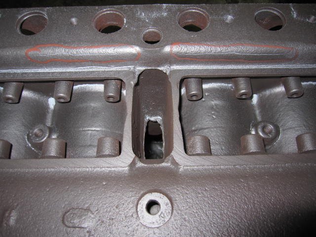

Post by dobro1956 » Wed Mar 30, 2022 8:49 am
As Joe mentioned, The 26-27 blocks are prone to having cracks between #2 and 3 cylinders. They are usually cracked in the top of the oil galley in the water jacket. Probably due to a change in cores or casting practice.

As with any engine over time wear and tear and rust take its toll on the block and iron parts.
We've seen the multitude of cracks on engine blocks/heads and Model T isn't void of those as all engines stress.
Dealing with something that is old and wasn't meant to last this long.
Common cracks are in center valve seats; due to overheating
Ones you've mentioned are caused by freezing and stress.
All of these cracks were repaired by us and engines are back on road.
