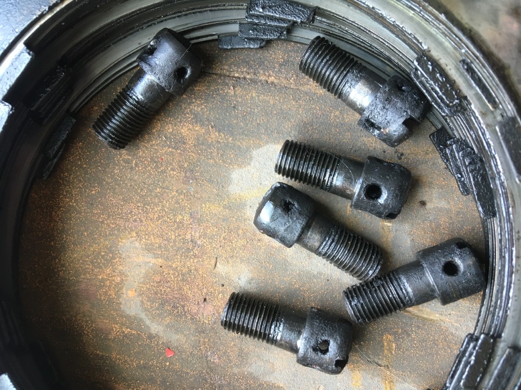

also my drive plate had this style holding it together. All the ones I have seen have bolt heads. Just an observation…
- Posts: 5164
Re: Transmission drum riveting
Early wide drum. 26. Not easy to get a good torque on.
Substituting drilled allen bolts is better than these screws IMHO.
