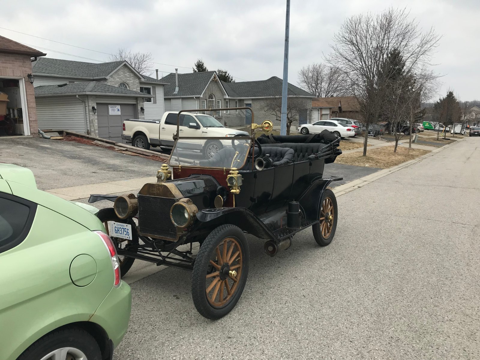

Identifying correct coil box for early 1913
Darren J Wallace
Topic author - Posts: 367
- First Name: Darren
- Last Name: Wallace
One thing I find fascinating, and fun with the ongoing repairs, restorations and upgrades, is trying to put my car back to as "period correct" as reasonably possible. My 1913 Canadian touring was built in September/October 1912. It has quite a few 1912 features. B-872 engine, steering column, front fenders, all lights, running boards, spring shackles are just some of the components Ford of Canada was using up when they built my car.
I'm now wondering about the coil box. Currently, it's a typical 1913-1914 metal box with the Canadian ID plate. The more I read, the more I think it should have had a wood coil box originally.
Would my car have originally had a wood coil box? If it should, I'm thinking that the KW replica the vendors sell would be the best choice. This way I can use my oxidized 6 screw metal top coils I currently run in it now.
I'm curious to what you guys think, and why it should, or should not be changed.
This car has been in my family since 1956, and no one in my family changed it. It was sold new, less than 10 miles from where we live. If it was changed, I wonder why it was changed, and the fact that it's technically a 1913 coil box, why so early into the car's life? The only thing that makes any sense to me was that the original wood coil box was one of the less common proprietary manufacturers that made their own coils. The box, and,or the coils started to fail, and the original owners opted for the improvement at an early period.
Or.... is it the fact that it's a Canadian car make all this stuff make sense?
What say you all?
What say you all?

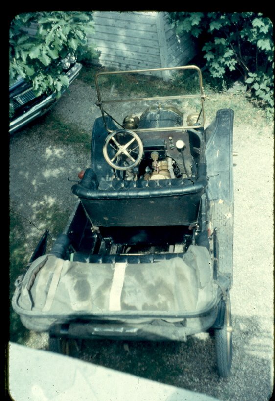

My car from 1929, the earliest known photo of it.

Canadian cars may have been different, but I think that early on they pretty much followed the pattern of US production. If so, then your car could have come with the early K-W, a Heinze, or a Kingston coil box. If you have no way of researching it, through the Canadian archives or even from old photos, then it would be your choice.

That photo doesn't make me think it has the original engine, or at least the original crankcase. The pan doesn't look very tea cup! Any of the major coil box makers would probably be ok for your car. I prefer the KW brand, but now that points are easy to get, choose what you like. Like you, I ran a metal box for years, but finally decided to put the real thing on the car. Haven't regretted it at all. The early 13 KW coils work great.

Larry, The engine pan was changed but the original engine was kept. I have a correct pan, but I'm not going to change it until the engine needs to come out, or a winter project to go over the engine some day. It's still the same pan as in the photo

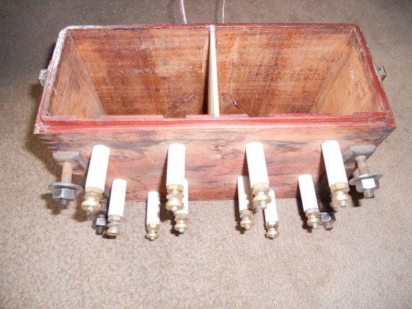

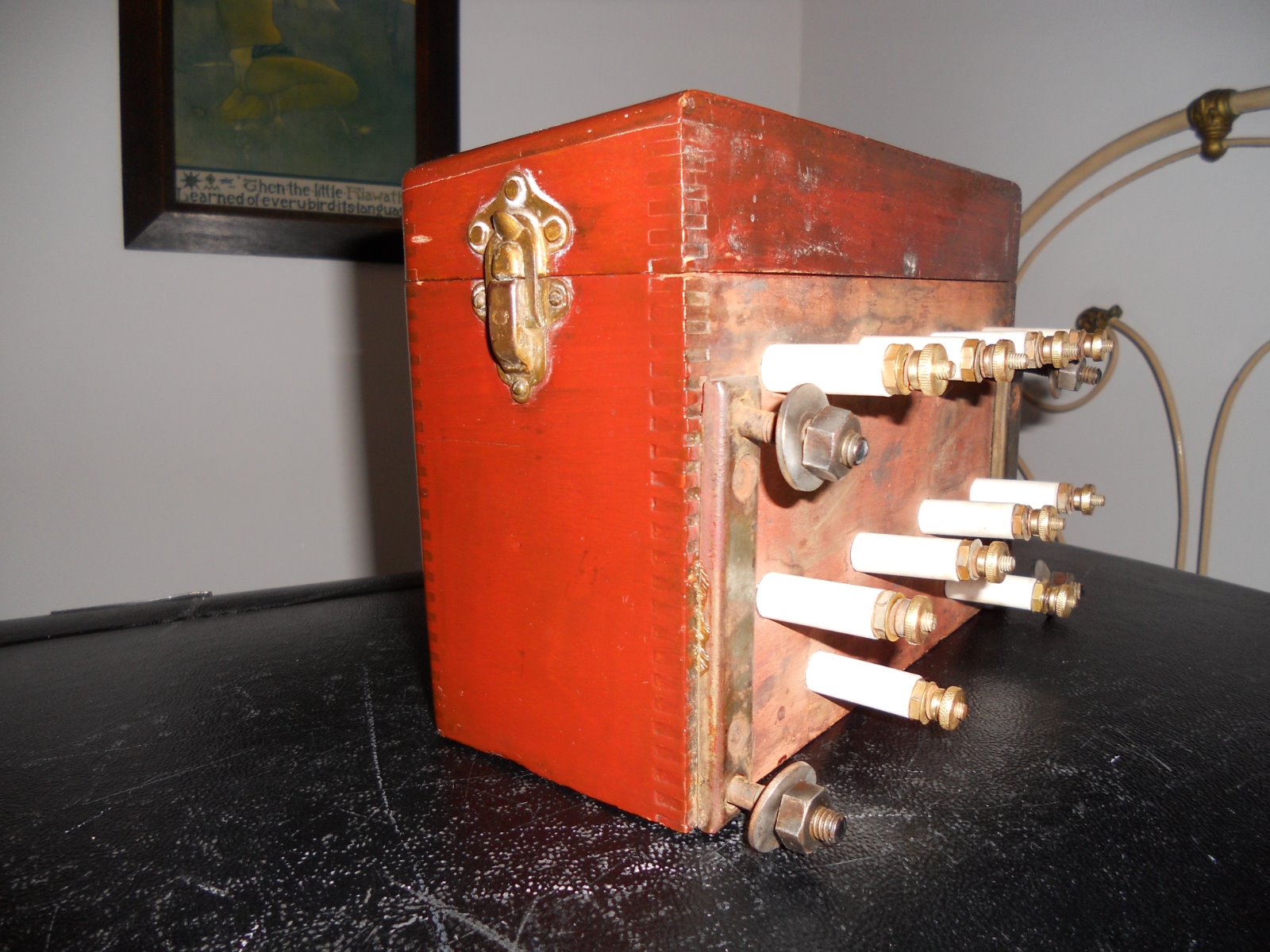

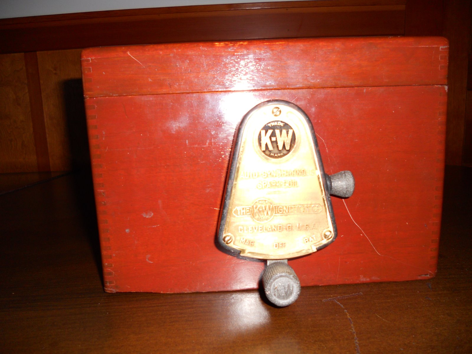

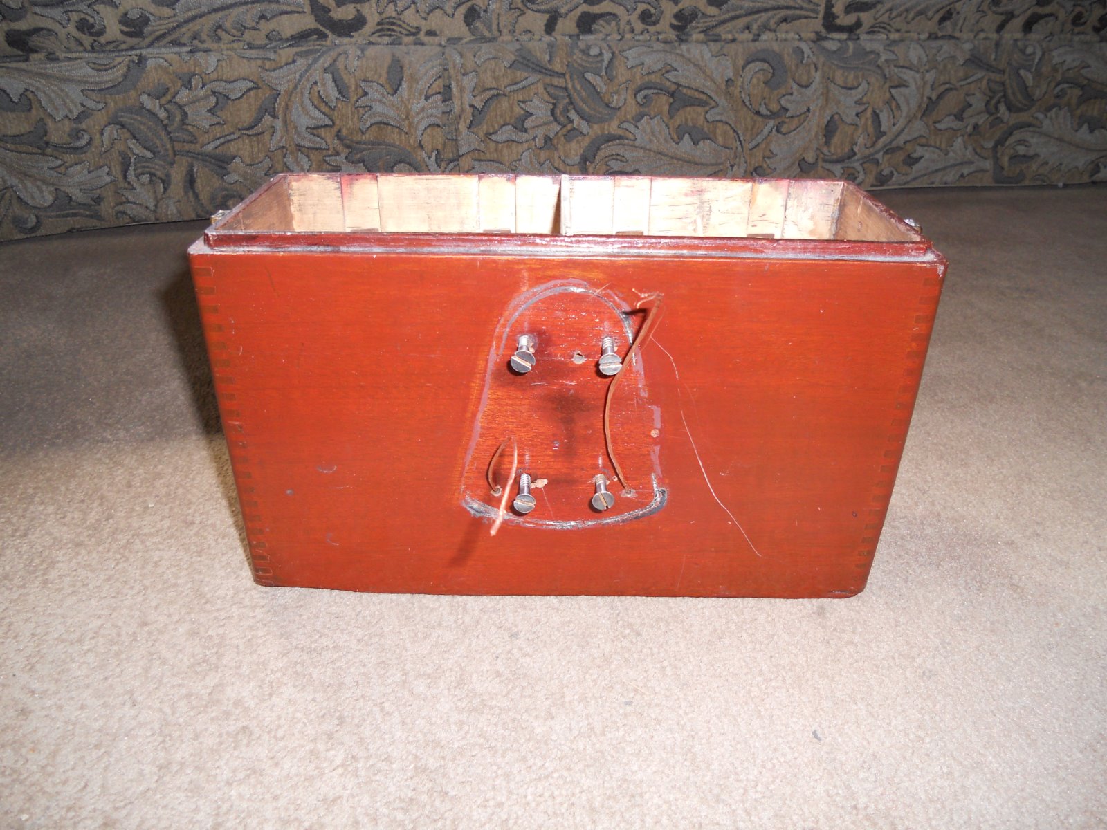

Here is a photo of a KW box I picked up two or three years ago. It even had three original coils in it, no switch, porcelains, or contacts inside. With a week I had it on the car, and running. I didn't refinish it.

Very nice Larry! Thanks for sharing, and thanks to all who have chimed in here! It is very much appreciated! Nice enough day today to get her out and go for a ride!

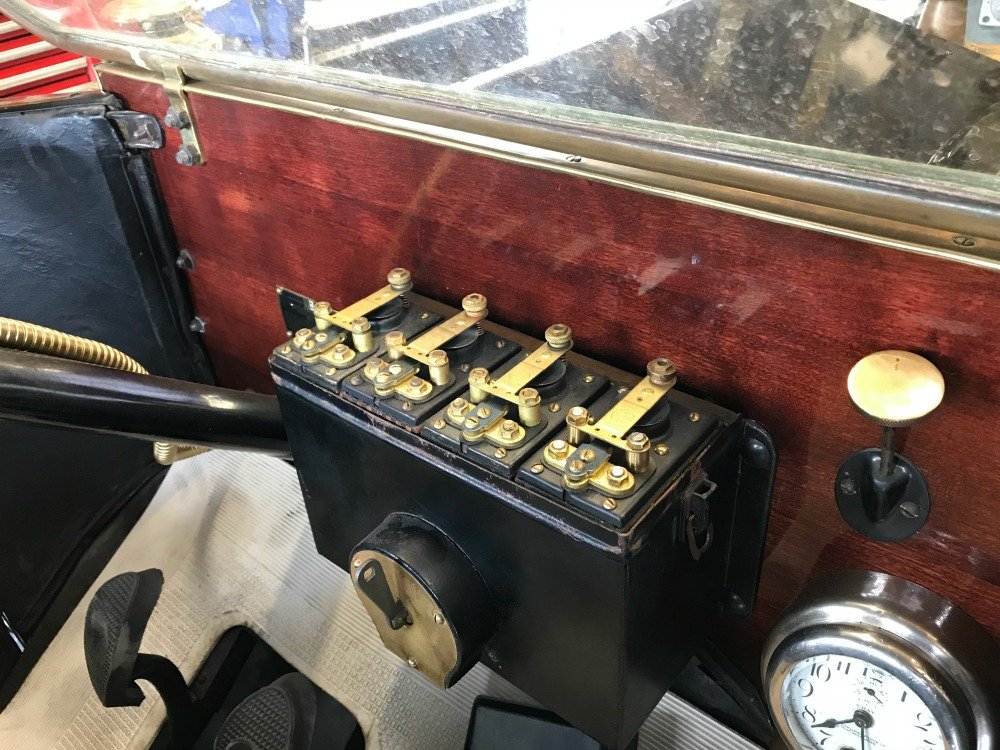

My U.S.'13 has a block date of April 3, 1913. It had a metal coil box, but it I was told that there was an 'upgrade' program that allowed owners to swap out their old box and coils for a new and improved metal box and coils. I talked to RV Anderson, and he felt that an April 1913 T would have been built with the dwindling supply of wood boxes. And the coils in these wood boxes are slightly larger then standard coils. I had him build a 1913 period correct box and coils, which look fantastic. Although not cheap, it is a showpiece for the car. Given that you have earlier parts in your car, I would go with the wood box.

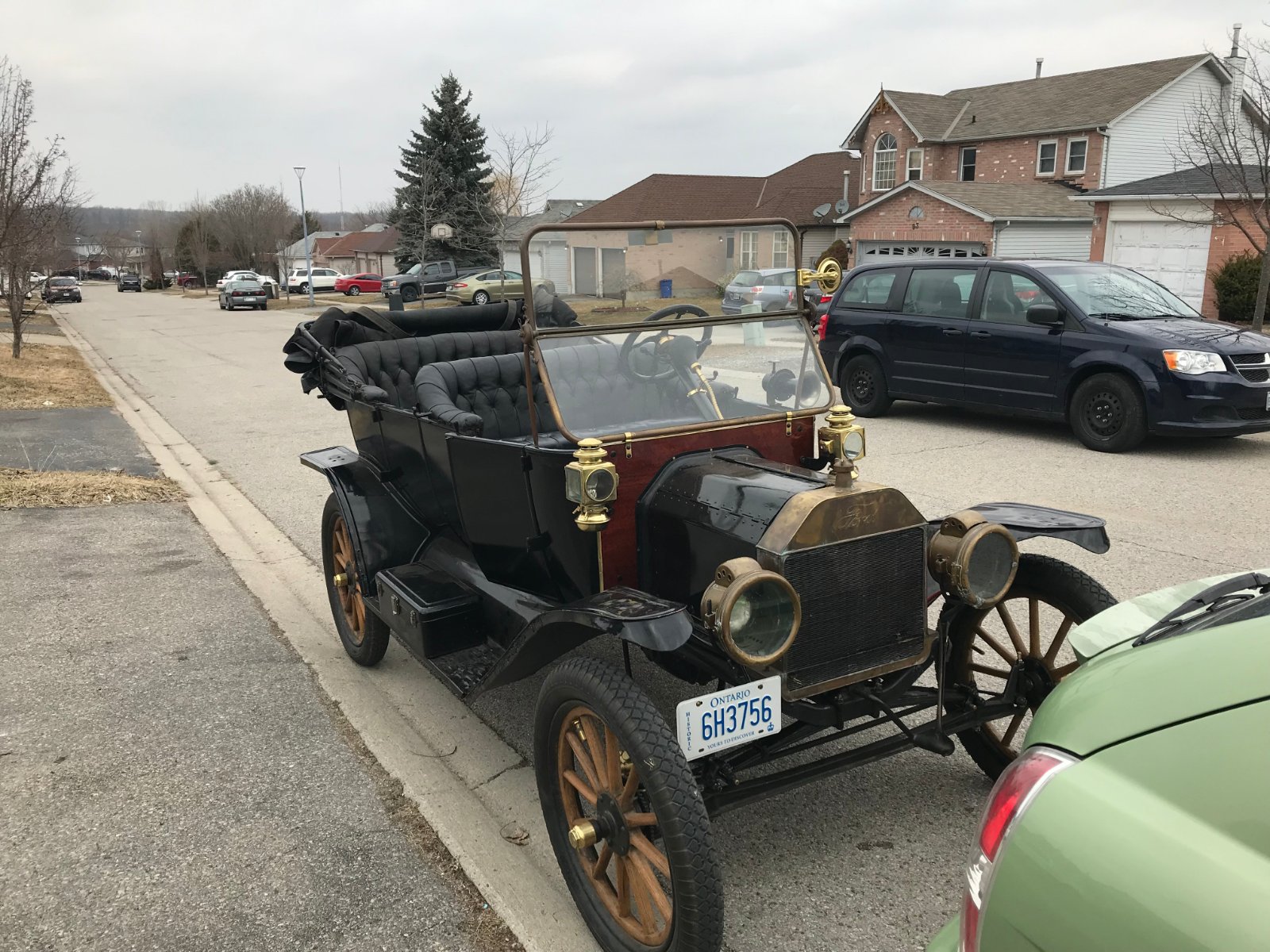

I don't think your horn is period correct. All the '13s I have seen have a bulb horn (which looks better than the A-U-GA mechanical horn). I don't know what year they started using the later horns.
Mike

Mike, That's a beautiful car you have! Thanks for sharing! I have the correct bulb horn on my car, the Klaxon was put on in the 1920's. You can still see it in this 1956 family photo. This photo also shows the incorrect bulb horn which I have saved, and installed the correct one. The 1920's photo also shows the wrong brass horn as in the 1956 pic. All the fun of correcting out the car

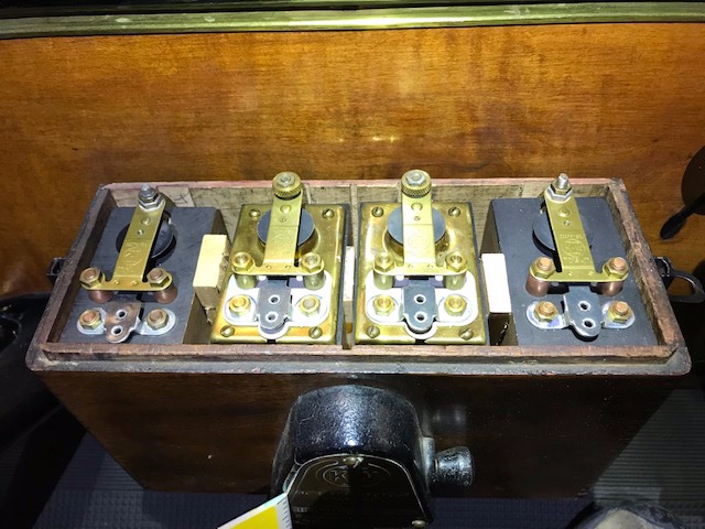

My brother has an early 13 and I own a mid year 13. Both cars have the wood boxes with the triangular KW switch. When I got my car a set of later coils had been jury rigged with extensions on the contacts to use them in the early box. It was not a good solution. Over a number of years we have acquired 4 sets of the early KW coils. We wanted the proper coils and spares for our cars because we do drive them. The early coils do turn up but you have to be diligent about looking for them.
Brent Mize (The Coil Doctor) can rebuild the early KW coils and he has done several sets for us. Normally you would scrap a common KW coil that had a bad secondary but the early coils are scarce enough that replacing the secondary winding is worth the cost and Brent can do that as well. The early KW coils work just as well as the common KW coils but they are just enough different that they don't interchange.
I would suggest to keep looking for a proper wood box and coils for your car. In the interim the metal box is perfectly good substitute.
Also the later coil boxes will fit earlier firewalls with no problem. I usually keep a complete spare coil box in the trailer when I am on tour just in case but I have never used it.
You have a nice T with a great history. The 13 T has always been one of my favorites and my brother and I both like our cars a lot.

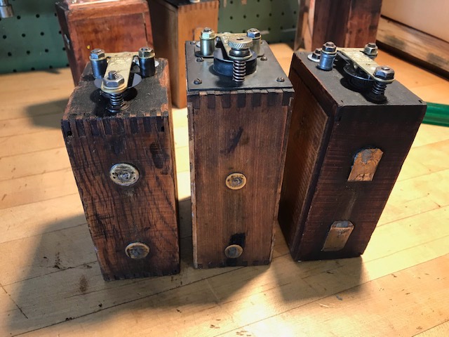

Daren, here is another option to consider. I have a 1913 with an original KW coil box. I use later more modern coils with brass strips soldered to the contacts and wood spacers in the coils box. See 2 pictures: 1) the coils in the box with spacers. 2) 3 coils: later one, 1913 one with lower contacts, and a later coils with the soldered strips.

I made the divider from a piece of wood I found at a hobby shop. I cut it to fit, and it slid right in. This is the piece in the center of the coil box.
