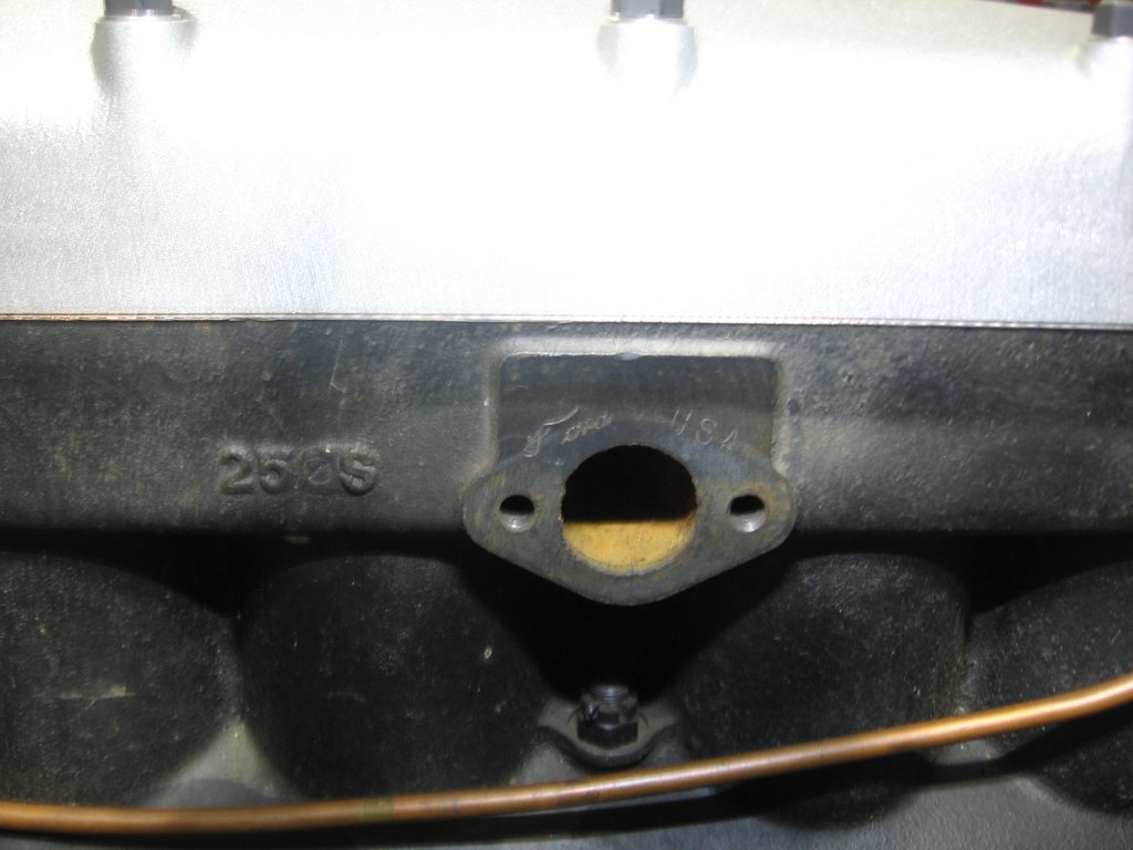

FYI, I have a Model T engine with a 25S cast date that has no serial number on the boss but does have the Ford Script and USA that is halfway on the boss and covered by the water outlet. (See photos below)

Re: T replacement blocks
That block is very unusual!
Seems like I read someplace the MADE IN USA had to be removed, around 1920 something, so Canada could buy them in the USA, and sell them overseas without someone paying an import tax.
They were making their own blocks and cars then, so I did not understand the reasoning.

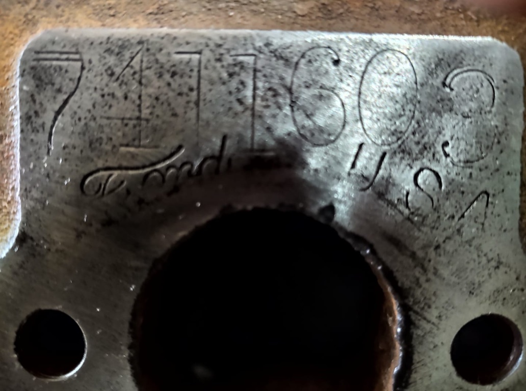

Dom
Your block is genuine Ford. Was a 'block only" and sold to dealers or agents for engine replacement part.
The boss for the serial pad is the later type, extends 3/8" under the block surface, and has straight sides to the water outlet, corners of the boss with radius. The Record of Change date is 8-27-23 for that boss size.
So your block was made after Aug 1923, and the Script and USA are factory stamped below the area for the mechanic to stamp the existing engine number there, obvious that wasn't done! The script and USA added to assure the part is Ford, and was made by Ford, as the company did try to mark parts with script after 1919.
Here is a similar block with mechanic added replacement serial #.

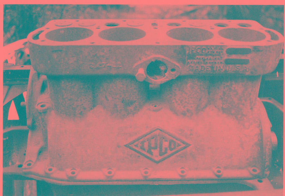

david_dewey wrote: ↑Fri Apr 22, 2022 4:24 pmA couple of companies made replacement blocks in the T time period. Don't know if their pattern mold lines/marks would be the same as the factory's. And I don't know if any of them included any "improvements" to the Ford cast blocks (more robust bracing, etc.).
Here is one aftermarket block, by IPCO, lots of different features and even the blank boss for engine serial number to be added is in different place than a Ford block. Would assume all the other aftermarket blocks being very different from a Ford block./b]
