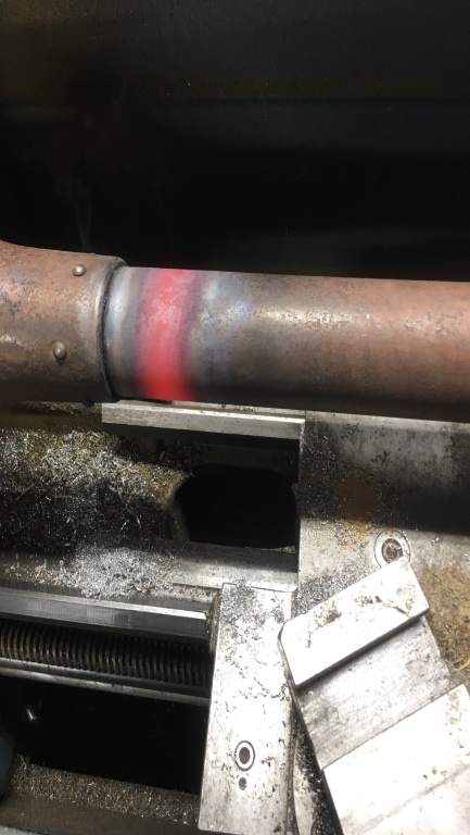

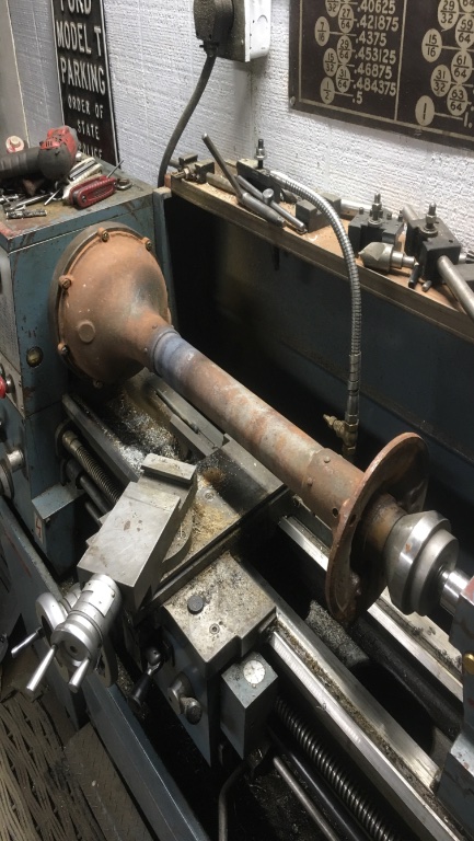

Building a couple rear ends for people. It’s amazing how many of them are bent. Like oil pans. I have never put one on my KRW jig that didn’t need some correction.

Heating the tubes doesn’t bother the Ford steel tubes. I will straighten housings if you get them here. It’s $50 a pair.

I had 4 large spigot bushes made up that slide into the housings where the Hyatt Bearing Sleeves go. Then after we believed
the housing were straight we bolted both housings together and offered up a 2” Diameter steel bar. This slid through all 4 bushes and exited the other end of the housings . This proved that all sleeve diameters were in perfect alignment.

Perry, I would have to use my big lathe for that one!

Bending the tube to align with the center casting bolt surface only works if the tube itself is sprung and you are straightening the bend. If the problem is the center section is sprung or was not riveted to the tube correctly, bending the tube will cause the roller bearings to be misaligned
One attempt to address this concern is to mount a large plug to the fixture which is held in the lathe to which the housing is bolted. The plug fits snugly into the inner bearing when the housing is bolted up.
The idea is to keep the bearing hole horizontal so that bending the tube won't misalign the bearing holes .
If the bolt surface of the housing does not bolt up evenly on the fixture with the plug inserted, the problem is a misaligned center casting and that should be addressed. I'll try to post a photo of the fixture later.

I’m going to be the devil’s advocate here in a respectful way. I’m a 35 year tool and die machinist and a millwright. I believe by correcting these rear ends you guys are doing a great thing.
That being said, honestly, how many rear ends had alignment issues right out of the gate? We’ve all seen what a frantic pace old movie footage shows Ford employees going like Jack the Bear.
How many of these rear ends were checked to the accuracy of indicating them up in a lathe?
Trying to achieve a perfect alignment with a rear axle could be all for naught the moment you hit a pot hole or disturb the rear end with a hit or shock of significant force.
So really what acceptable amount of error in alignment is safe?
.001”?, .005”?, 1/32”?, 1/16”? I would be interested in knowing where one should draw the line.

I try for 1/16”

I’m sure a lot of them were not perfect right out of the factory. But I like to have them as straight as possible when they leave my shop.

I've settled for .050" swing, but try to get less. By that I mean swing at the wheel end with the center casting end mounted in the lathe fixture.
