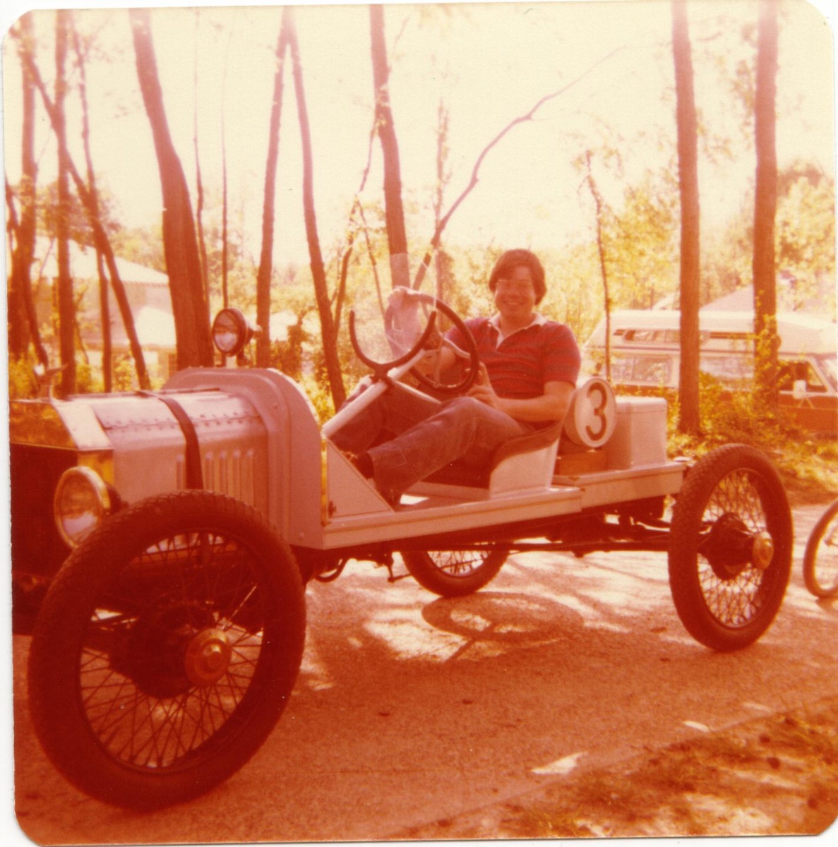

'15 speedster: Light weight body, std. axle ratio 3.63, rebuilt motor, Holley G, 12v battery, 4 trembler coils. (no mag, 4 angle iron flippers on the flywheel))
This '15 speedster was slow getting underway due to the lighter flywheel, but once going, fast runner.
'09 faux runabout, Light weight body, std axle ratio 3.63, rebuilt motor, Holley NH, Ford magneto, 4 trembler coils.
Very quick launch, as flywheel being stock weight gives the torque with low pedal, popped into high quickly too.
Winner of Stock Class in drag race (Hill Climb) Winchester Speedway, during the Richmond Model T birthday celebration
