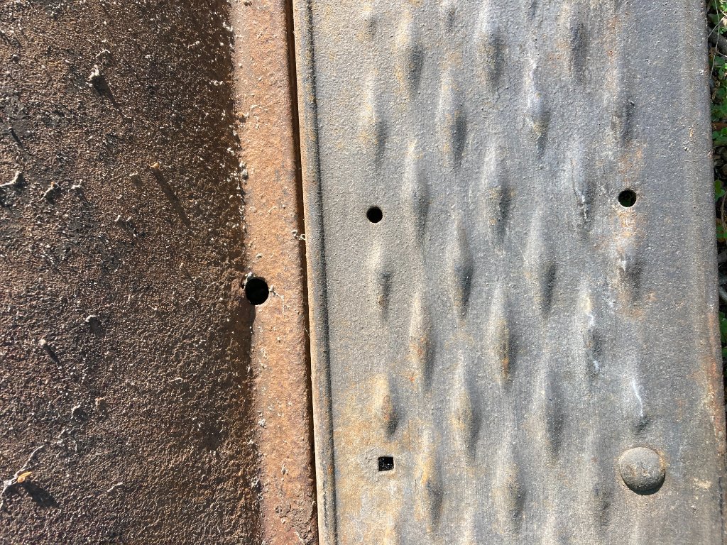

I am about to install my new (!) gas generator on the running board of my 1914 Touring. There are no holes in the running board so there have never been a generator after its restauration some maybe 20 years ago.
So I need a meassure from the front edge of the running board to the body of the generator. Support eventually your response with how you meassure the distance.
Thank you in advance. Picture for attention :-)

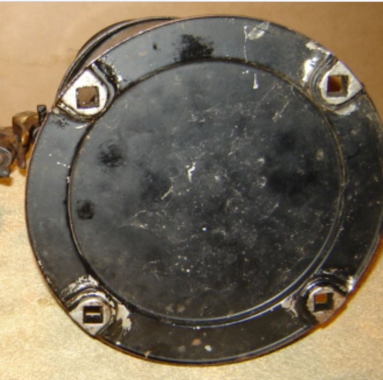

I will assume you have a generator with a "four hole" base plate (see below),
if you do:
Beginning about June 1912, Ford began using the two front running board support holes for the front two bolts on the acetylene generator.
They are spaced 5" apart and match the two holes on the four hole generators used.
You already have those two holes in the running boards you have mounted.
Just set the generator holes over those two and the two rear holes will be located for you.
They will be 5-1/4" down the running board and spaced the same as the front.
Also, when you mount the generator, orient the gas outlet toward the splash shield.
The 1/2" gas hose hole is in the center of the "flat" area of the splash shield next to the running board in line with the two front running
board holes you already have.
BOTTOM OF ACETYLENE GENERATOR

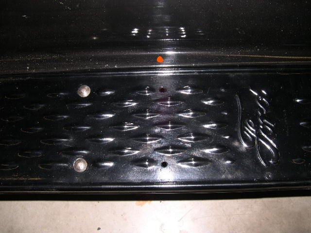

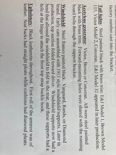

Michael, attached photo of a page from the 7th Edition MTFCI Restoration Guide and Judging Guidelines. Page 2 of the 1914 section regarding the acetylene generator.

Here you go, Michael
see the picture regarding holes/location as posted on http://www.mtfca.com/discus/messages/50 ... 1421797605 1/20/15 1:10

A huge thankyou to Mike Walker for the post of the correct running board! Most restored examples have been changed. As I mentioned above, compare the Ford script to that on a later example, and you will see the difference. If your running board has been changed, as mentioned above, simply place your generator above the running board holes, and that will locate the rear holes for you. If your right hand running board is original to the car, it will be as the example that Mike posted.

Michael D,
In Mike Walkers photo of factory punched running boards noted above, I have put
a red dot on the splash shield where the 1/2" gas hose hole was punched beginning
about June of 1912 and probably to the end of factory acetylene gas headlamp use.
It is in the center of the "flat space" adjacent to the running board and in
line with the two gas generator mounting holes punched in the original running boards.

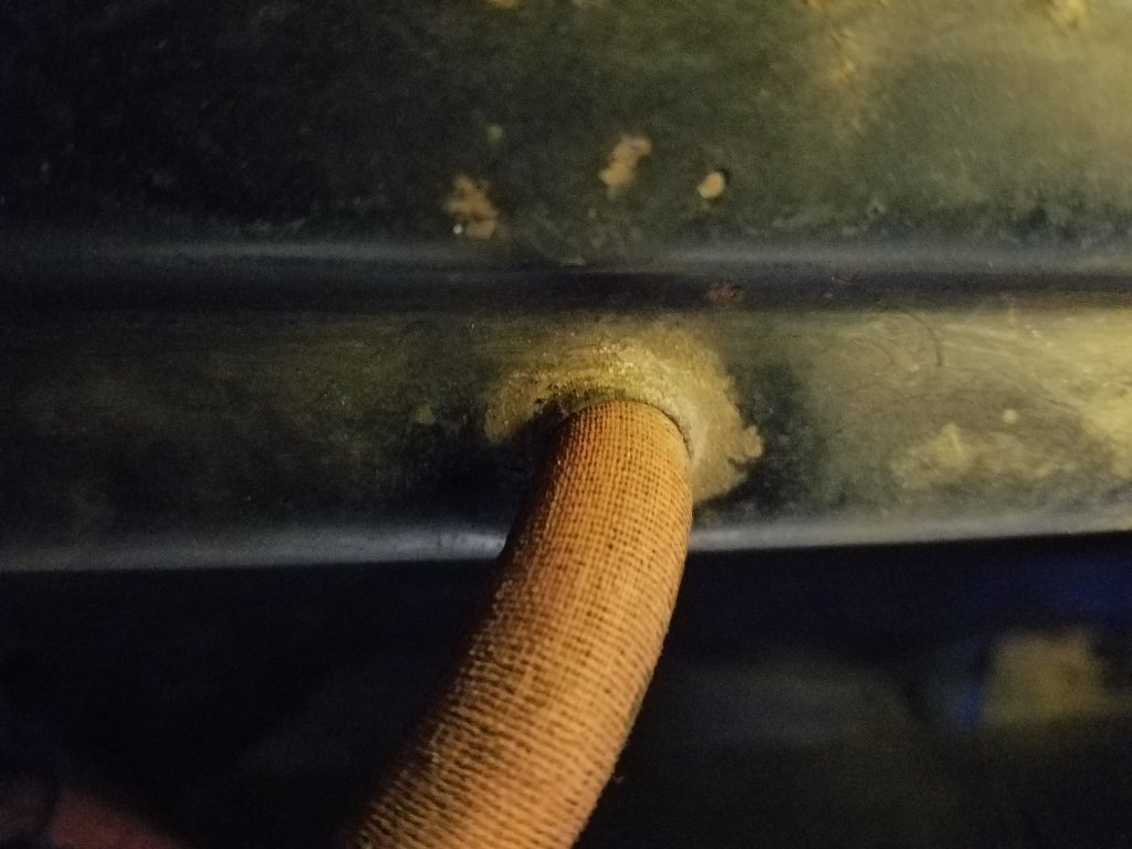

The second photo is from under the splash shield and shows the 1/8" smooth
rim factory punch on a July 1913 car. The smooth rim protects the hose.

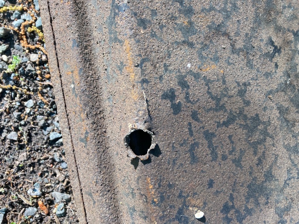

Thank you for the info - I have no idea if the running boards are the right ones, but the rest of the car is to the best of my ability and knowledge pretty original with correct 1914 parts. Yeah, you may look closely on the picture above (which is also found in the Langs 2022 calendar) that the front axle is alater and more safe version, but I have the right axle on the shelf.
Generator is now on it's way to be mounted.....

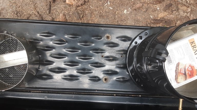

Runningboard bolts removed:
and test mount for marking up for drilling the extra holes.

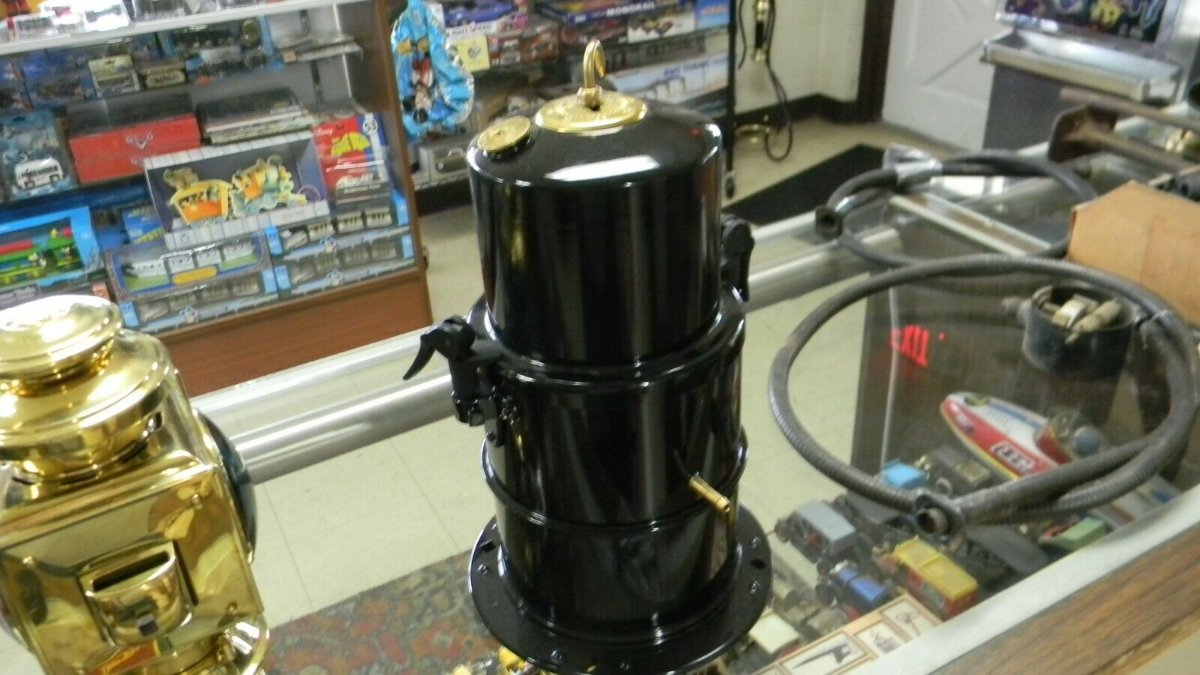

(And before you asks - yes it is a brand new reproduction generator - claimed to be the last of the batch made for the 2009 NYC - Seattle tour where apparently sufficient wanted it made to allow for a small production. Ironically it was claimed also to be made in Sweden of all places! So now both US customs and danish/EU customs have gained on this transaction)
Picture from eBay ad.

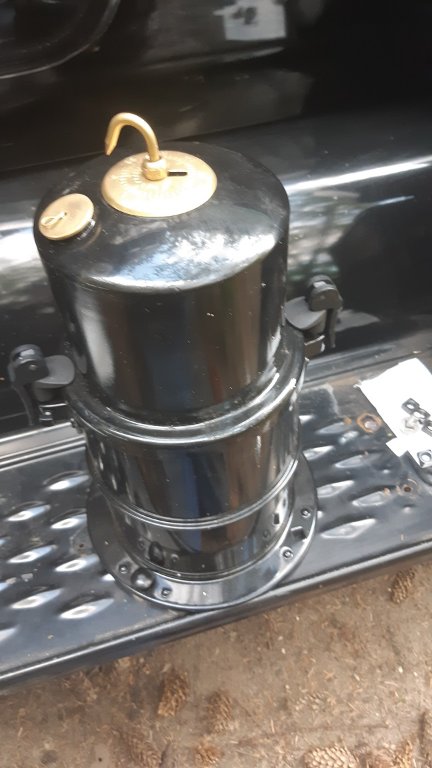

Post by dykker5502 » Wed Apr 27, 2022 5:51 pm

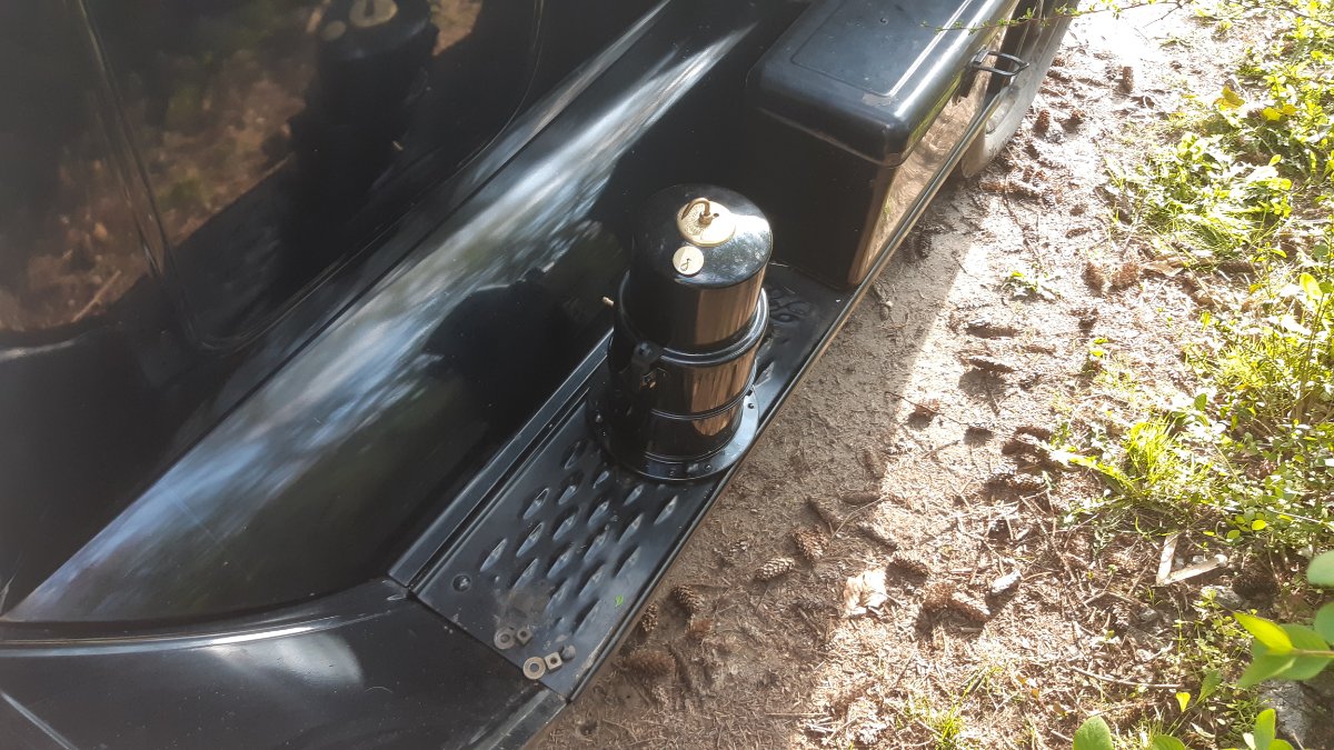

Final position. Now to the tube hole and there have been good advice above and in another thread.

Post by Drkbp » Thu Apr 28, 2022 9:36 am
Michael,
Very nice Victor style generator and looks great!
Do you know if it is functional?
Ken
