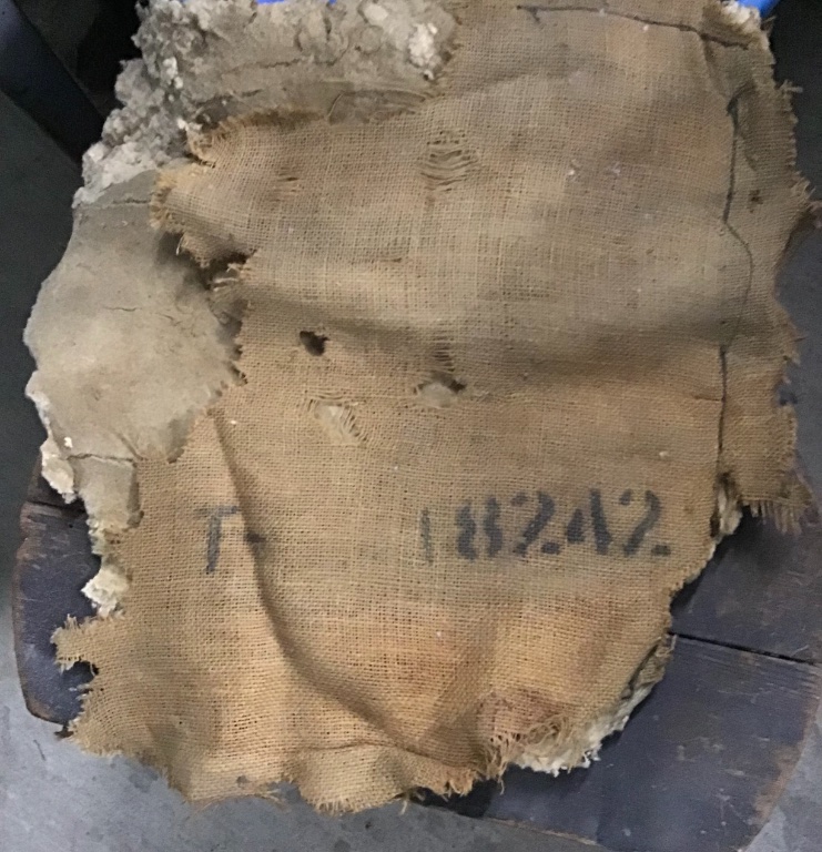

I have a 24 Coupe that has a stamped number on the left body side on the lower floor. I’ll try to get a picture of it later.
But I do have a T part no. that I found under one of the original front seat cushions when I installed new seat upholstrey in it a few years ago. This car was my Grandfathers and was well used and the upholstry was in tatters.
I don’t know if the open cars had part numbers for there upholstrey.

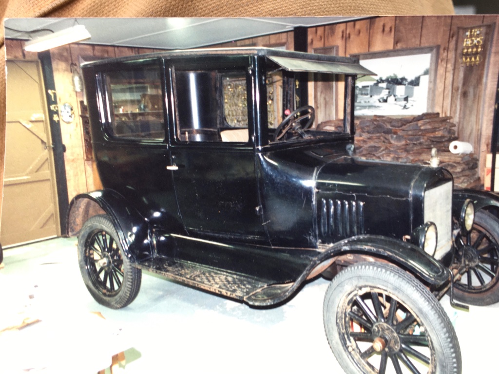

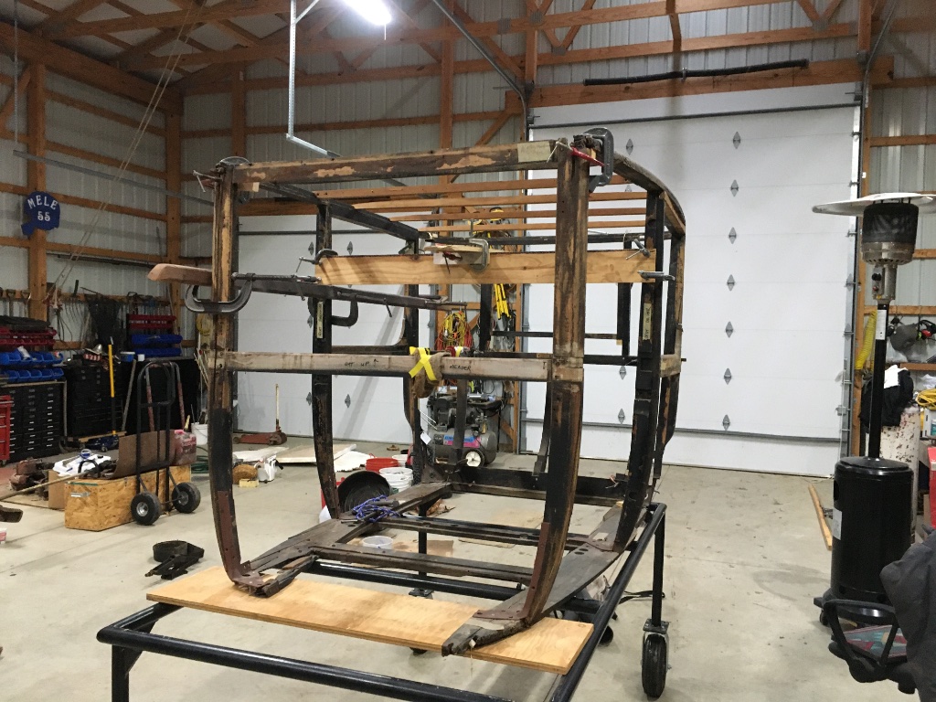

If you look at the before and after pictures I think I’m going in the wrong direction but hopefully I’ll get there one day

It’s been a long winter can’t wait to start assembly
