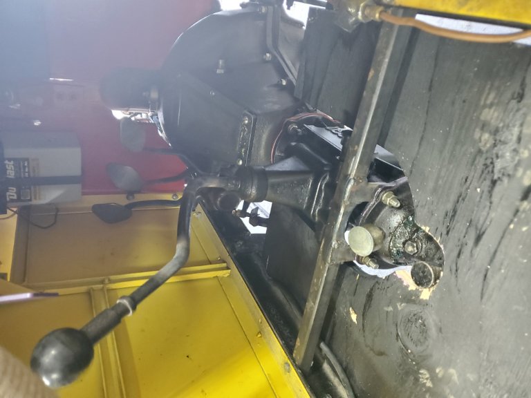

Bought a mark e at Hershey last yr. Finally got around to putting it in this week. Under engagement is good and deep, direct is good and deep, over is not. Only about half way. I noticed that the shift rod for over has two detent notches. Why is this?

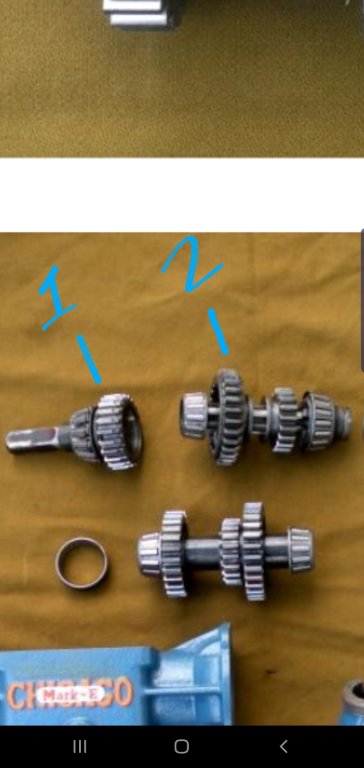

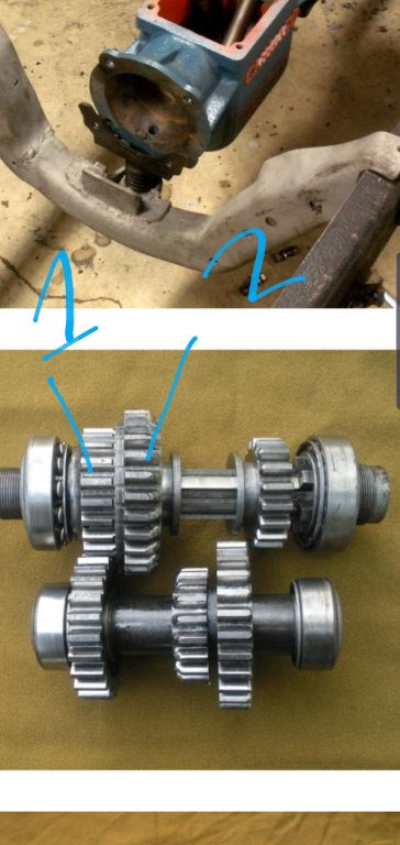

I did a search and found a post from clayton. It looks my my set up. If you look close it is a very short engagement when Gear 2 goes around of gear 1 in high. Its basically half the engagement of the other two gears. The notch in the shift rod would also point to it being correct. If anybody has a chicago ou there, does your high hear engage as deep as low and direct? Thanks.
