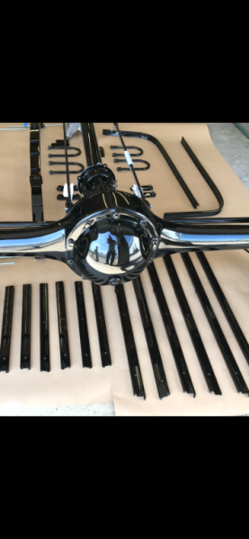

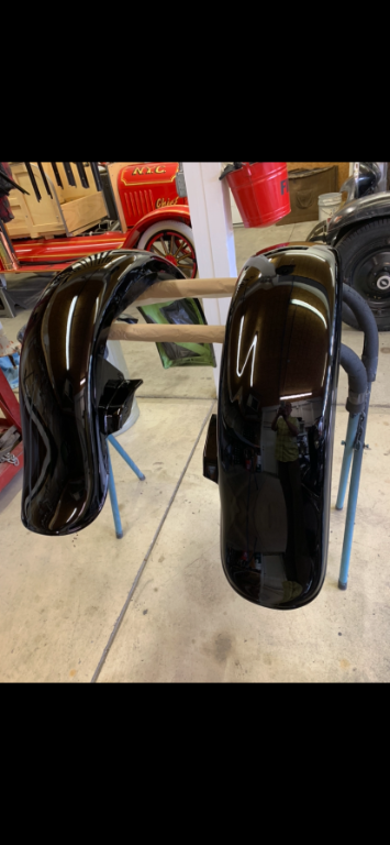

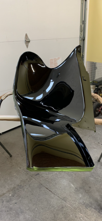

Sherwin-Williams Automotive produces a single stage urethane enamel product called “ Genesis G2”. It is an industrial coating that dries very hard and is not supposed to chip. It is used by trucking companies where appearance and durability is required.
I’ve been using it on the underside of Antigue auto fenders for several years. If you’re restoring a show car and plan to cut and buff the finish, I would suggest you do it within 48 hours as it will be too hard to do so after that.
