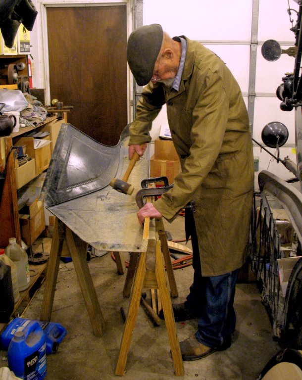

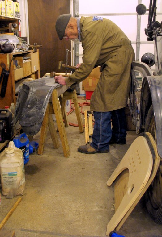

Nobody else has done it, so I'll start it off this month.

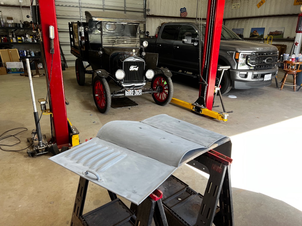

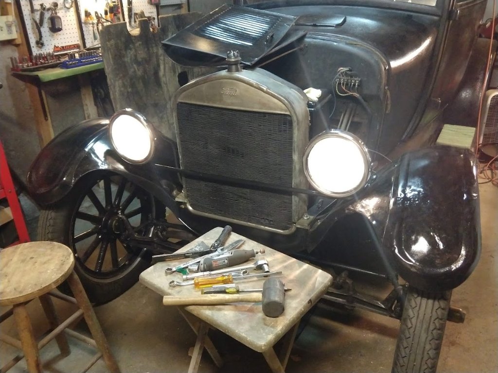

I'm not an experienced body man, but today I pounded on a bent front fender.
I got it straight so it doesn't pop back to bent. It's ready for finishing the sandblasting, and then soldering.
My other job of the day was straightening the dings on this front wheel from running on gravel after throwing a tire last fall.

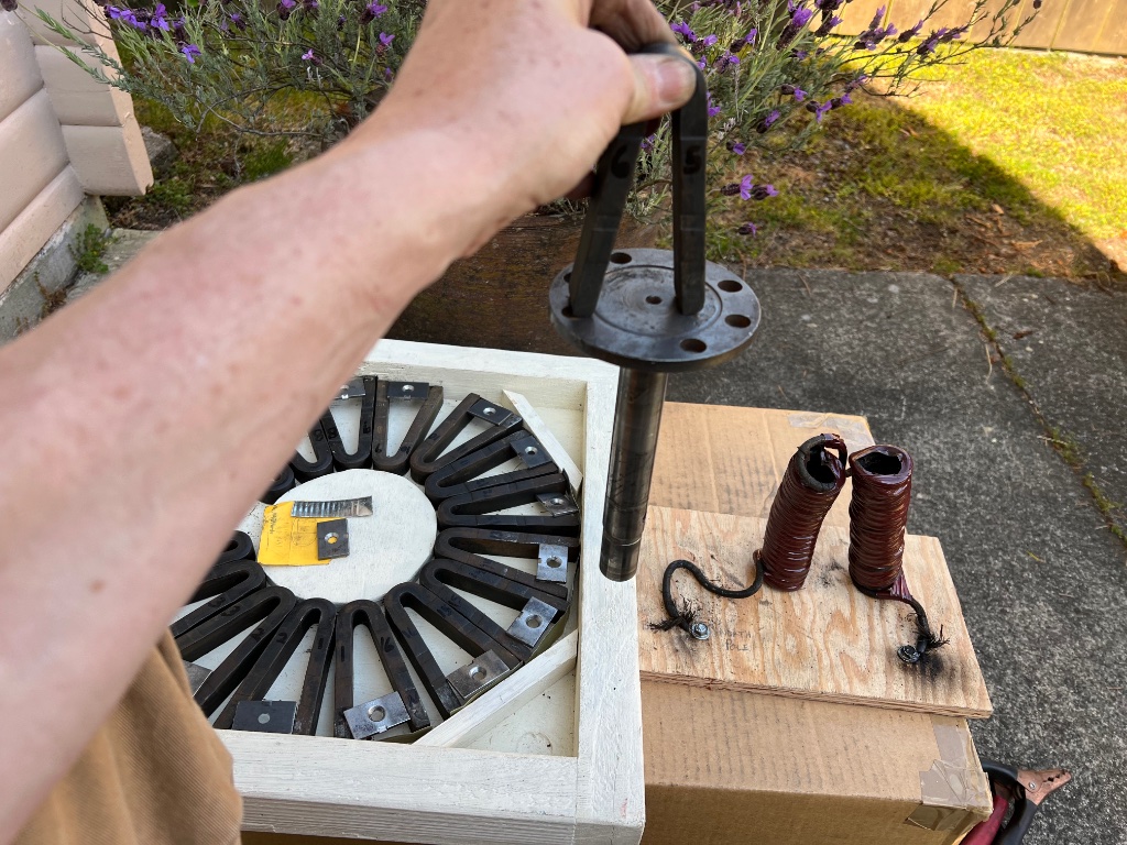

Completed the rebuild and fine tuning of a nice set of coils, then re-
-installed the e-timer I had on the truck briefly when the engine was
freshly rebuilt (removed while I worked out other bugs). Truck moved
out like a scalded dog, but died intermittently, leaving me to push it out
of traffic and ponder my problem. Seems the battery terminal in the switch
is breaking contact and requiring some love. A quick setting of the mag
wire to the feed terminal on the connection block got me back on the
road and home. Damn, would it pull hills ! I am impressed.

Steve, straightening the fender skirts can leave you with a fender with not quite the same side profile. I usually trace the outline of a good fender on some stiff card and cut the outline to use as a template for the other side fender. If the skirt was stretched when it was bent, and all you did was straighten it, you may still need to shrink it a little to get the profiles to match. This may lessen the grief of trying to get the front of each fender sitting at the same height.
Hope this helps.

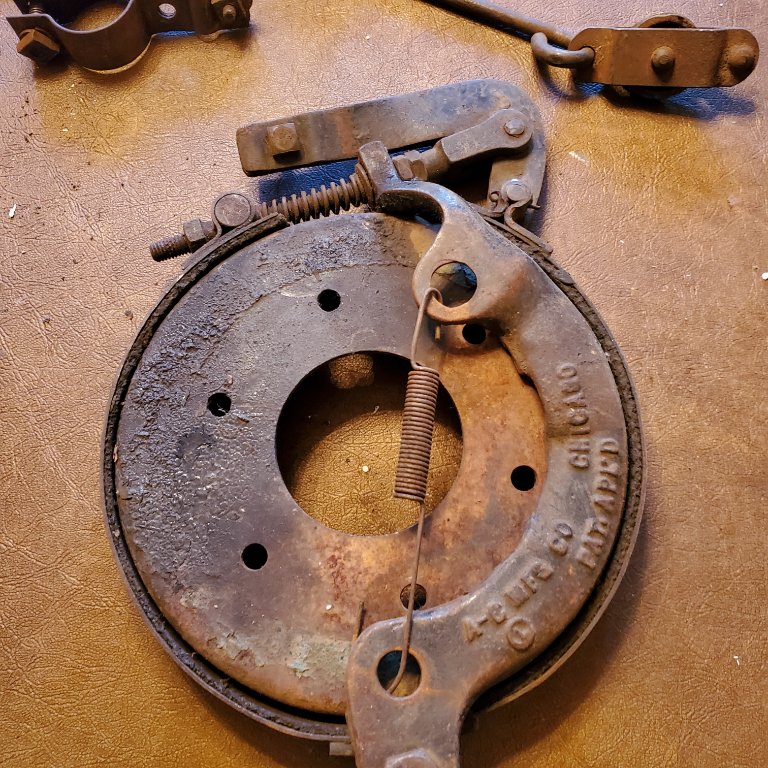

I do have to replace my transmission band linings (I realized the break band is starting to score the drum
, so we’re off the road for now.).

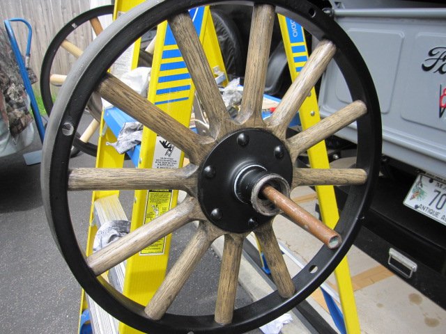

I have been getting wheel parts ready for my '14 to go to Calimer's wheel shop for new wood.

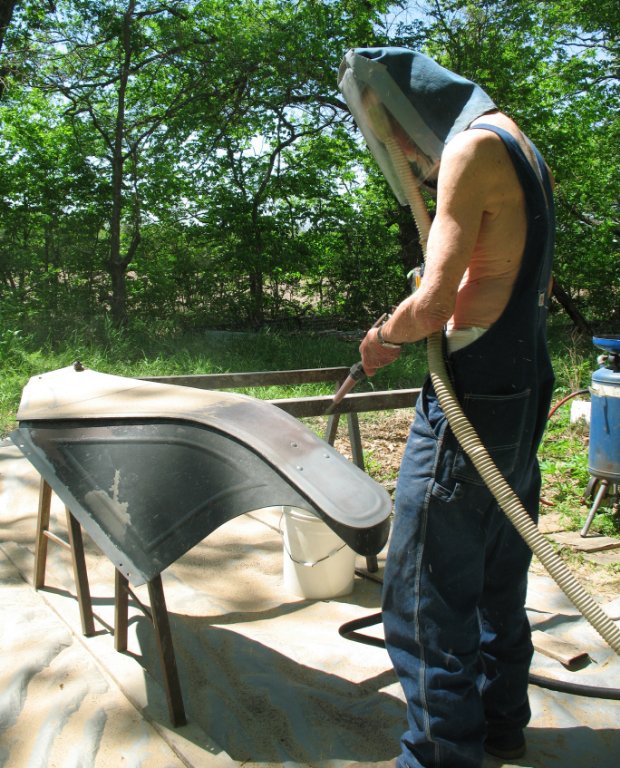

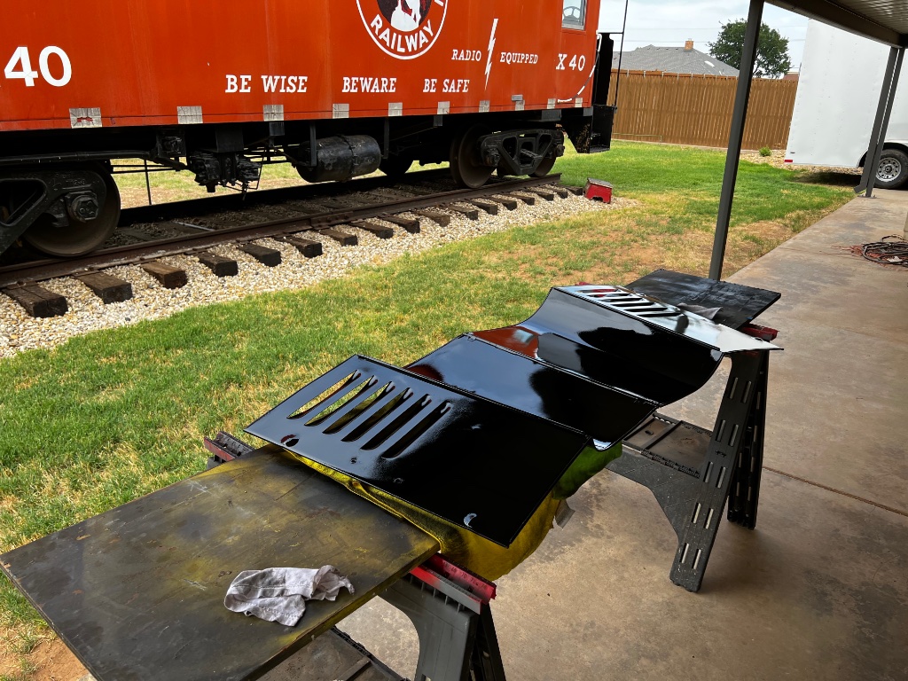

More front fender blasting.
The old lacquer was awfully tough, and it was mighty slow going until I remembered the pneumatic scaler.
That breaks up the lacquer and uncovers the red primer.
The primer comes off a lot faster.

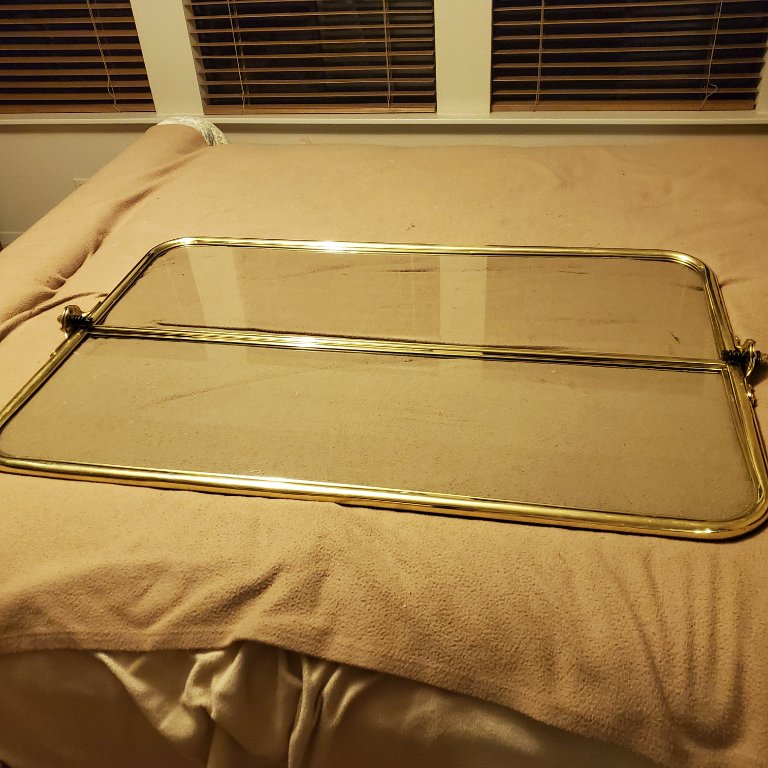

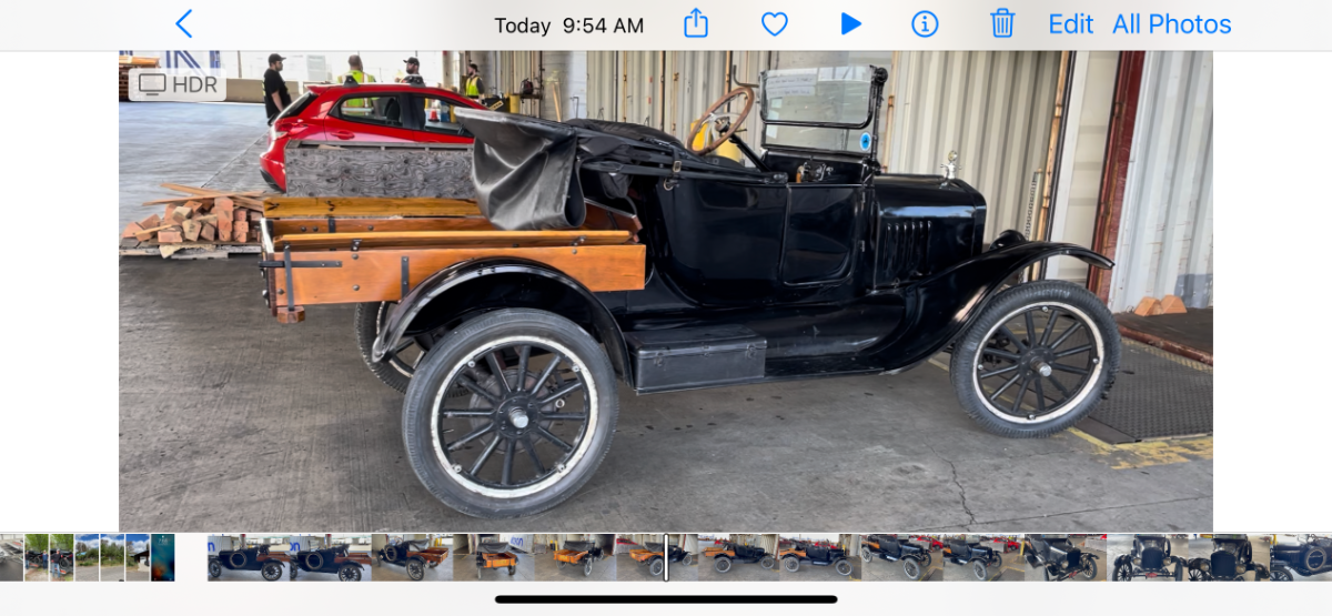

Just finished the brass windshield for a 1912 MIL roadster. The car was delivered to the painter so I'm finishing up odds and ends. The car was in an accident a few years ago and both panes of laminted glass were broken and the bottom frame and center channel were bent. I was able to straighten the frame and replace the center channel. The windshield was new 20 tears ago but was installed on two cars over the ensuing years up until the accident. It has a few niks that didn't polish out but I got it all to fit back together pretty nicely I think.

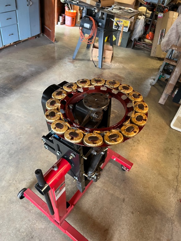

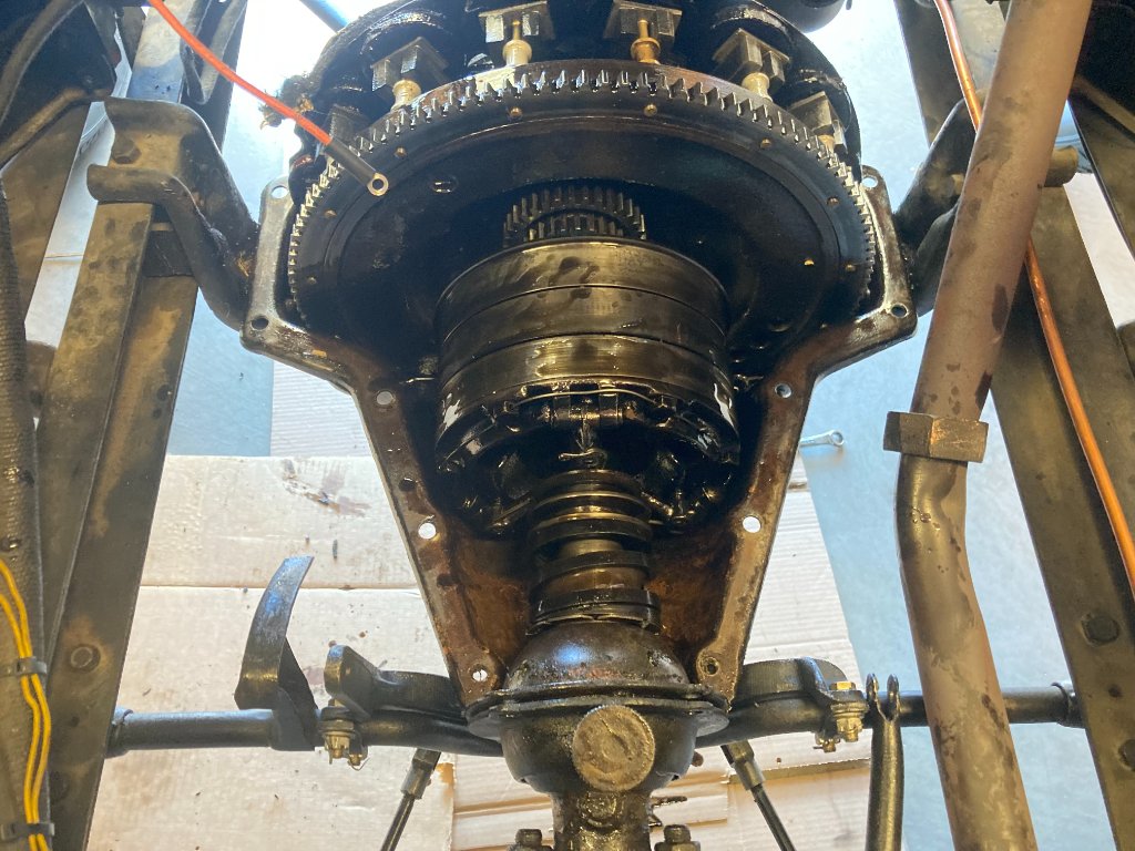

At long last I set the engine back in the Tudor. We lost the bands on a tour last Fall. I managed to repair the damage and after some illness, the Winter weather and some yard work, I have gotten back to it.
viewtopic.php?t=23886#p183662
The Kevlar band lining didn't smooth out like it should after riveting the ends flush. It worked well on the last batch but this one left some humps. I installed them and tightened them to the max hoping the lining would compress. Then I loosened them to give clearance for breaking in.
Rather than fight the transmission cover in the car I decided to install it on the test stand along with the starter. Removing the firewall was necessary for this. It went in easily except for the usual go round lining up the U-joint. I will work up the courage to put the firewall back in place later today.
As Larry mentioned a few days ago, it is very rewarding to and remember the work in putting the car together the first time. Those extra details to make it as right as possible are soon forgotten and a treat to see again.
Keeping my fingers crossed.

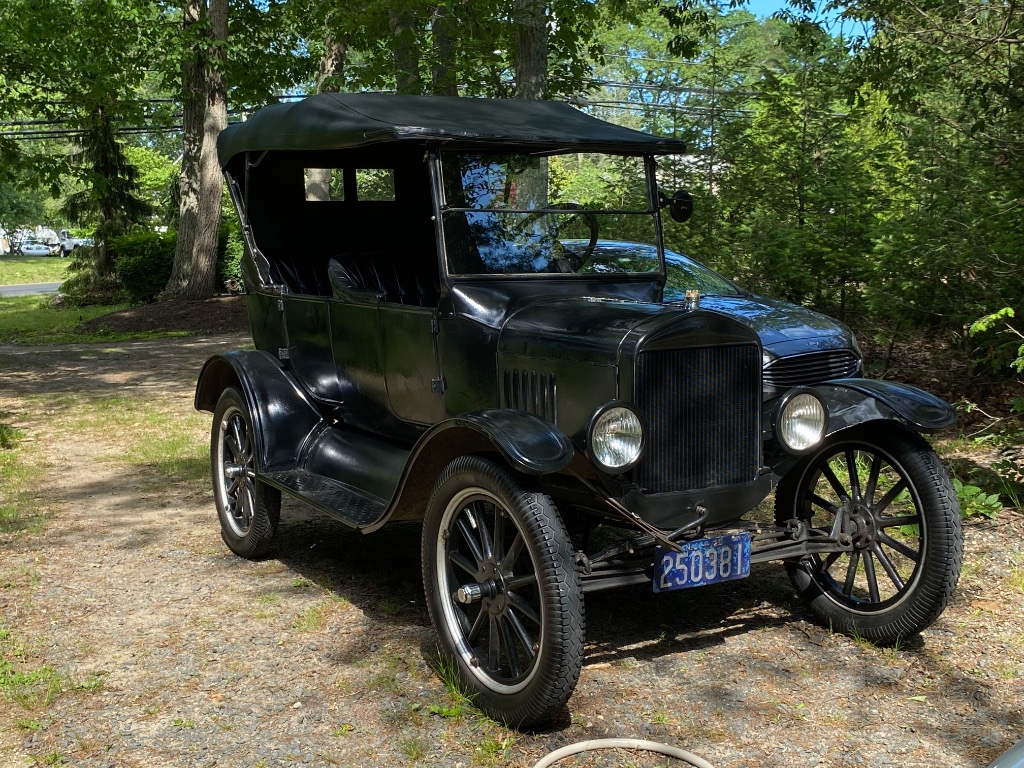

Fixed the starter bending on the ‘25 roadster. I had postponed doing this for several years fearing what I might find when I got the old bendix out. Turns out it was just the long bendix bolt that was broken, and the missing piece was still in the bendix cover when I removed it. No harm to the rest of the motor. Still, I had to deal with my least favorite part of a Model T: the inside bendix cover screw. The getting it out part wasn’t too bad, but the getting it back in part is what strains my patience.

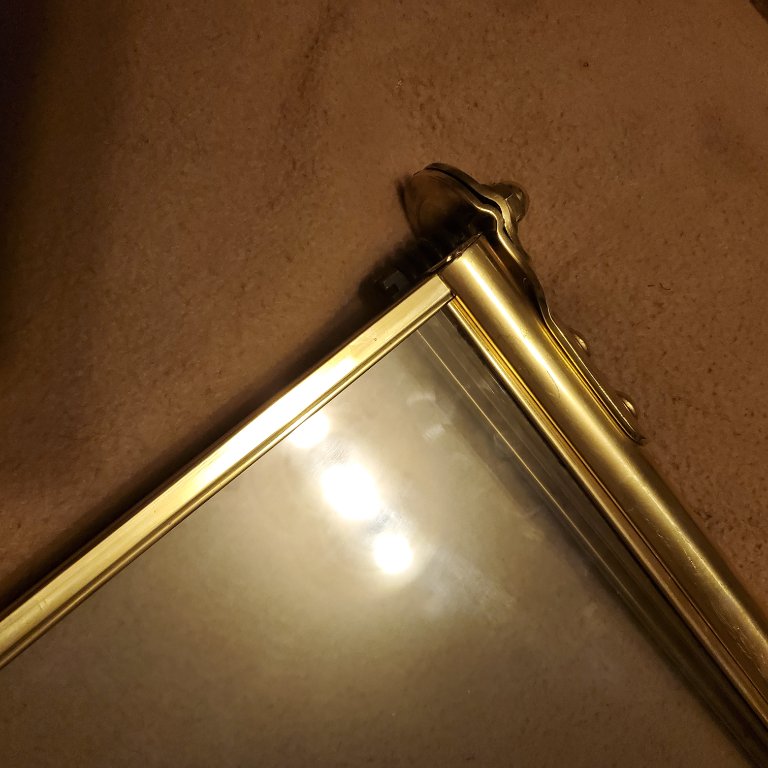

Finally got new windshield glass installed (plate glass had cracked due to sagging windshield frame). Then finally got headlights wired and running properly. When I restored the headlight buckets, I left paint on the surfaces where metal to metal contact is necessary for grounding. One headlight worked, the other was barely on. When cleaned of paint they both worked fine. Next is the horn wiring. I have a Fox locking keyed wheel and the inner contact ring needed some restoration as some of the plastic insulation was gone. Solution? Black liquid tape. We'll see how that comes out. Thanks MTFCA for all the family help.

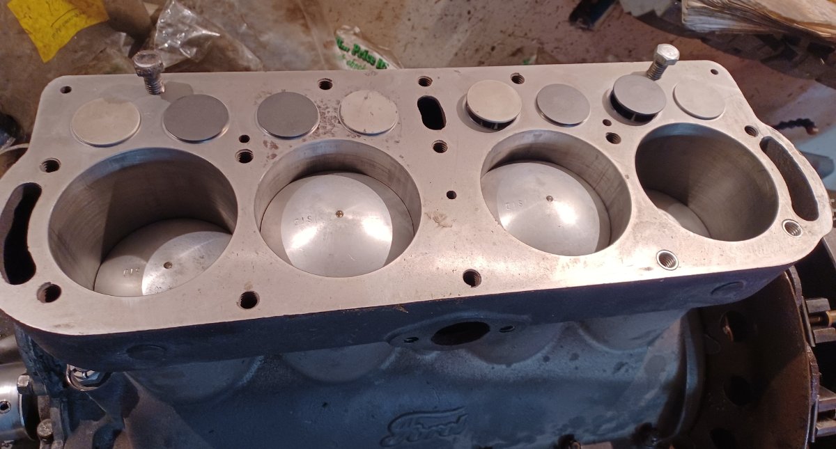

Test fitting this increased compression head for clearance. Thanks Mr Prus! had these triple gears fitted with needle bearings! They took a trip to California and back. Thanks Mr McEachern! Otherwise having a blast in the model T world

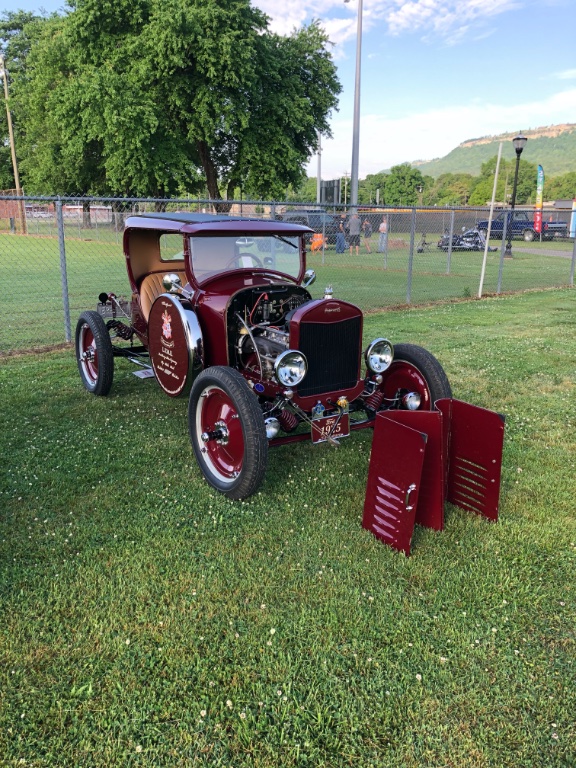

Re: What have you done on your Model T in May?

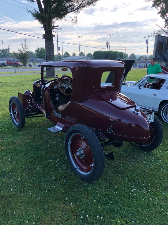

Benefit car show for a young man (37 years old) Fighting an aggressive cancer! This is my first car show..., imagine that. Really!
- Posts: 2838
- First Name: Dallas
- Last Name: Landers
- Location: N.E. Indiana
That is one sweet ride Hank!!!

Did more pounding on my fender-straightening job, and welded up a split. My attempt to learn wire welding did not go well, so I used acetylene and a 000 tip. I think I did it well enough to hold together.

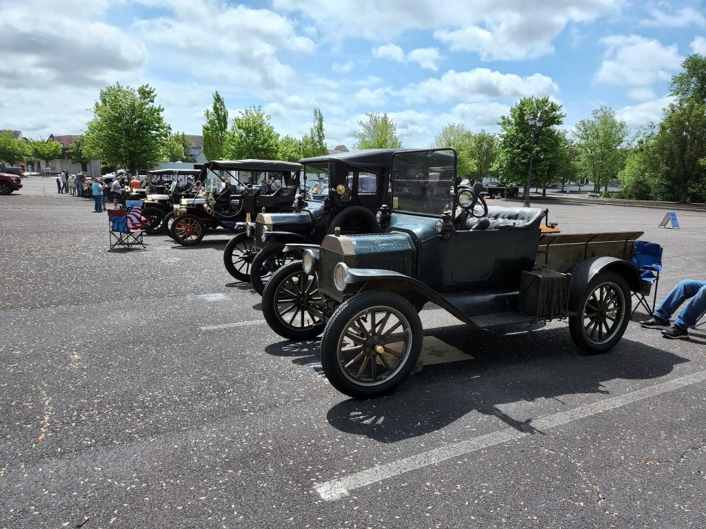

Took my RPU to the May 15th HCCA BBC Tour/Car show in Gettysburg, PA. Lots of T's and three Model K's there, but I didn't take too many photos.

In the process of disassembling and bead blasting a set of original and complete AC brakes. Surprised me how nice they cleaned up. I doubt if I'll even have to to reline them. Purchased a few years ago from Mark at Chaffins. Thanks Mark!

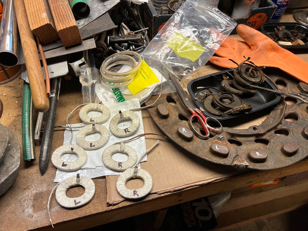

I replaced the cotton bands in my 19 with wood. The NoCo Model T Club helped me out by turning the day into a seminar on the transmission system.

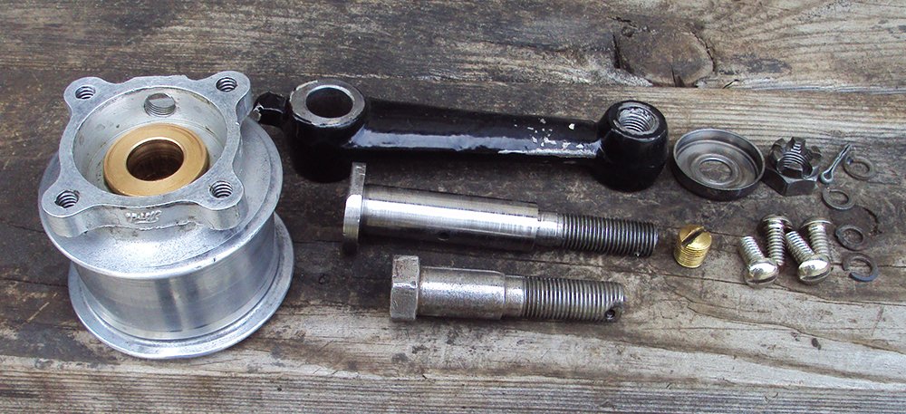

Work continues on the Tudor repair as time and ambition permit. This has been a good opportunity to clean and service everything especially parts that came off in removing the engine. It's nice to see the Dulux Black has survived the 20 years it has endured. I'm taking pictures while it is still clean.
I was also pleased to find the fan bushings fitting the shaft so well. A .001 shim produces definite drag. It was still well oiled but cleaning and fresh oil will help it last longer.
I know full well that a fan belt guide is not necessary but they are cute and I like to make them. The previous one had escaped it's mount and was long gone when I tore things down. I made a new one from materials on hand. This time I swaged the parts and then silver soldered them. I was happy to see that the one that failed was an original accessory rather than one of the several I had made. I can afford to made mine a bit heavier.
They tell me that if your fan pulleys are properly crowned the belt will run true and "never" come off. If that is true then this guide won't wear the belt much.

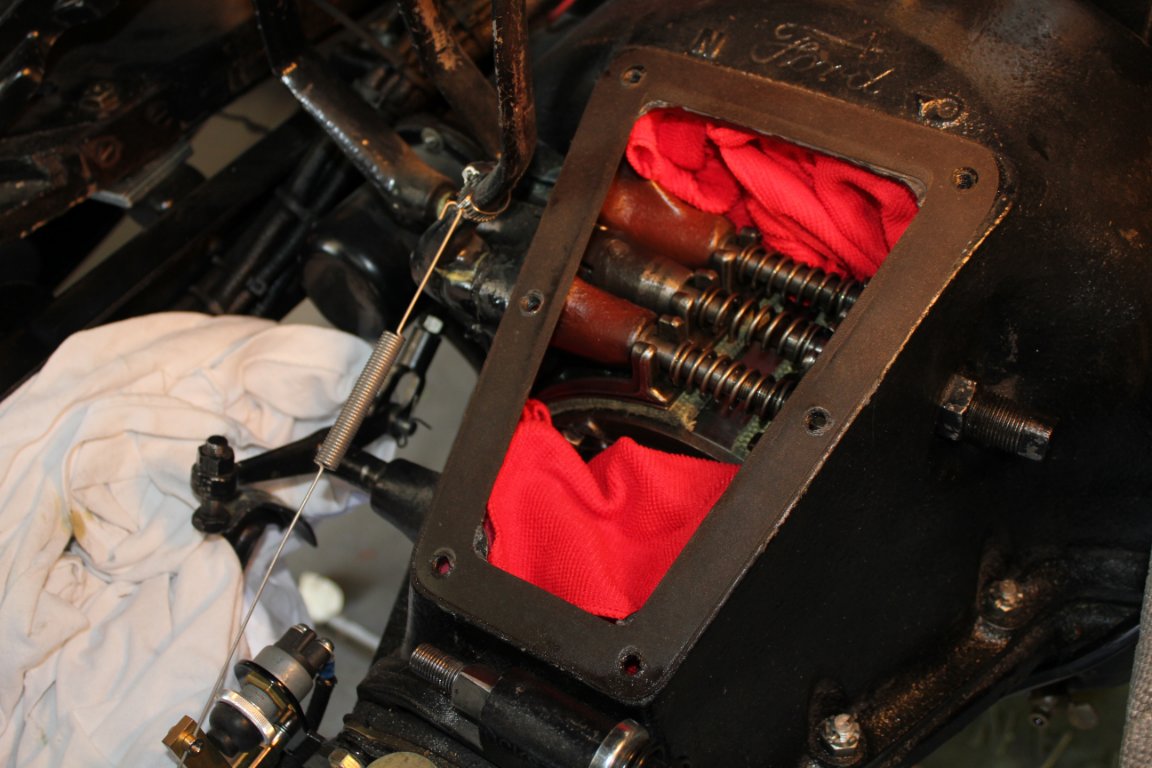

Installed new band springs in the transmission of my '25 coupe with assistance from my son. Been putting this task off for about a year (yes, way too long). Now to start driving in earnest. And we avoided dropping ANYTHING into the black hole.

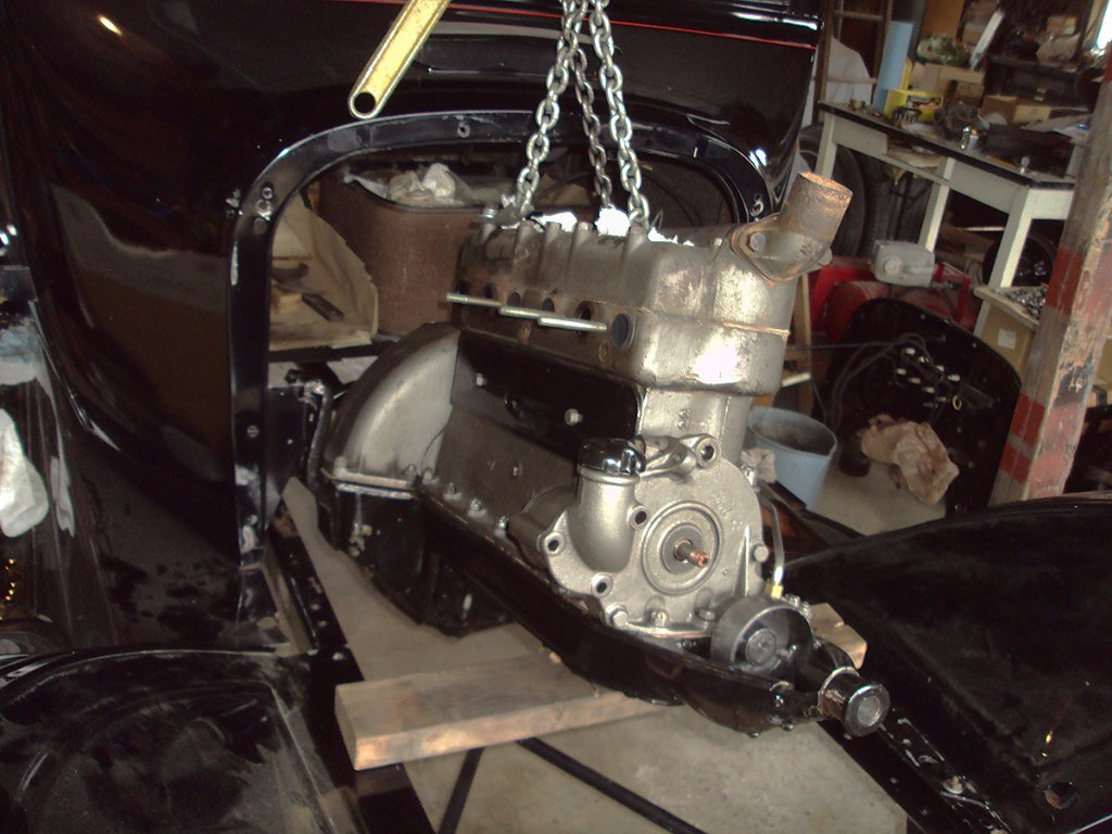

I set the rebuilt engine back into my 26 roadster today.

Took Nellie to a local street rod show, and lots of folks enjoyed seeing an old Ford. There was just one other '23 Ford there, a fiberglas roadster with 350 chev motor!
Anyway got the trophy, there were 51 cars in attendance, and trophy given to the Top 25....woo hoo!
