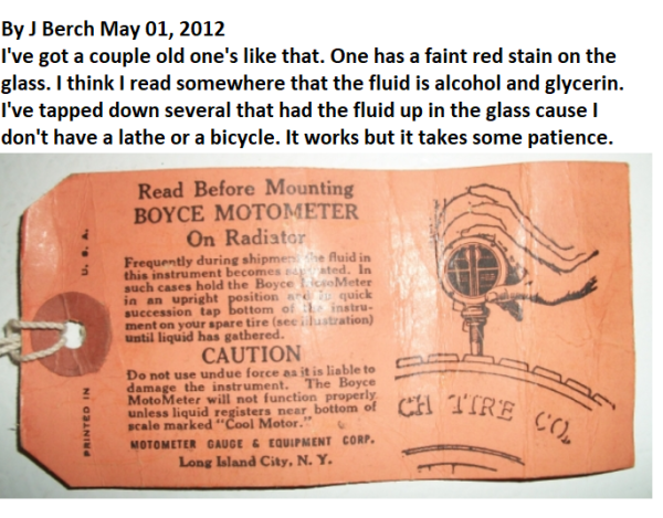

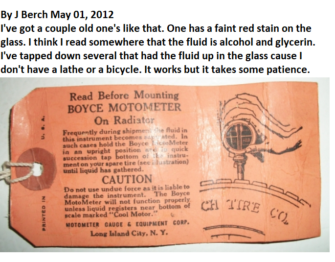

Not sure how old yours is but.. The color in the tube can help identify the liquid in it. Silver liquid indicates that the thermometer contains mercury, while red liquid is alcohol to which red coloring has been added. Both work the same, the heat cause the liquid to expand and rise up the tube when it cools it contracts. Now the question is if the tube is broken or if the liquid has separated.Some have tried centrifugal force. The label says to tap, tap gently - may take awhile.

I have used the tire method when restoring them several times with old originals and it's always worked fine, but it takes quite a bit of time and a lot of effort.

It is possible the thermometer could have burst if it got too hot. The hot liquid has a dye in it, and if too hot seems to be able to stain and dry inside if the fluid blows out the thin bottom of the glass. I have never seen this happen with original Motometers. But I have seen it a couple times with newer reproduction meters.
I have over the years fixed several original meters that had risen and stuck. I have used both centrifugal and pounding methods with success. I have also broken two using the pounding method. Although that was years ago when new replacements were available, so I was able to repair them and make them nice again.
I still have one nice original Motometer that is firmly stuck at the top. Every couple years I take it off the shelf and spend about an hour trying to coax it down, so far without success. It may be possible the thermometer inside may have broken, although the usual confirming signs are not present. And since new replacement thermometers are not readily available anymore, I hesitate to take it apart.
So try some pounding on a spare tire. I usually try a low pressure tire after breaking two of them on higher pressure tires. Or set up some sort of centrifugal method. Just be certain the Motometer is facing the right way and very secure because you don't want it to fly away! (I saw that happen once, amazingly, after ricocheting three times the meter was not broken!)
I have used a bicycle upside down, with the Motometer secured in the bike's rear wheel. Sitting upside down the pedal is cranked to spin the rear wheel. It works a bit better if you add a counterweight on the opposite side of the wheel.
