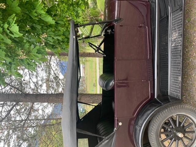

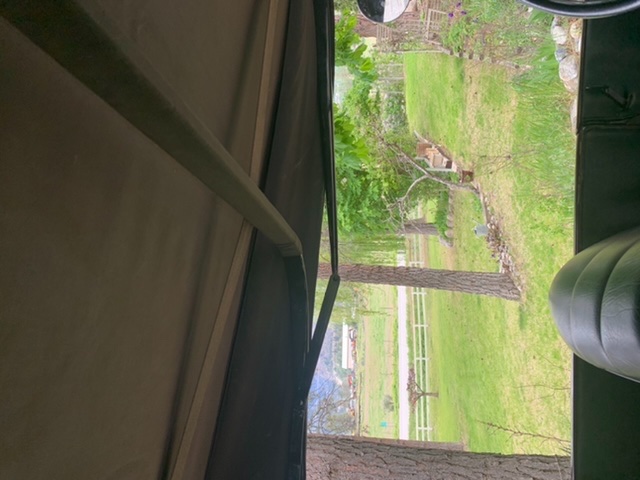

[image][/image]Today was the first time putting the top up on the 26 Touring.
I was able to get the top up but it doesn’t look right to me.
The side brackets are hanging down below the bottom edge of the fabric. Plus the edges of the fabric seem to be loose?
I’m hopping the attached pictures will explain better .
Dave

Re: 26 touring, putting the top up
Post by JohnM » Thu May 19, 2022 8:04 pm
The second bow over the drivers head is not all the way up against the top. See if you can make adjustments and push it all the way up. Otherwise, not all installations are equal in quality. It's not unusual to see the frame on the side from poor installations or older tops that have shrunk.
JohnM
Posts: 747
Last Name: Michaelree
Location: st louis
Board Member Since: 2010
Post by JohnM » Thu May 19, 2022 8:26 pm
I looked again, getting that second bow up will tighten the top and bring the side frame up behind the top. Nice car! I love driving with the top down, but I always put it up for storage, I think it will look better longer.

Post by Dave1 » Thu May 19, 2022 9:14 pm
Thanks guys,
This is a new to me car that had been restored years ago but never driven, think I may wait for a hot day and force the top up, hopefully it will snap into place.
Post by John Codman » Fri May 20, 2022 11:42 am
The top in the OP looks exactly like my '27. If the side bars were to move up, the brackets where the front of the top fit the windshield posts would bind and the back of the pivoting side bars would have to move downward. I think that the position of the bars is correct. I am not going to attempt to change the position on my "27.
