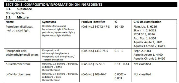

Jonah- decide for yourself. Research the substances below and let us know what value they would add to your engine...

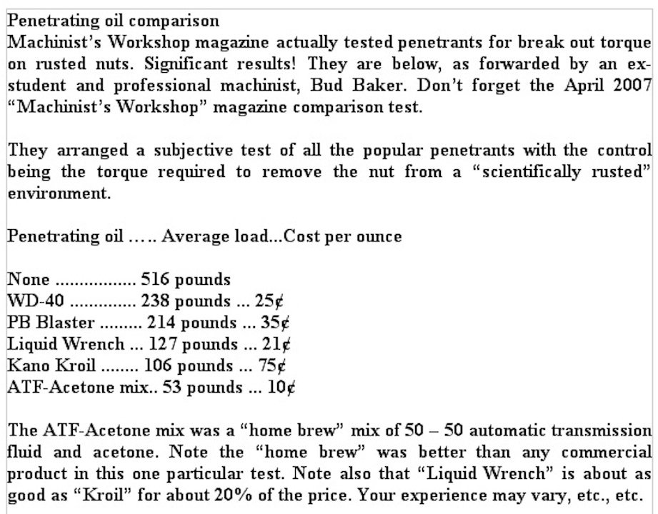

Post by Steve Jelf » Wed May 18, 2022 10:49 am
I've often wondered if Kroil, "The Oil That Creeps", is not also just ATF.
Actually, ATF/Acetone is said to be better.
Posts: 4113
Re: Can of worms officially opened

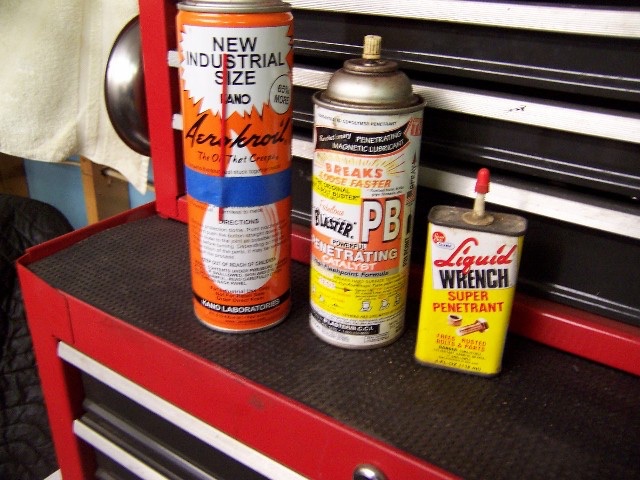

Post by DanTreace » Wed May 18, 2022 12:41 pm
Have seen that test posted before, wonder what a 'scientifically rusted environment' was created?
Have tried that mix of Acetone/ATF and didn't work well. Wasn't what the results I get with Aero Kroil, the Aero comes in an aerosol can, and sure is convenient to 'spray' with the tiny nozzle right where you are working on that 100 year old rusted T fastener!
The mixture had to be poured and just ran off, and the mixture evaporated very fast, even in a jar. Guess if you have the piece apart from the chassis and could soak it for hours, then may be useful to someone. For me, the spray can is the best, can shoot it in any angle, upside down, and get the penetrate to the right spot. Clearing the fastener openings, with a wire brush first, so that the gap between fasteners is suitable for the penetrate, it won't cut through dirt and caked grease.
I'll stick with Aero Kroil, the best I have used over the years on T parts and pieces!

Post by John Codman » Wed May 18, 2022 12:57 pm
I too have seen that study. It should be remembered that WD-40 was never intended to be a penetrating oil. The WD stands for Water Displacement.

From https://en.wikipedia.org/wiki/Marvel_Mystery_Oil
The Marvel Oil Company (also known as Marvel Carburetor Company; Marvel-Schebler Carburetors since 1928) was founded by Burt Pierce in 1923. After World War I, the company produced carburetors for automobiles and aircraft. Some of these encountered problems with clogged jets, prompting Pierce to formulate a blend of chemicals and petroleum to clean and maintain them. Marvel claims the oil creates a top ring seal producing higher compression, preventing blow-by on power strokes, resulting in more power. Supporting evidence is not provided.
The Marvel Oil Company was initially based in Chicago, moved to New York in 1941 and was purchased by Turtle Wax Inc. in 1999, returning to Chicago.
According to the company, the name Mystery Oil comes from Pierce's answer to the question, "what kind of oil is this?" to which Pierce would respond, "It's a mystery!" Composition
According to the company's 2015 safety data sheet Marvel Mystery Oil is composed of:
Petroleum distillates (hydrotreated heavy naphthenic) also known as mineral oil, 60–100%[3]
Petroleum distillates (Stoddard solvent) also known as white spirit, 10–30%[3]
Tricresyl phosphate, an antiwear and extreme pressure additive in lubricants 0.1–1.0%[3]
Ortho-dichlorobenzene, a softening and removing agent for carbon-based contamination on metal surfaces, 0.1–1.0%[3]
Para-dichlorobenzene, a precursor used in the production of chemically and thermally resistant polymers, <0.1%[3]
In an NTSB post aircraft accident investigation published in 2003, it was reported that Marvel Mystery Oil was composed of 74 percent mineral oil, 25 percent stoddard solvent, and 1 percent lard. "N5428H Incident Report Narrative NYC02LA181". National Transportation Safety Board. October 17, 2003. Retrieved March 13, 2016.
Claims
Marvel Mystery Oil marketing literature claims benefits which include improved lubricating qualities, primarily cleaning and friction reduction capabilities. The product has previously been marketed as a fuel additive in all kinds of engines, including aircraft (although the company no longer markets it for the latter application on their website). It has also been used as an oil additive, corrosion inhibitor, penetrating oil, and in automatic transmissions as a leak stopper and seal relubricator.[5] Supporting evidence for claimed benefits is not provided by the manufacturer.
The lubricant was used as a fuel additive in a Lycoming aircraft engine which was specifically cautioned against oil additives (Service Instruction No. 1014M, which also stated its use would void the warranty) which suffered catastrophic damage during take-off. The NTSB listed the probable cause of the accident as "The improper use of [a] fuel additive which resulted in a power loss."
Auto manufacturers Ford and GM recommend against using engine oil additives, stating they are unnecessary in their contemporary engine designs and may void their warranties.
Stoddard solvent
Synonyms & Trade Names
Dry cleaning safety solvent, Mineral spirits, Petroleum solvent, Spotting naphtha [Note: A refined petroleum solvent with a flash point of 102-110°F, boiling point of 309-396°F, and containing >65% C10 or higher hydrocarbons.]
ortho-dichlorobenzene, is an organic compound. It is a non-polar colorless liquid that is miscible in most organic solvents. This derivative of benzene differs from the parent compound by the presence of two adjacent chlorine atoms. 1,2-dichlorobenzene is used as a precursor for agrochemicals, as a solvent for fullerenes, as an insecticide and as an agent to remove carbon-based contamination from metal.
Paradichlorobenzene is a synthetic, white crystalline solid that is practically insoluble in water and soluble in ether, chloroform, carbon disulfide, benzene, alcohol and acetone. It is used primarily as a space deodorant in products such as room deodorizers, urinal and toilet bowl blocks, and as an insecticide fumigant for moth control.When 1,4-dichlorobenzene is heated to decomposition, toxic gases and vapors (such as hydrochloric acid and carbon monoxide) are released.
The primary route of potential human exposure to this compound is inhalation. Acute inhalation exposure to 1,4-dichlorobenzene can result in coughing and breathing difficulties. Breathing high levels of this chemical can cause headaches, dizziness and liver damage. Contact with 1,4-dichlorobenzene can irritate the eyes, leading to burning and tearing. It is reasonably anticipated to be a human carcinogen

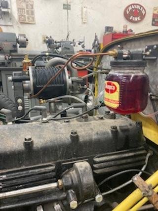

Hi Jonah,
I will see your can of worms & raise you a Ampco oiler to lube the Judson.
Craig.
1922 supercharger1.jpg (30.09 KiB) Viewed 10296 times
Post by Rich Eagle » Fri May 20, 2022 12:53 pm
Where can I get one of those?

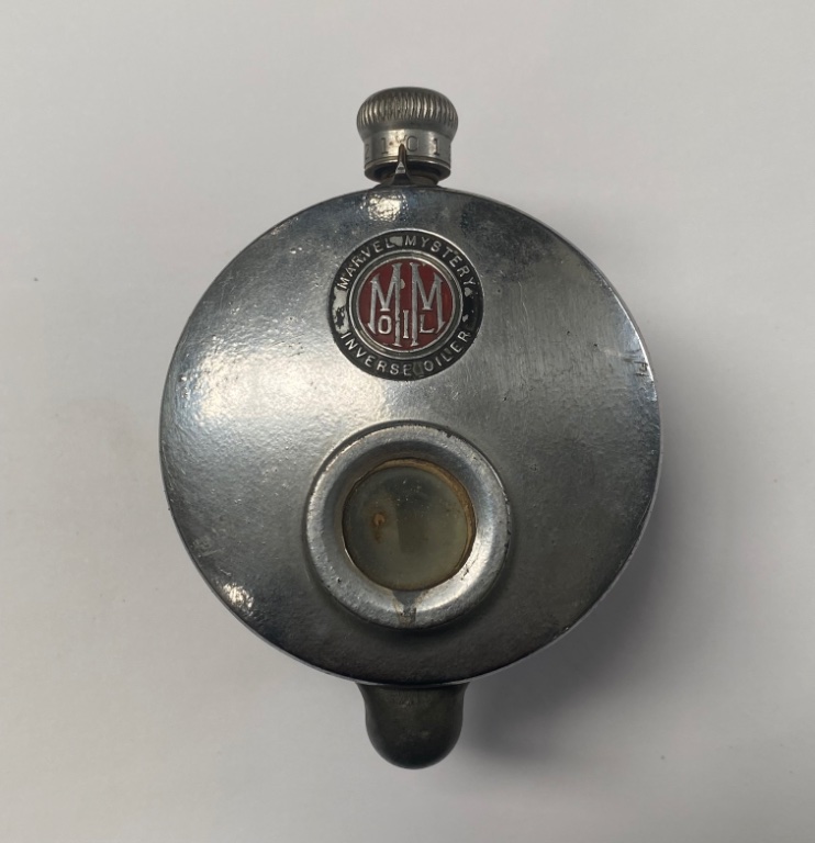

Marvel also sold an oiler, which I believe they called the "Marvel Inverse Oiler".

The dashboard portion of the Marvel Mystery Inverse Oiler…

Rich,
George at Judsonguru has them gdfolchi@yahoo.com They come in the original box with yellowed paper instructions he has a bunch of different styles.
He is very helpful.
Craig.

More info on oilers.
Ampco lubricators LLC George B. Folchi phone (860) 355- 5706 Fax (845) 635- 8442 P.O. Box 1468, New Milford, CT 06776 www.ampcolubes.com
Craig.
