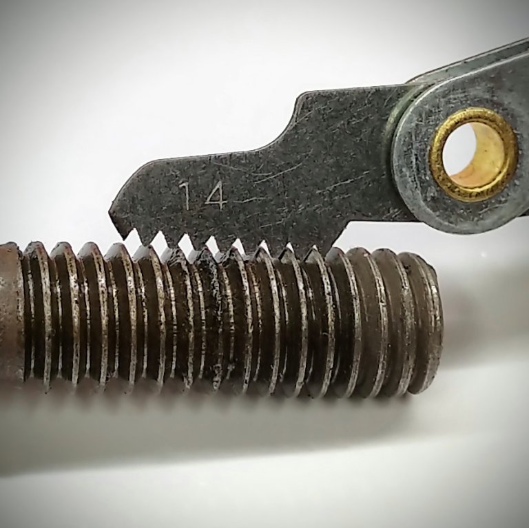

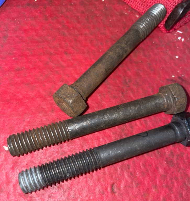

My head bolts are stretched (see photo.) Does anyone use studs instead? Source? Thanks.

I’m going to suggest something…Prussian Blue your bottom tap and run it in again.
I suspect that on that hole you have maybe only 3 active threads left? You can’t have bolts at one pitch…and taps at another…say they are from the same ‘set’…just doesn’t work that way.
When I look at those bolts...the stretch area appears to be in 'air', meaning the clearance area in the head itself and are perhaps the result of something called 'creep'? The shiny areas also indicate just how little thread engagement there really is.

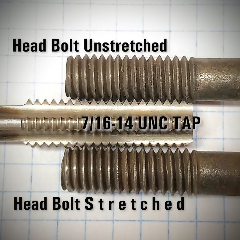

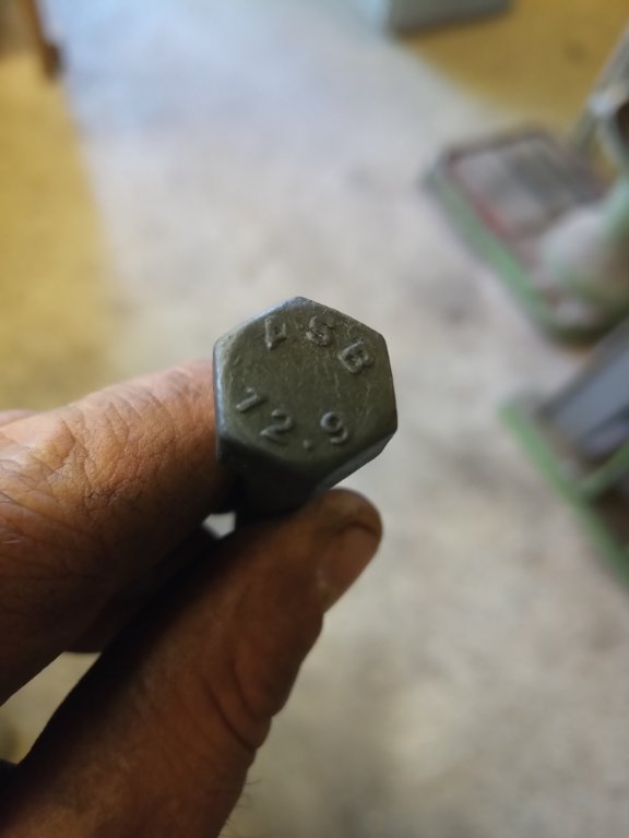

Regarding my photo showing the stretched bolts, as indicated by the thread gauge. The bolt threads that were within the block are fine, but the bolt threads that are above the block show stretch and necking from yield stress. I'm guessing that the tensile stress in the bolt reached yield, likely from over-torque, so it began to neck and yield at the weakest point: the minor diameter of the threads just above the surface of the block.

It appears that the bolt threads below the stretch are rather short. Not a good bite into the block. that adds to the possibility of pulling the block threads. Any idea what the torque was /is on these head bolts? Its clearly 5-10 #'s over max.Flivver wrote: ↑Fri May 27, 2022 6:08 pmAgree and understand. The modulus of elasticity of any grade of steel bolt is nearly equal, so the stretch (tension) relative to torque is the same too. But the strength of the bolt shaft and the treads is a lot stronger in a Gr8 vs Gr5 or lower. So in a battle between the strength of the cast iron internal threads in the block, and the Gr8 bolt, the block will lose.henryford2 wrote: ↑Fri May 27, 2022 5:46 pm..Nothing wrong with a grade 8 bolt if you follow the torque spec. for that size bolt, but it will and can can rip the threads out of the T block before the threads on the bolt fail if you exceed it...

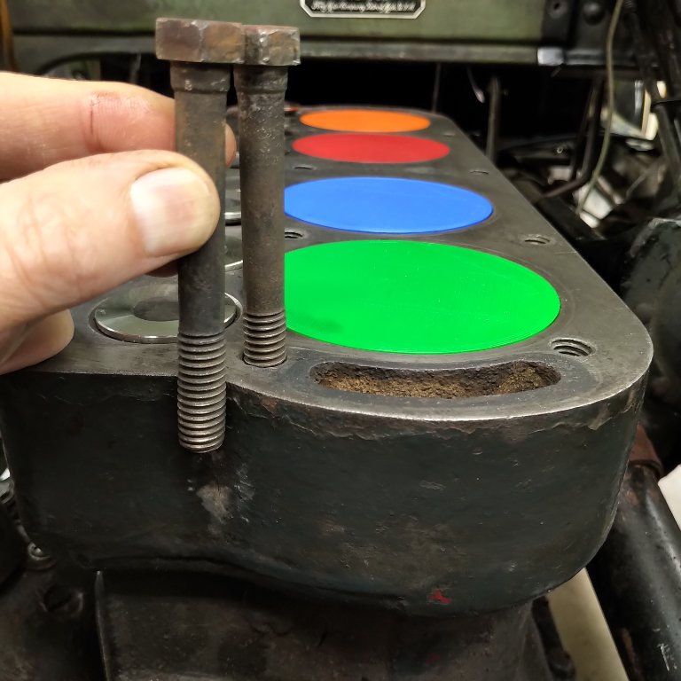

There seems to be some interest, and some confusion, regarding these stretched head bolts. Here is another picture, comparing a non-stretched bolt, a stretched bolt, and a 7/16-14 UNC tap. It clearly shows how the bolt has stretched mid-thread.
Here is another photo showing why the bolts are stretching mid-thread. Notice that when fully installed (this photo is taken with the bolt depth exactly as installed - imagine I just made the head invisible) part of the bolt thread is above the block-head interface. The bolt stretched in the threads just above the interface.
For completeness, these are 7/16-14 UNC x 3-1/4 long head bolts, removed from a 1926 T. I do not know their origin or what torque they were tightened to. (first time I have had the head off of this new-to-me car.)

They look like Ford V8 head bolts.

To my eye, both bolts matched to the tap are stretched at almost the same amount. In the length of thread each is stretched about 1/2 a thread. If you clean out the holes in the block, how much further can the bolts be screwed in?If you can get another 1/8" into the hole, you will have much better engagement. That will require longer bolts to maximise the depth of the bolts and lessen the chance of stripping the block.
- Posts: 4057
Re: Head Bolts Stretched - Studs?
Yes, that is the issue, you are re-using old bolts of unknown age, conditions of use like heating cycles, thread wear, oxidation, and other issues of old bolts.
The best policy for reducing breakage or thread pull out in the cylinder block is to use new bolts.
Here's photo of a new bolt (lower) and old used bolts, note the old bolt above the new one, it shows similar distortion. When tightening a head bolt, it will deform slightly, as the head of the bolt is fixed on the cylinder head, and when tightened down, the pull of the block threads will stretch the bolt some. More will happen with re-use too.
(Tad of anti-seize helps prevent a stuck bolt and risk of broken- off one, over long time engagement)
And take care not to use too much torque on these 7 /16" x 14 head bolts. A good pull with the Ford head bolt wrench will do about 40lb/ft, that is usually OK. Proper sequence of final bolt tightening, beginning first in the center of the head, then working out to the edges and ends for best gasket seal is likely more important than any torque values!
If all the extremely good, cleaned and flat surfaces, new head gasket, with a re-built engine, and all block and head cleaned and good condition bolt hole threads in the block, going up to under 50 lbs/ft ,in that aged old block, may be done. Anything after that is a risk IMO>

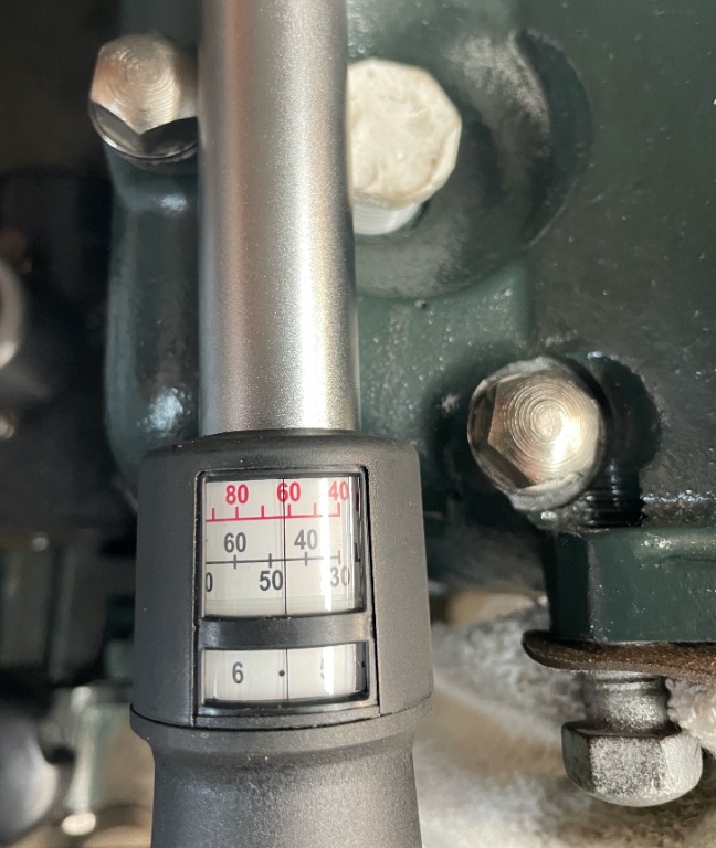

Hello T friends. I'm totally new here and making my first entry. Please excuse my bad language as I'm from Switzerland.
I'm following this topic with interest. I bought one a few months ago as a new Hobby Touring 1926 which I now want to get fit again. The head was dismantled and some threads torn out. I repaired this with Time Sert.
But then I was very surprised at the brief engagement of the cylinder head bolts in the block and then I discovered a number of posts about this problem in the forum.
So I rethreaded the block down to the bottom of the holes and got new, longer head bolts (I think these were from a Ford Capri).
These screws now grip 0.87" (22mm) in the engine block.
But they have a strength of 12.9! Is that too strong? Do I have problems with that? Thank you for your opinion.
Hi Newbee!
Just very, very light coat of aluminum anti-seize and torque to the the specs.
When replacing head bolts, grade 5 or grade 8.., do NOT forget to chase all new bolts with a die. #1 failure is a flaking of coating on modern bolts, which in turn cause an inaccurate torque. Don't forget bottom tapping the block too!
Hank
Hank
Thanks for the feedback
Some time ago I installed the cylinder head and the screws as you described. To look authentic I lathed the screw heads and painted them black as shown in the pictures. Thanks to the longer screws, I now have a very good grip in the engine block.
My only concern is the tightness of the screws. As I further informed myself, the European standard 12.9 is stronger than grade 8. I hope that doesn't cause any problems with the threads.
Greetings from switzerland
Flivver
Topic author - Posts: 210
- First Name: Steven
- Last Name: Park
- Location: Paris
I really like what you did with the heads of the Class 12.9 bolts. Nice!
Flivver, Paris Ontario CANADA
@flivverchannel
@flivverchannel
jiminbartow
- Posts: 2469
- Last Name: Patrick
- Location: Bartow, FL
If you don’t have a lathe, you can get the same results with a drill press and sandpaper. I have done it plenty of times to remove modern markings from the top of hex head bolts. Jim Patrick
I’m a bit curious about the 12.9 grade screws, as all I have ever seen in 12.9 is metric thread hardware. The Ford blocks I have encountered here in the states are threaded 7/16”-14, are globally produced variations equipped with metric hardware...? Metric grade 12.9 is basically equivalent to grade 9, and are common grades for all socket head fasteners.
7/16”-14 (.437” x .0714”) is close to M12x1.75 (.472” x .0688”), is it possible that this block was tapped out to this slightly larger size...?
Hi
No, they are the original 7/16"-14 threads in the block.
When I looked around, we often found inch screws with a European standard. I could imagine that these screws are made in Europe and are therefore labeled with the European standard.
The Ford Capri from which the screws come was produced in Germany.
Greeting
Greeting
We learn sumpin new everyday...!
I probably shouldn’t be surprised that the bolt grades are cross pollinating, but so far this has been my primary method of sorting hardware. I’ll have to watch closer...
