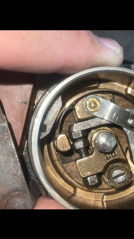

The points seem way off according to the instructions. When the points are at the middle of the cam, it looks like they’re almost open 1/4” (not a good guess but to express the difference). Instructions call for .4mm. I just wanted to check with y’all I’m sure someone on here knows way more about them can give me some advice. Is the points indeed supposed to be .4mm? I also need to gap the plugs I removed from the engine when I first got it just for testing purposes. I’m running new plugs now which I’ll also have to gap to .18”. I’ll include pic here of what it looks like and my feeler gauge:
Followed the original assembly instructions, but I’m not getting a spark when I spin it at the plugs or in the safety spark gap area. I’m doing it by hand with spark plug wires connected to plugs on table. In manual, with everything disconnected I still should see something in the safety gap.

Jacob, that points set MAY have had the red fiber replaced. It was many years ago, and can’t remember my name some days. I’ll take a pic of another set here later and post. You may be able to sand and polish that down just a bit to help. Yes, gap looks way too big to me.
- Posts: 5148
Re: Bosch Mag question

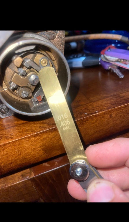

There is plenty of movement in the adjustable point. Undo the lock nut & close the gap. If I remember correctly the gap is .016"
Doing the math to your .4 mm equals .015748". aprox .016"

Thank you! That’s what I’m going to do, just wanted to check!speedytinc wrote: ↑Sun Jun 05, 2022 2:35 pmThere is plenty of movement in the adjustable point. Undo the lock nut & close the gap. If I remember correctly the gap is .016"
Should I still get spark in the safety gap though? Or do the points need to be set correctly for that too?

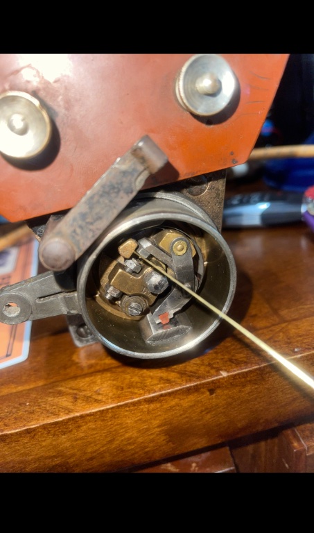

I was just suggesting the safety spark gap as it was a means in the manual to test for function. It said if it was installed on vehicle, to remove all wires and ground, and turn engine over briskly and you should see a spark in that area if functioning correctly. I don’t want to mess it up so definitely will avoid that!

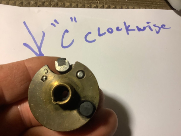

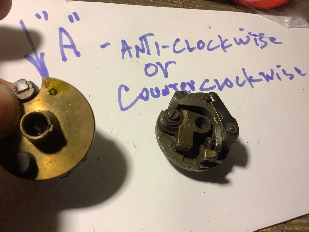

There are no rotation arrows, but it seems that it is a clockwise setup for the Model T, with an anti clockwise points set, (since it turns opposite from the gear end). When assembling, I made sure to line up the timing marks, C for clockwise on the distributor gear with the dot on the shaft gear. I tried following the manual as close as possible. This is the manual I used: https://oldcroak.com/magneto-service-ma ... osch-1928/

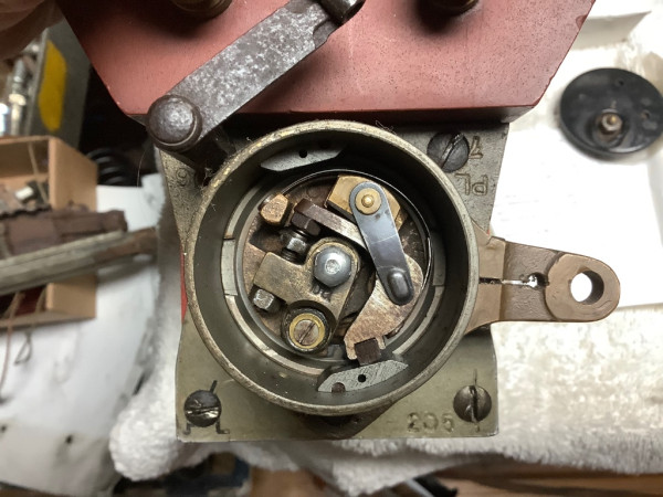

And here is the pic of the timing assembly part, I basically matched the picture (on the left since that’s the point plat direction I have):
I’m at work now so I was unable to adjust before leaving. But with everything how it is now, turning the shaft and if I touch the end where ground wire goes to switch you can feel a tingle…but I’m barely turning by hand. Once I adjust points I’m gonna put a socket and long ratchet on it and spin it quickly with the plug wires and plugs connected. Unless it needs to have a ground connected then I’ll figure that out for countertop testing. I switched out the armature as the collector ring was broken on the old one, but it seemed to fit fine (not to mention a lot cleaner). Lol

you are grounding the plugs "setting on the table" back to the magneto?

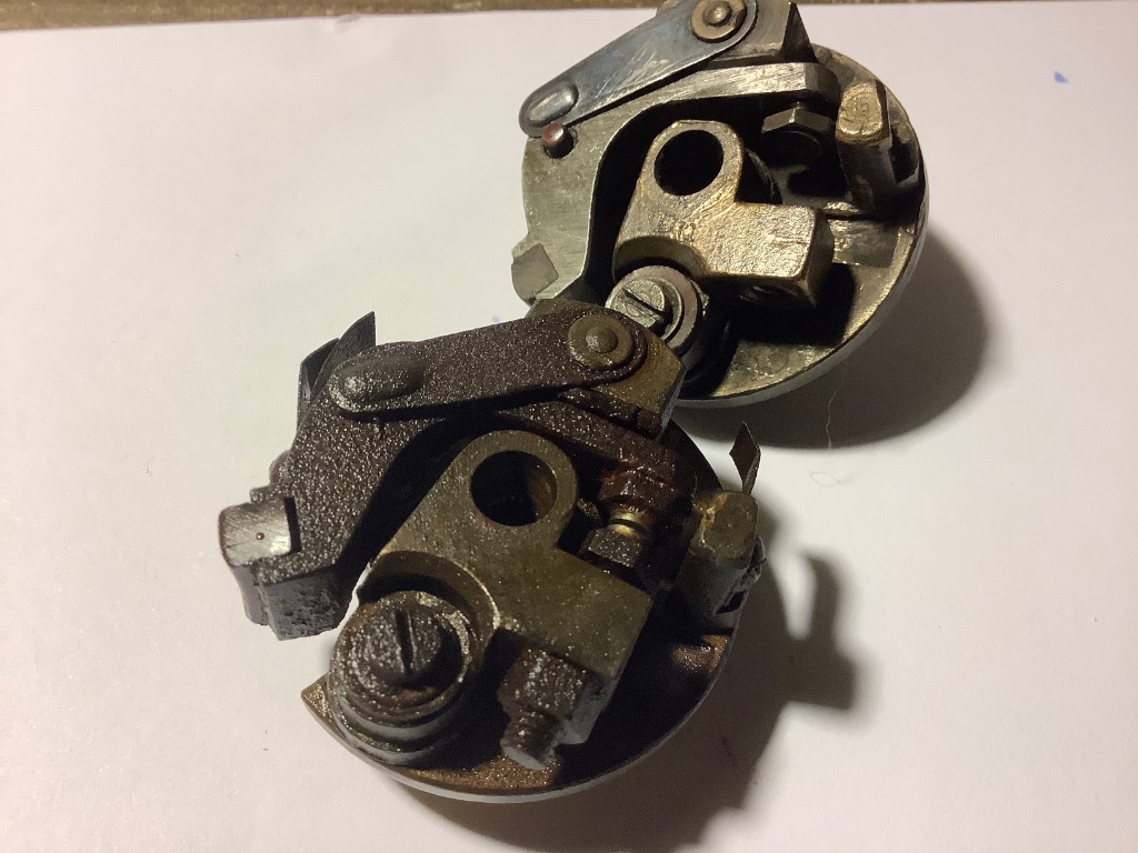

This is the points set for the side drive like yours or the cross shaft front drive eismann, matco, Columbo, others. “ C” denotes clockwise…..** note the gap, ****

This points set is for the 3 gear splitdorf aluminum front plate with mag mounted shelf on the side. NOT YOUR STYLE …… It’s marked “A” for anti clockwise or counterclockwise. Points are interchangeable, so never pass up a junker, it may be low mileage and have some good usable parts.

DISREGARD ANY STAMPED LETTER(s) ON THE front side of the points set…..the C and A are stamped on the backside where I’m pointing. Yes, it’s confusing, but you will soon be an expert, and amaze and thrill your friends and associates with a great ignition system! Let us know when you pee your pants!

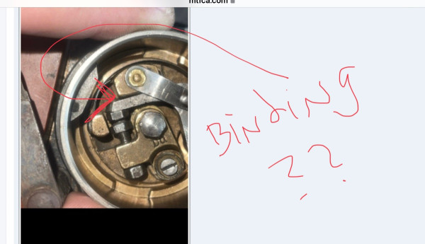

Thanks guys for the info. Perhaps grounding is indeed the issue “on the table”. I set the points as close as I could…my gauge wouldn’t fit…and I don’t have a small enough wrench
, but I think I got it close. See here:
As you said, can’t really see the gap this is at maximum lift.
Attached a wrench to back of mag, and put wires and plugs on it on table…nothing. However, turning slowly by hand…I was brave/stupid and grabbed the grounding stud where switch would attach, and I could feel a tingle. So I guess I just need to put a wire on that to a ground…and THEN I should get something…I think lol.
It’s definitely not “easy” to turn…idk if inbetween the poles if it should basically free spin but it doesn’t. That’s also trying to spin via my fingers on a small nut on the shaft lol. Think I’m making some progress, getting close.

Ya Gotta get a wrench and feeler gauge to work. There are small ones out there just for Bosch that have a gauge attached to them, but in the meantime, just grind what you have shown above so it’ll fit( unless an heirloom piece or sumthin sumthin. Small vintage craftsman ignition wrench sets are all over the place. Good to have some to choose from and keep the best one with you, maybe on your keychain. . I have a favorite old tiny box wrench that has the perfect angle to it. I think it also fits the points plate bolt. As the red fiber wears down you should check and reset but it takes a looong time with regular light oiling. Also, there are different thickness’s of the platinum points sets. Looks like your fixed point is getting pretty thin.

If it’s binding here at all, perhaps the red fiber needs sanded and polished down a bit. The color of it tells me it likely has been replaced. Check that out.

Nah the arm isn’t binding, there’s still some room for it to move but where I show now is maximum open.
