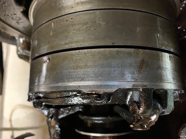

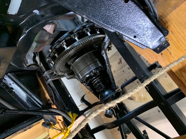

I noticed a bit of scoring on the brake drum that I didn’t seem to remember.  Not having any idea of the history of this car, and supposedly not run for 50 yrs before I bought it I figured I better take it off the road put new linings in.

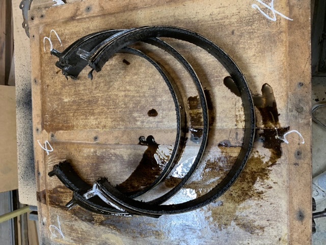

   So I bought a set of Kevlar bands and decided to get the job done.  This afternoon I pulled things apart and got the bands out, and wouldn’t you know it, the low speed and reverse bands look virtually like new, and the brake band has at least half its thickness left.
    I have no idea what made the little scores on the rear edge of the brake drum but it certainly wasn’t the band.
    Now I’m in a bit of a quandary, why replace linings that are in fine condition with good life left???
    I suppose I will change them out anyway, I already have them, and will never have to replace them again.  There is just something about changing out parts that are perfectly serviceable and have good life left that just goes against the grain.

I see no scoring on your drums...
while the hog's head is off, give very serious thought to analysing the condition of the neutral notch and the pedal support, as well as the condition of the brake and reverse pedals' ramps and supports. There should be almost zero "dead band" of (reverse/brake) pedal forward movement before they start sliding sideways...Neutral should have enough "dead band" to release the high speed clutch, with plenty of sideways motion left to cinch up low band. Search out and study posts which discuss making bands round as well as how to properly attach band material. If you are going to Kevlar, things must be absolutely "as new" (or better) or trouble will haunt you like you can't believe.

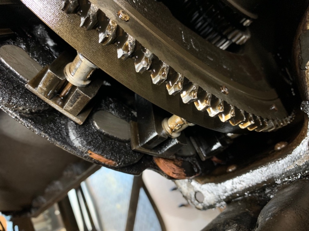

Starter ring gear is a bit sad as well, time to start a savings piggy bank for a major rebuild in the up coming future.

Pedal cams are to often overlooked. Learned the hard way. Now I strongly consider the cams on any removed HH. Relatively cheap & can keep a fellow from over adjusting bands. Very critical to kevlar use. Typically when a HH is removed, I do some pedal shaft leak sealing anyway.
First thing I noticed was the ring gear teeth. May be an optical delusion, but look hard @ them. An economy fix is to turn the ring gear 90 degrees to use the better teeth. These motors seem to stop in the same place. Another economy fix would be to switch the brake & reverse bands.
Not saying I endorse "economy" patches. To me the act of tearing down a motor outweighs any savings in cutting corners. I value my time more.
