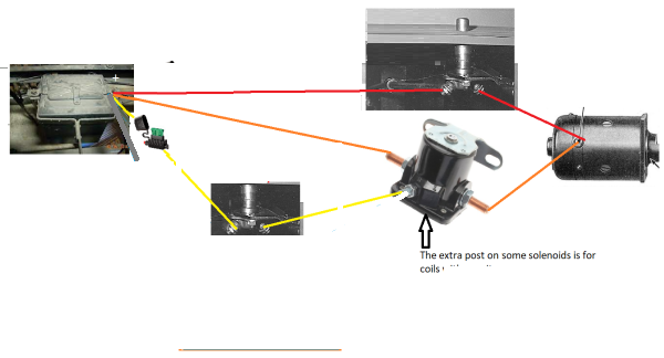

If the starter never worked maybe its the starter
How is it wired - where do all these wires go

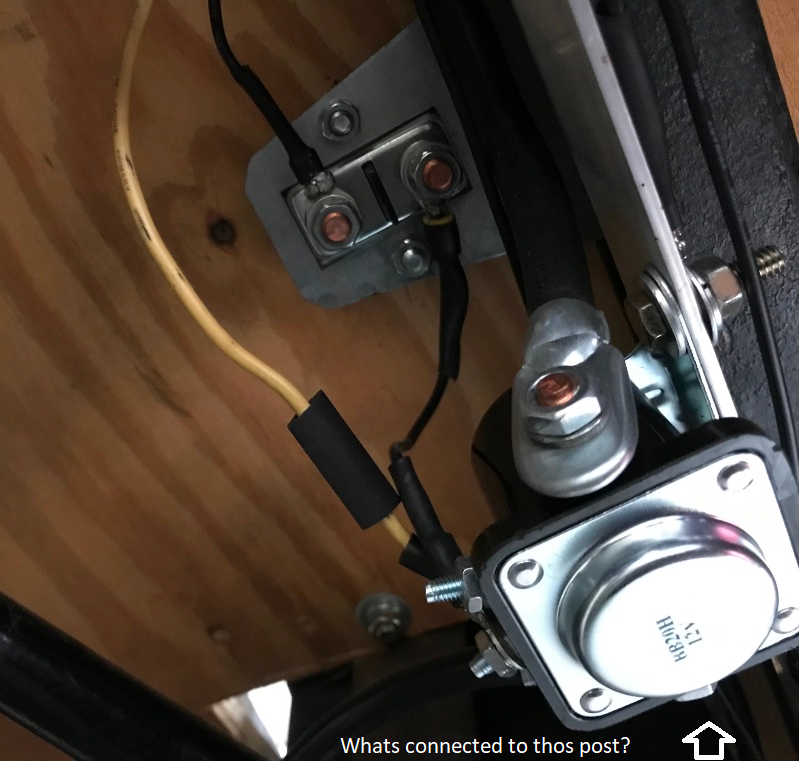

The modern 12 V solenoid has 2 small terminals. They are usually marked "S" and "I". Which one of the small terminals is your starter switch connected to? Does the solenoid give a sharp click when you operate the starter switch? // One of the large terminals on the starter solenoid should be connected to the battery with a heavy battery cable. The other large terminal on the solenoid should be connected to the starter with a heavy cable.

I'm as lost as you. You stated that with the kill switch on the truck starts and the lights work. Starts with the starter or by hand cranking? Am I correct there are two wires to one small terminal on the solenoid? Is the solenoid a ford style? Some solenoids have a small terminal to activate & the other is a ground, that type will not work with only one side hooked up. The ford type if you hook to the "I" terminal it is connected to the off side of the to transfer 12vdc to the coil when cranking. is the Kill switch on the + side and are there any other wires on the + side of the battery? By connecting the starter direct to the battery does it crank?
