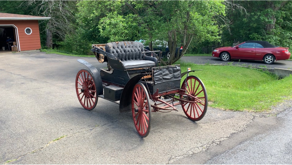

From Coast to Coast
As luck would have it - I am in Erie.
I picked up this Sears 1910 High Wheeler
this morning in Jamestown, NY.
I am headed west on I-90 to Joliet, Illinois
where my next pick up is - but I am in no
hurry - I have room in my enclosed trailer
for a Model T - if your friend wants it
trailered to Piquette or wherever your
next stop is to get demountable wheels
he can catch a free ride ….
I will wait around in Erie until 7:00 pm.
FJ
260-804-6695
FJ
260-804-6695

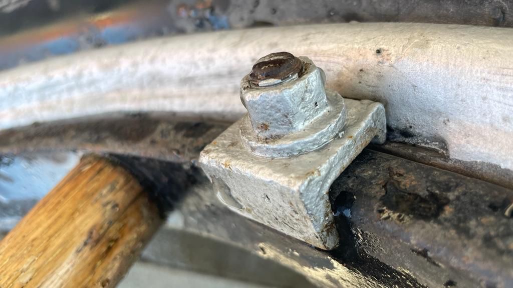

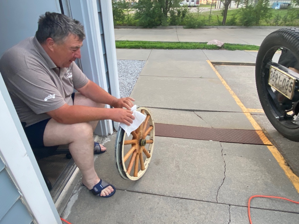

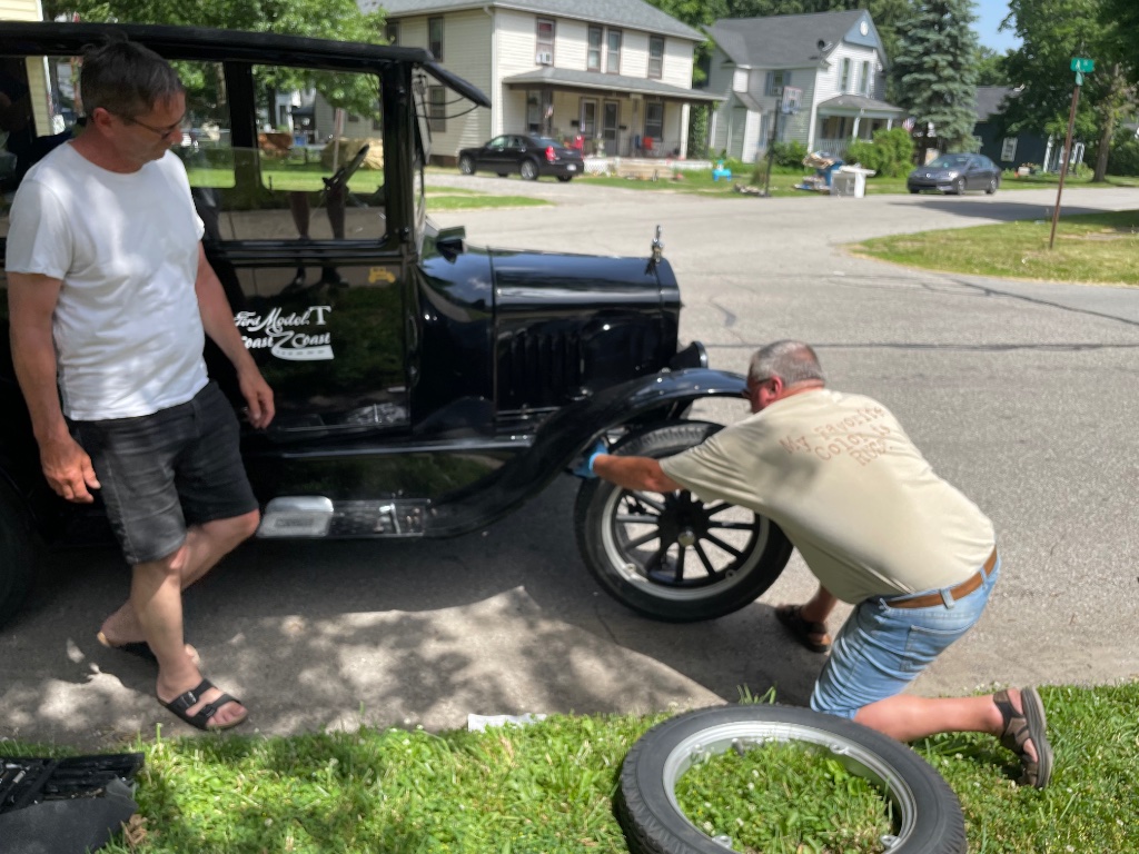

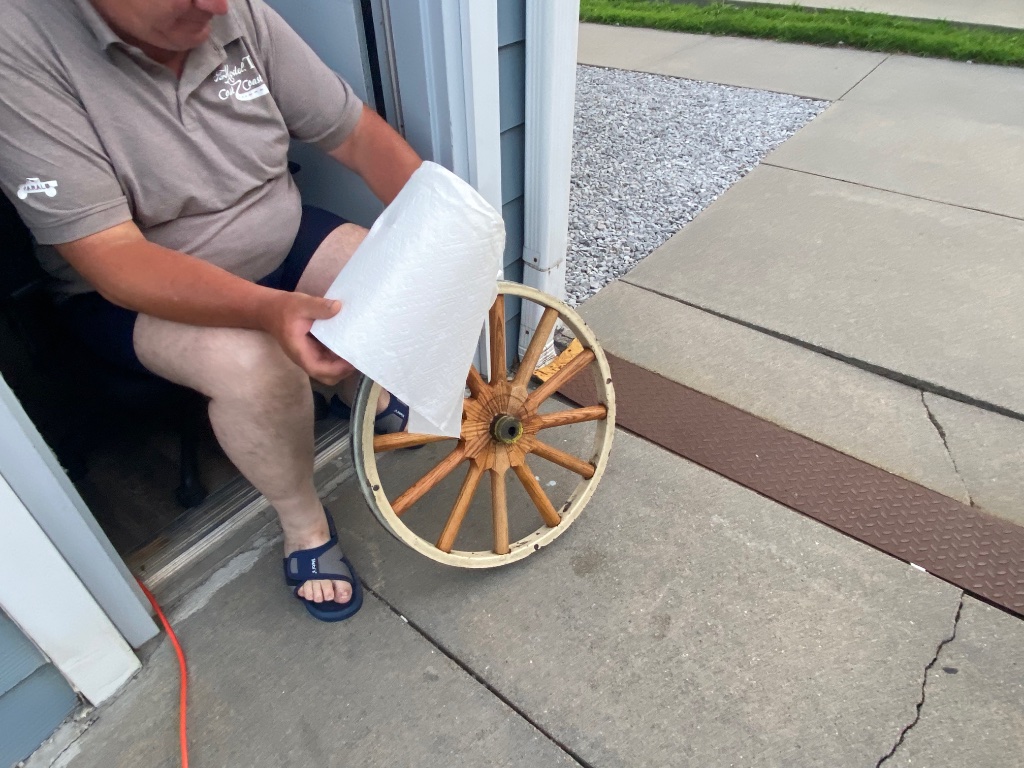

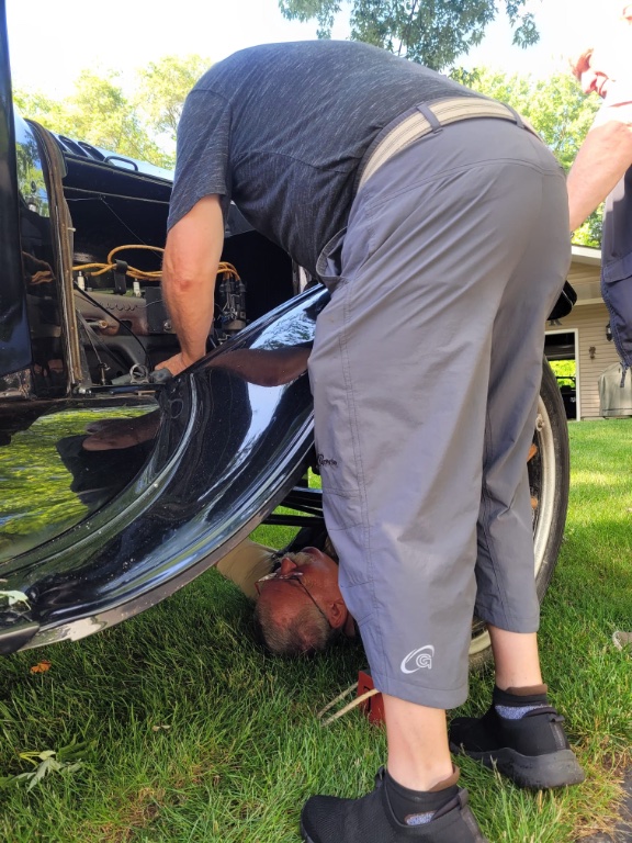

I try again to post Haralds wheel after his repair of last night
- Posts: 4388
Re: From Coast to Coast
Wheel doesn't "look" too bad. However, IF the tenons are wearing undersize? Which they undoubtedly are. It could become very dangerous quickly! And without a close examination? It may already be dangerous.
I really wish I were close by. I would love to spend an hour with that wheel!

Steve do you have access to any Kwik Poly that you can get your hands on before meeting the group? Give me a call, Best John

ON the leaky block it is a 26-7 block very common crack, go to local parts store and look for a product called irontite it may seal a small crack but you need to run water instead of anti freeze to make it work. It is not a permanent fix but it will get by, I would find another block some day and do it right.

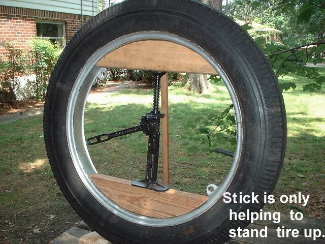

Looking at the wheel, I'd bet a spoke jack and some shims would put that wheel right for the rest of the trip
they almost look like Oak and if they are, should be replaced after the trip regardless of how tight you can make things with shims

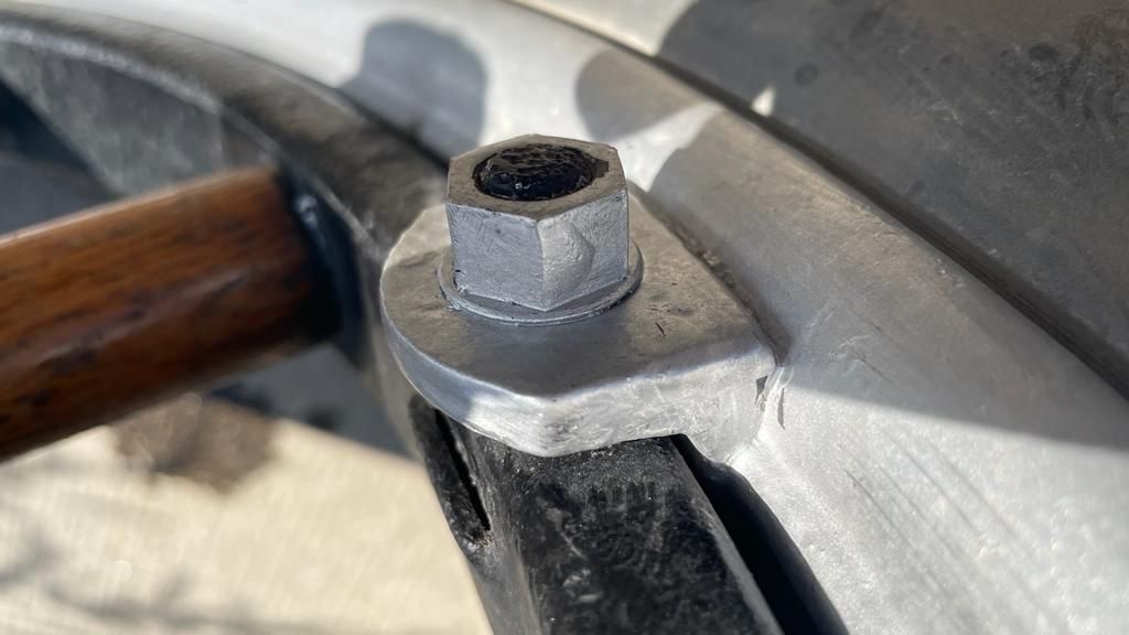

I have made shims as described with a spoke jack to tighten a set of wheels for a "hot rod" centerdoor some 25 years ago. This is a 60+mph car. Those wheels are still in service under much harder use than a typical T. A shim job can be very effective.

The Alpen Chapter arrived at Piquette today right on schedule.
We planned out their visit - first priority was getting the wood-spoked wheel fixed.
This photo shows Harald and Stephan finishing the installation of a new wheel in the left-rear of the car. Piquette had a spare demountable wheel that filled the bill.
I saw a post from earlier today regarding the appearance of the spokes being oak - I think this is likely true. Spokes should be hickory as many of us know. More scrutiny is needed.

Like Scott Conger, I think a spoke jack and several shims would hold that wheel for quite some distance. Anything, even glue, that limits the motion between the worn wooden pieces and whatever they are next to, will slow down the wear and probably extend the safe usage of the wheel. THAT being said, I do not like the use of glues between spokes and whatever they are against for one big reason!
I often say wooden wheels are much stronger than most people think they are. But it goes beyond that simple statement. A major part of that strength is in the resilience of the wheel, in other words, in its flexibility where it needs it. Glue between the felley and the end of the spoke creates a hard interface that can actually cause a spoke to snap off instead of giving that tiny amount it needs to for its resilience. Glue between the spokes and the hub can also create a rigidity that can result in a break rather than a give when needed.
I have used steel shims around worn tenons, with a small amount of tough glue between the shim and the wood. The glue can there fill minor flaws in the wood to reduce working wear, while no glue between the shim and the steel felley allows the flexibility needed for the wheel to take on the shocks and stresses of rough roads.
The other big issue with glue is that the vibration and stresses will eventually break down the glue one way or another. This is especially true where leverage tries to twist or pull between two larger pieces (like a spoke and a felley?). As pieces are forced to move where glue holds them tight? The glue will pull material around it apart, resulting in weaker material. Having a steel shim with glue on only one side maintains the flexibility while at the same time filling voids that would otherwise weaken the wheel and allow faster wear.
Now looks like you are all set as far as the wheel goes!

Just as a suggestion after enlarging the photos it appears that the spokes on the other wheels of the car may be the same type spokes. I realize no one really wants to make a huge investment for Hickory spoked wheels but while you’re in the states you may consider buying a set from someone and placing them on the car before being shipped back home. It would take the expense of buying them and having them shipped later plus any VAT THAT MIGHT BE DUE. Just a suggestion. I hope all are having a good time and will continue to keep us posted as we live vicariously through you.

6th day, 12th June 2022, from Perrysburg via Detroit to Ann Arbor with no technical stop.
After we drove through the Ford estate we arrived at about noon at Piquette Avenue Plant.
Steve already informed you, that the defect wheel could be exchanged by our very fast dream team Harald and Stefan, Then a great tour with very interesting information about the Plant, the Cars and Ford Motor Company followed, with some brand new secrets
and many photos.

Bernhard, please be sure Harald uses hickory spokes from one of the vendors. Any other type wood spoke will not be as safe. Again he could place an order now and have them shipped to a location here in the states if you perhaps contact a member that would be willing hold them for you until you arrive at that destination. Then simply ship them back with the vehicle.

Day 9, 15th June 2022, on the last 30 miles extremely windy.
Today we followed Heike on small streets to Silver Beach, St. Joseph, Lake Michigan, for a break at the beach.
Then we followed state road 39 to the south and took US 8 to the West.
We had several technical problems: Peter’s Fan Belt, Gerhard’s contacts gone, then a fuse. Reiner also had a flat tire and 10 miles before we arrived at the hotel Gerhard also had a flat tire and a second burnt fuse.

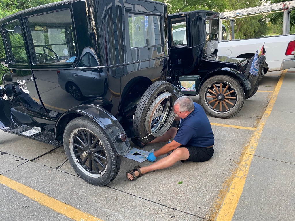

When I changed the oil the second time after driving 2.000 km, I noticed that one of my tires looked not Completely full. Just 2 instead of 4,5 bar. The valve had a leak. I changed not only the tube also the very old tire.
Reiner could not change the leaking tube, as we have no wheel spreaders with us.
Tomorrow we plan to visit the Model T Museum in Moline, maybe there is a wheel spreader…
On the way to Moline we’ll follow the advices, which I received yesterday and this morning.
Thanks for the awesome support.
Here some photos

Day 11, 17th June 2022, from Princeton, Illinois to Kalona, Iowa, about 224 km 140 miles.
Hot as the last day. Just one short technical stop, as Peter‘s Fan Belt got lose.
Today we met Frank, Craig and his wife Nancy at Craig’s private museum in Moline, Illinois. I never saw so many very early extremely well restored Model Ts. The cars, the museum and the cemetery were fantastic and we spend much more time there as planned.
Frank, many thanks to you that you arranged that for us and thanks to Craig and Nancy for showing us their museum and for drinks und snacks.
We crossed Mississippi River in Muscatine and drove to the West on 231 and later on 22.
During a coffee break in Kalona, we decided to stay there, as two of us were in the need of changing tires.

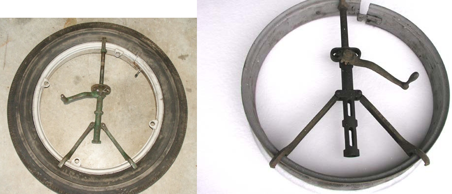

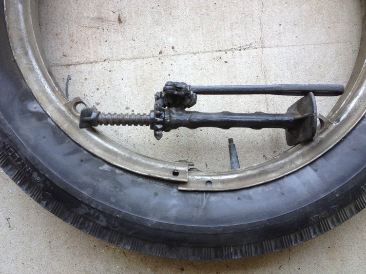

That took much longer than expected and it didn’t work for Reiner Split Rim. Even the Rim Spreader, which Frank left Reiner, could not help.
Now we need an advise or someone how knows exactly, how to use the spreader. Without the tire we could fit the rim correctly, but with the tire on the rim, we could not fit it in the right position. Any help/advise is appreciated.
Here are two photos. Plans for the next days
Tomorrow we want to pick up some parts at Birdhaven, but they do not have tubes for us and no motormeter for my car, which I need to recognise early enough, that my car has a problem, but other parts are available.
Then we should reach Omaha on Sunday Late Afternoon.
The visit to Speedway Motors Museum is now planned for Monday, many thanks and apologies to Laura, Rick, Rob and Bob, who helped us with that, and the timechanges.
CU Bernd

- Posts: 6552
Instructions
By Dave Roberts October 16, 2007
Then, when mounting a new/repaired tire, turn the spreader assembly 180 degrees so
the 2 swing arms are at the 2:00 and 10:00 aspect and the 'bird beak' arm at 6:00. When you
crank the handle, the 2 ends of the split rim should easily glide over each other and lock. --
Other instructions and methods
- Posts: 4388
From the picture you show of your (friend's?) rim? It appears the end is bent a bit sharp (doesn't take much!), causing the ends to not come together as they are supposed to.
Model T 21 inch split rims are fairly soft (a lot of other era cars using split rims are much tougher!). On the one hand, they are easily damaged by misuse of the rim spreader. On the other hand, they are fairly easy to put back to right.
It is a bit tricky, and difficult to explain. I usually draw or cut a careful representation an undamaged arc of the rim to check against the damaged area. Then using the representation to determine how much and where the rim needs to be tweaked. The Ford rims are soft enough that heat is usually not needed, and often not desired. However, a small block of wood (or?) that fits inside the rim between the rim sides is almost necessary to prevent kinking or breaking the rim. Using some sort of heavy steel framework, wedge or clamp the short end of the rim beside the bent spot, and pressure (just arm strength!) the rim back to where it belongs, regularly checking the arc against the representation.
It may not be necessary to go to all that trouble? IF the rim isn't too bad, careful use of the rim spreader MIGHT be able to force the rim into position for the latch to work. The Ford rims are soft enough that that can often be done.
A bit of a tale. Just about a month ago, I ran into this very problem for my 1927 Paige. I needed to mount a better tire to replace an old one that was ready to fail. I did not notice that the rim I grabbed had a similar tweak as your rim. I started to push it in place with the rim spreader - - - - and it wouldn't line up. I tried every trick I knew with the rim spreader. Then I cut a couple 2X4 pieces of wood to fit the rim (another old trick!) and used a jack between them. I fought that stupid (WHO's stupid????) thing for more than two hours!
The Paige rims are a bit tougher than the Ford rims are. It required a torch. But in ONE hour, I had cut an arc representation in sheet steel (I wanted accuracy!), clamped the rim onto an anvil, heated it where it needed to be shrunk, and pushed it to within spec. Once the paint dried, It took fifteen minutes to mount the tire.
A straight rim makes all the difference.
- Posts: 6552
Arced wood and jack as mentioned above http://www.mtfca.com/discus/messages/29/37596.html

This morning we checked the spokes of our cars, we have two additional wheels with loose spokes. Maybe somebody could offer us to sell usable wheels on our way west to Omaha, Lincoln, Norh Platte to Mount Rushmore.
One for me and one for Reiner. Any help appreciated

And I further recognised today, that one rim has different holders/brackets, that means I could not use my spare wheel, if I get a flat tire there.
Could someone offer me 4 of those brackets? On the right side in the front I have a different rim

Unfortunately these things were not recognized before you arrive in Moline. Craig has wheels and I have the lugs (holder/brackets) you need.
The issue you may have is improper mating the manufacturer of the wheel felloe with the rim. The lug does not look correct for the rims, they may be on the wrong wheels. Someone needs to verify --
There are many styles of lugs to fit different wheels

My rear wheel spokes are to try, 5 of 12 are lose on the left, 3 on the right.
This night they take a bath
, hopefully that helps.
Reiner and myself still searching for intact wheels.
