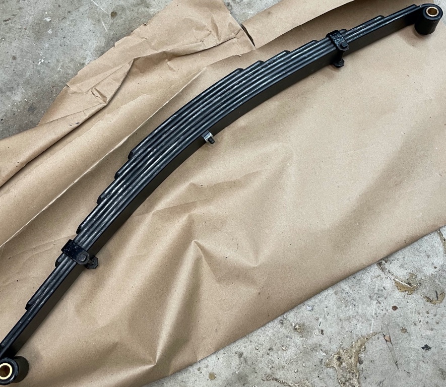

You may use this as base line, just purchased a new Front Spring , 8 leaf for my '26-'27 touring from T-Springs. High quality and made to Ford specs. Here are the measures of this new spring.
New T-Spring mfg. 8 Leaf Front 26-27: Overall Height of assembled spring stack lying on flat surface to upper surface of Top Leaf: 6 ¼”. Same measure to Bottom of Main leaf: 4 1/8” Main leaf 33” long , Center of eye to eye of Main leaf 31 ¾”

The measurement I provided above was taken from a complete car sitting on its wheels. Being a roadster, it does have a 7 leaf front spring, rather than an 8 leaf, but I believe the measurement would be similar regardless. If you are measuring a used spring that is off the car, the measurements will be very close to those provided by Mr. Treace for a new spring, regardless of the old spring's condition, provided it is complete and has no broken leaves. It is 13 3/4" from the front outer corners of my running boards to the ground.

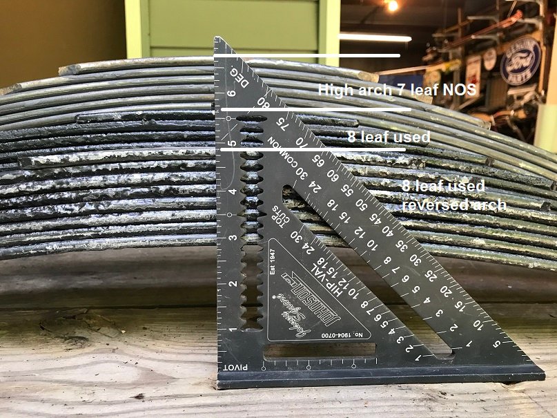

These springs are resting on the ground - no load on them. I just added as a reference for lowering. You should be able to count the springs that you can see and then there may be 1 other in the cross member tunnel.
The only way you can really tell what you have is to remove them. Unless you have a real issue with ride comfort I'd pass on further investigation. If your just curious, let it be and move on. If you brought this to a dealer and said I think my front spring may be worn, I'm sure he would have replaced them based on your analysis.
This link has measurements of each individual spring https://mtfca.com/phpBB3/viewtopic.php?t=774

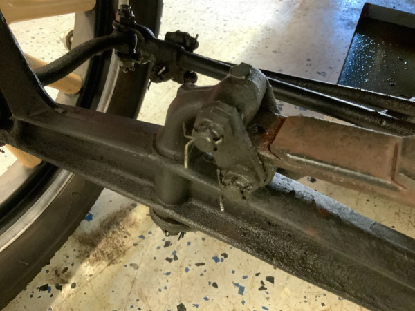

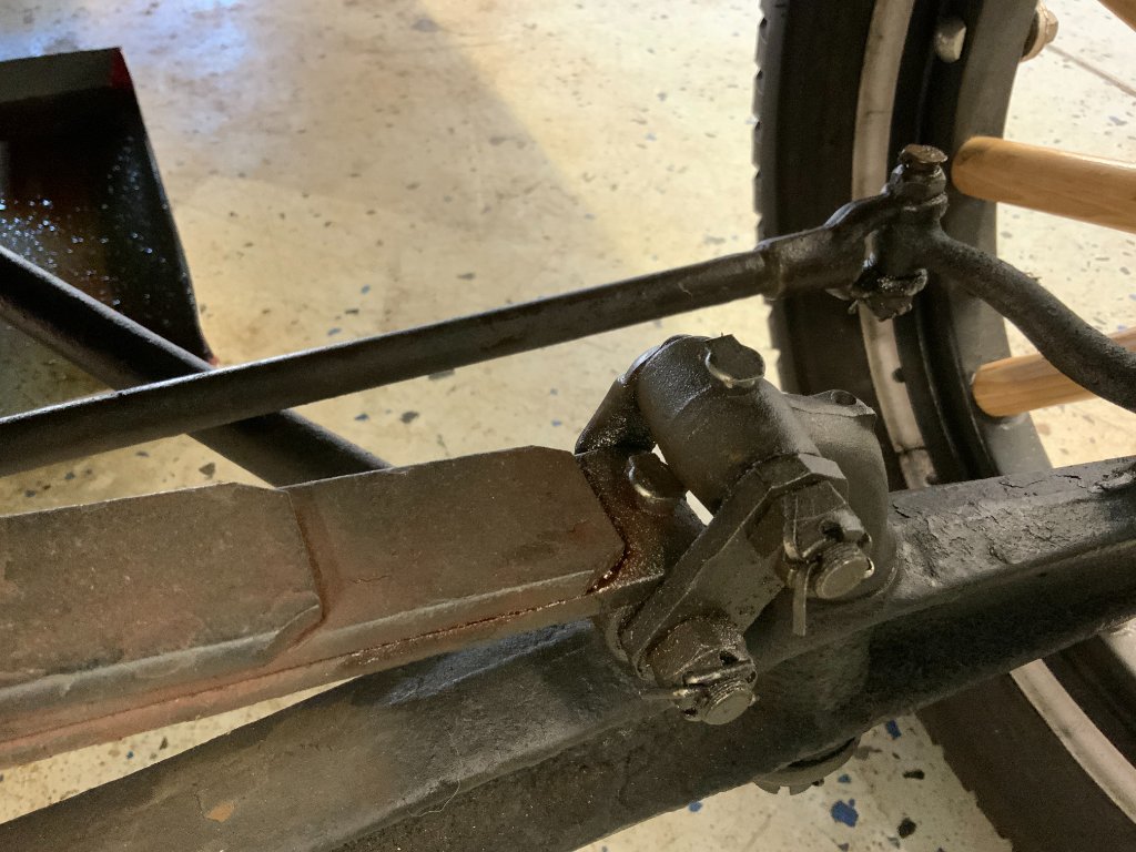

Thanks for the input on measurements. I have measured the spring on the car and the measurement from center of screw below crank cover to bottom axle is 6 3/4" as recommended. Center to center of eyes on the main leaf is 32" so it appears that everything is within spec. What lead me down this road was the difficulty getting at the oilers on the bottom end of the shackles. Maybe that's just the nature of the beast. I'll try to attach a couple of pics to see if they look ok to you guys.

That oiler can be problematic at best - I use a small bar to lever over the spring to oil.
Posts: 3899
Location: Lomita, California
Re: 26-27 Front spring
Post by Original Smith » Wed Jun 15, 2022 11:10 am
I have the oiler on my spring placed so it will open fairly easy from the side. I can usually flick it open with the end of my oil can.

Thanks guys for all the input. Looks like I will stay with what I have. I plan to put a few new oilers in to replace some missing/damaged ones, so I will try to position the ones in the shackles for easiest access.
