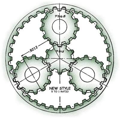

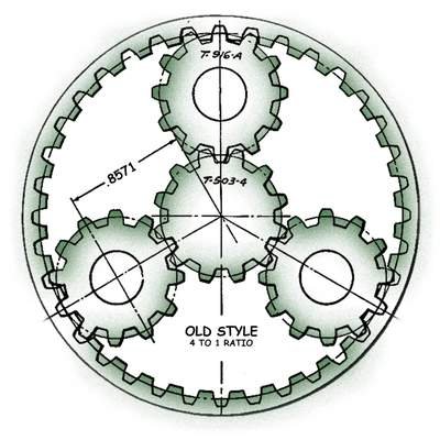

Hello Group. Can someone please tell me if there is a difference between the steering shafts on a 1926/27 and previous years? I have a pre-1926 column assy. (round flange) and want to know if I purchase the correct version (square flange) and correct mounting bracket to frame, will the steering shaft work, or there a different one needed for the '26?

Big difference!. T1 manual has a warning about mixing parts. This can be deadly.
The later(5-1) steering ratio shaft pins are located on a different radius to compensate for the different planetary gear diameters.
Get & read the T1 service manual.
You should get a complete correct 26-7 steering column. But be aware to check the innards to get the correct 5-1 package.

Besides the issues with the different gear ratio, the 26-27 column mounts at a different angle that the earlier column.
Posts: 7307
Re: Steering Shaft 1926
Post by Allan » Thu Jun 23, 2022 9:00 pm
John makes a very good point. The steering column in the 26-7 improved cars was lowered. This means that the flange to firewall mount is different, the hole in the firewall is lowered, and the steering bracket at the frame is set at a different angle. Making these components fit in an earlier car is fraught with difficulty.
I do believe the steering shafts can be switched between them, as long as the planetary gears are also switched. Then you have the problem of unfamiliar components getting to know one another in the steering box under the wheel.

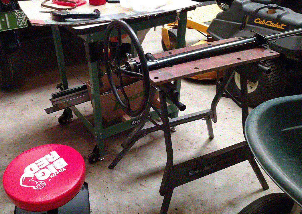

Allan is right about the unfamiliar components. When I rebuilt my steering column, I replaced the shaft, pins, gears and gearcase. I had to break in the assembly at the bench to get the parts to play together. I put a small dab of fine valve lapping compound on the gears, pulled up a stool and spun the steering wheel for about a half hour. She spins like butter now.

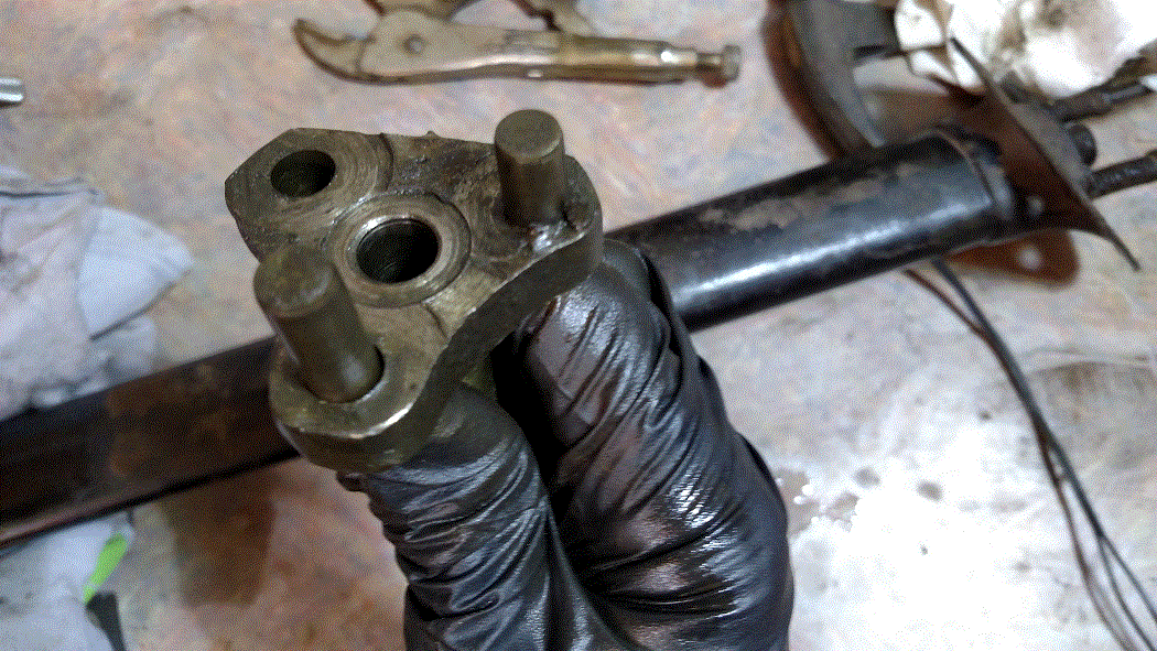

I don't know if it is a certainty or not? However, generally, the earlier 4 to 1 steering shaft has three concave sides on the three pin top end part. Later 5 to 1 shafts have two concave sides and one flat side.

What Wayne said. That flat side makes spotting a 5to1 shaft very easy, even when covered in grease. ;) Dave

This is a 5:1 that was in my '26. Note the flat side.
