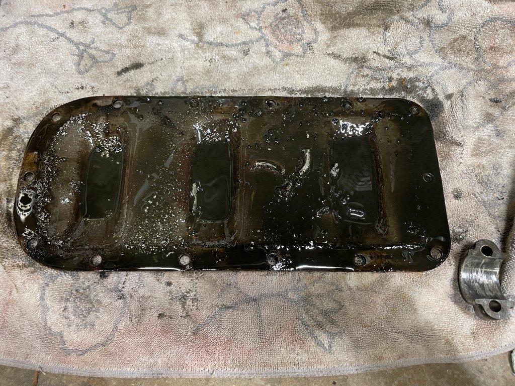

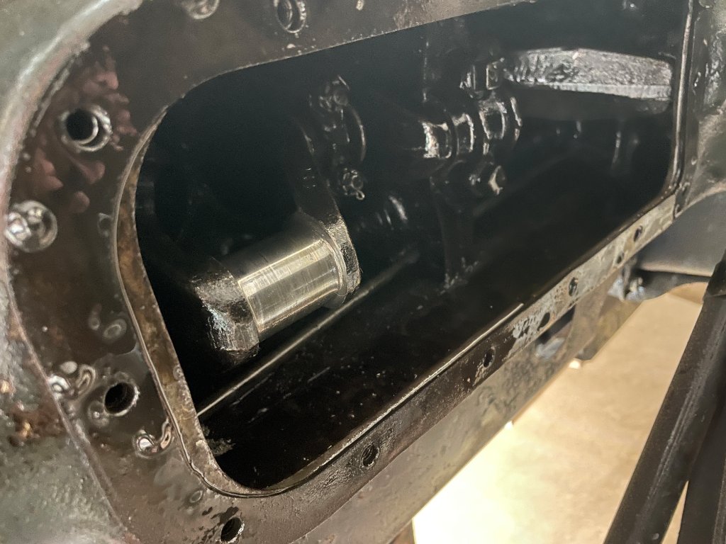

Many thanks for comments. I pulled the cover off and immediately found a lot of bearing material. See pics. The big end of rod #1 was clearly the source. My son rotated the engine while I inspected the others and they seem fine. Pistons appear to be iron. I pulled the cap and there is a very thin layer of babbitt still holding on. This might explain the nearly pristine rod journal. There is very light, normal wear. No scoring and no heat bluing. A fingernail glides across it unfettered. It measures 1.246" Aside from some concern for the condition of the other bearings, am I wrong in thinking I can scrounge a replacement rod and carry on? We may get in some family drives this summer after all. Of course, the head gasket might be a problem.

I should also say that this car (and Model Ts in general) is unfamiliar to me. I assume it is old babbitt. The pieces are mostly small crumbly bits. As seem in the pic, there are some larger pieces with a radius that appear to be a thrust surface on the sides of the rod.

The crank pin needs to be carefully checked with a micrometer. They tend to get out of round, and out of round and taper need to be checked for carefully. It's also important to get as much debris out of the engine as possible. A newly-re-babbited rod that is fitted correctly may get you by, if the crankpin checks out good. Another thing to consider is that your oil pipe may be clogged, which is a possible cause of the rod bearing failing. Another possibility is that, after the bearing failed, the loose rod allowed the piston to hit the cylinder head, which may have pinched the top ring groove or cracked the ring or ring land.

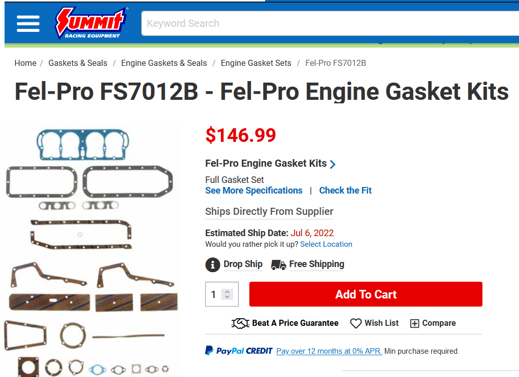

As far as T head gaskets are concerned copper head gaskets are currently unavailable but the engine overhaul gaskets sets that are Fel-Pro brand are available at Auto-Zone by special order from their supply house. Their sets have the conventional head gaskets that aren’t copper and do work. It’s not necessary to use copper but purists do like to.
Fel Pro part no. FS 7012B for around 160.00 for the engine gasket set. You can call Auto Zone
or another auto parts dealer that handles Fel Pro brand products to see if they can get a set.

Best prices. Discounts on first order as well as order totals. NOTE FREE SHIPPING

That’s good! I forgot about Summit and Jegs! And free shipping. Thanks for the update.
