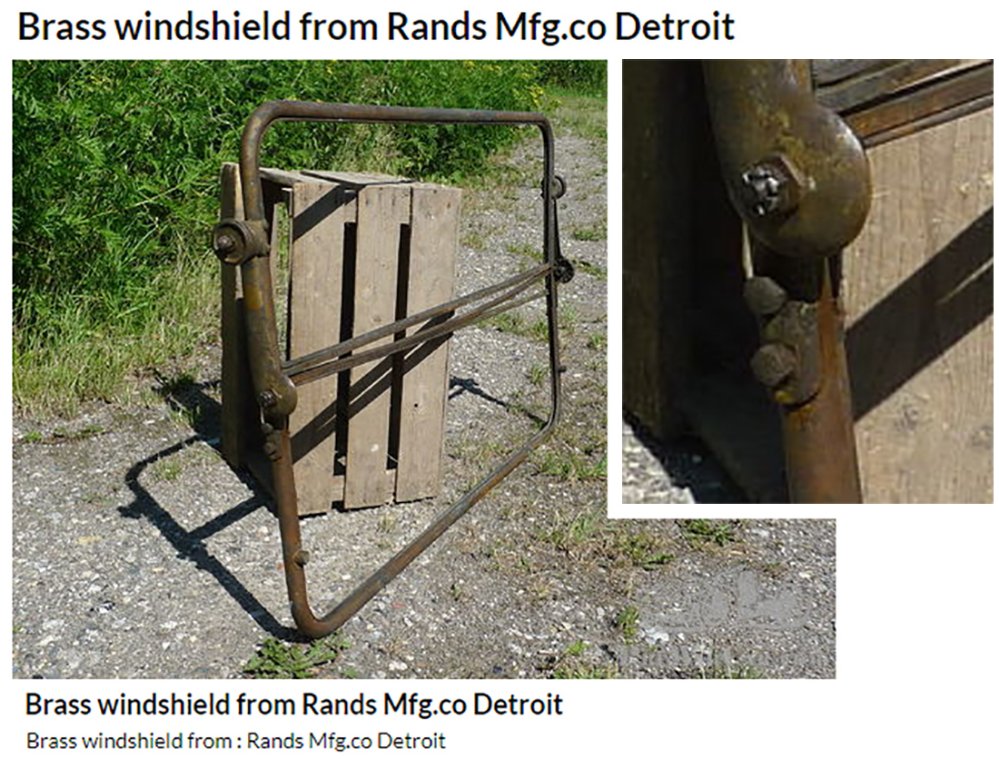

Post by Rich Eagle » Wed Jul 06, 2022 12:16 pm
I see this add for a "Rands" windshield. It is a different hinge but it has hex bolts. That suggests to me that hex may have been used by Rands.
https://www.prewarcar.com/289452-brass- ... co-detroit
Other than that I have seen no evidence in other than round head slotted bolts in my limited experience. I doubt that few would argue about using round heads but some might disagree with hex heads.
This is just my take on the matter.

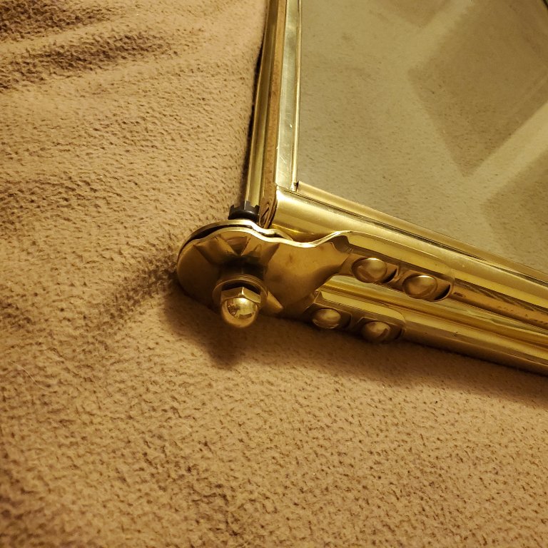

Post by RGould1910 » Sat Jul 09, 2022 1:14 am
Brass plated bolts on the 1910, screws on the 1912. Both Rands windshields. Photo shows the 1912.
