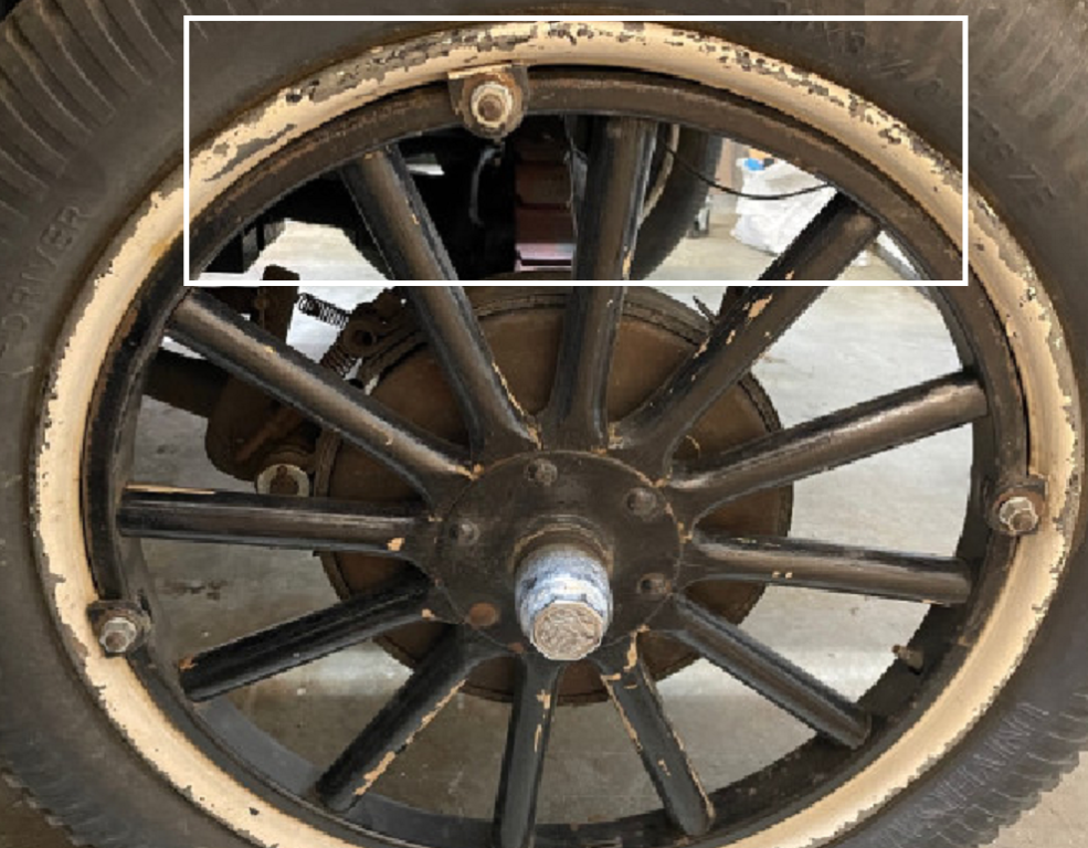

I noticed today that I have some clicking from one of the wood wheels on the 22. Some investigation showed loose spokes on two wheels. My wheels have the metal rings not wood felloes so spoke replacement is not a gargantuan task and I wanted to touch up the paint on the wheels anyway.
In looking at the catalogues I see various options for the spokes. Ford vs Kelsey Hayes being options. But, I don’t know how to tell what wheels I have. Here is a picture of the loose wheel. Can anyone tell me what I have (from the picture) or tell me how to figure it out?

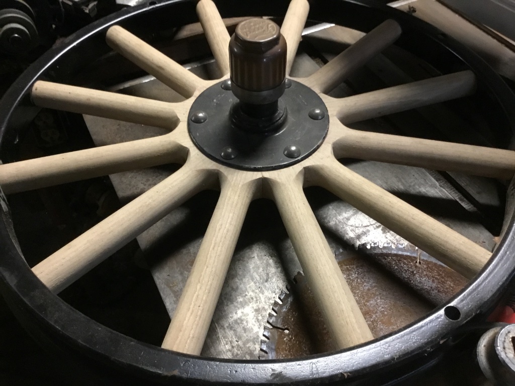

You may have a Canadian wheel. If this is the case, the hub end of the wheel spokes is different from the US wheels. All spokes taper at the hub end to fit around the hub. On US made wheels the faces between the spokes are square to the face on which the hub and plate impinge. On Canadian Kelsey wheels, the faces between the spokes are angled to make a taper between the spokes. When the wheel is assembled these angles alternate between spokes, one one way round, the next turned 180* . This makes assembly/dis-assembly much easier, as no press is needed. It also results in a tighter assembly.
Photos of all you wheels would help us sort out what you have, and perhaps help you sort out which combinations may be safe. Photos should focus on the the rim bolt/lug area, the cross section of the steel felloe, and the shape of the rim where it fits on the felloe.

The wheel in the pic looks like a Hayes wheel to me, it would take the 1/32 inch longer spokes.
I don't see any cracked or rotted spokes in the picture. If a few spokes are just loose and the vendors don't have any of the longer spokes in stock, you could try shimming the ends of the loose spokes to tighten the wheel up.

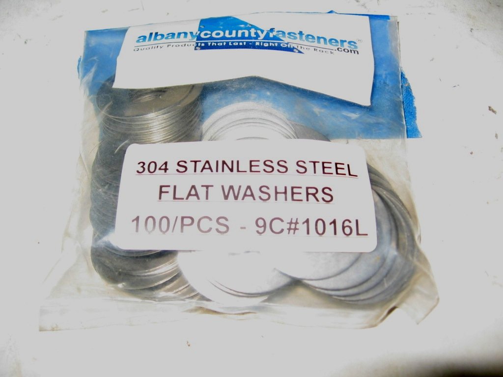

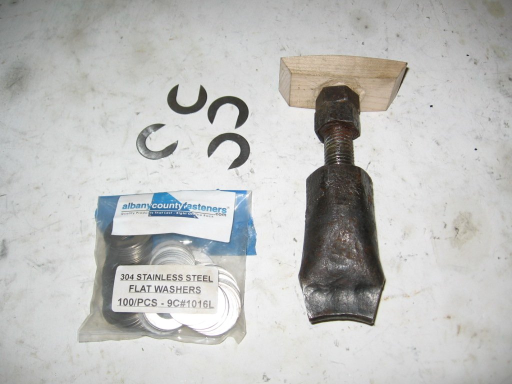

You'll need a spoke jack and some shims. I make my shims from 1/32 inch thick stainless steel washers. I cut a slot in one side of the washer so that I can slip in the shim while the spoke jack holds the felloe away from the end of the spoke.

Thanks for the information. Shims would be a good shot term solution, but I would like to replace the spokes and do the job right.
The large drum is for the rocky mountain brakes. Interesting that the rims are for a different style wheel. I will have to do some research on the wheel types.

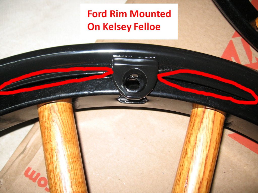

That is a mis-matched wheel & rim combination Morgan - the wheel was designed to accept the "loose " lug - see those short slots in the felloe ? The correct rim would NOT have the lugs attached as your does. After 100 + years, it's rather difficult to come up with a truly "matched" set of wheels & rims.

You may have a mismatch of felloe & rim. If that is a gap between the felloe and rim it would cause clicking and eventually damaged spokes. You need to identify both the manufacturer of the rim and felloe
There are many invalid combinations

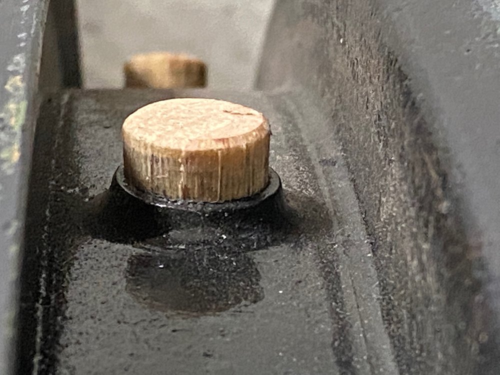

If you take the rim off the felloe, take a look at the tenons where the protrude thru the hole in the felloe. If the nubs look like warts, they may be rotten and although the spoke may look good, it wouldn't take much to break the tenon. The first photo shows a "warty" tenon on the right and what a similar spoke looked like after I gave the spoke a couple of whacks with a hammer. It sheared right off. The second photo shows what they look like new.

Morgan, I see the nub of the issue as the way the rims fit the felloes. Some combinations can be safe, others less so.
The Kelsey loose lug wheels you have take a rim with no lugs, other than a bridging lug over the bolt nearest to the valve stem. This fixed lug is there to prevent the rim sliding around the wheel and tearing out the valve stem. It is NOT a driving lug, although many are worn out of shape when the rim is driven on while loose on the felloe.
Kelsey loose lug rims are designed to wedge firmly on the outer rolled in edge of the felloe. The lugs and bolts are there to maintain this wedging effect, and that is what drives the wheel. On good rims and un-worn felloes, you can pass a credit card between the rim and felloe on the inside of the wheel.
Our Kelsey fixed lug wheels which are fitted to our late 25 T's have a felloe with a wider outwardly rolled edge on the inner side. The fixed lug rims wedge on this wider inner ledge. The four bolts maintain the wedging effect. The lugs stand off the outside face of the felloe, and the credit card will pass between the rim and felloe on the outside ledge, if all the components are not worn.
So, on any set of wheels, all the bolts do is maintain the wedging of the rim on the felloe. Mixing and matching different years and brands needs to keep this in mind.
Your wheel/rim combination shown in your photo shows a significant gap between the rim and the outer edge of the felloe, so no wedging there. With the narrow inside ledge on a Kelsey loose lug felloe, it is not likely wedged there either. Hence all the driving force is taken only on the four rim bolts, making it critical that those bolts be in very good condition and are kept tight at all times.
In summary, any combination of rim/felloe which will allow the two to make the wedge fit, maintained by the four bolts, is the best. Anything else is a compromise, which may work, but not as intended. No doubt there are many cars on the road with mixes, some known, others not, and many of these will work, but may not be as safe as they need o be.
