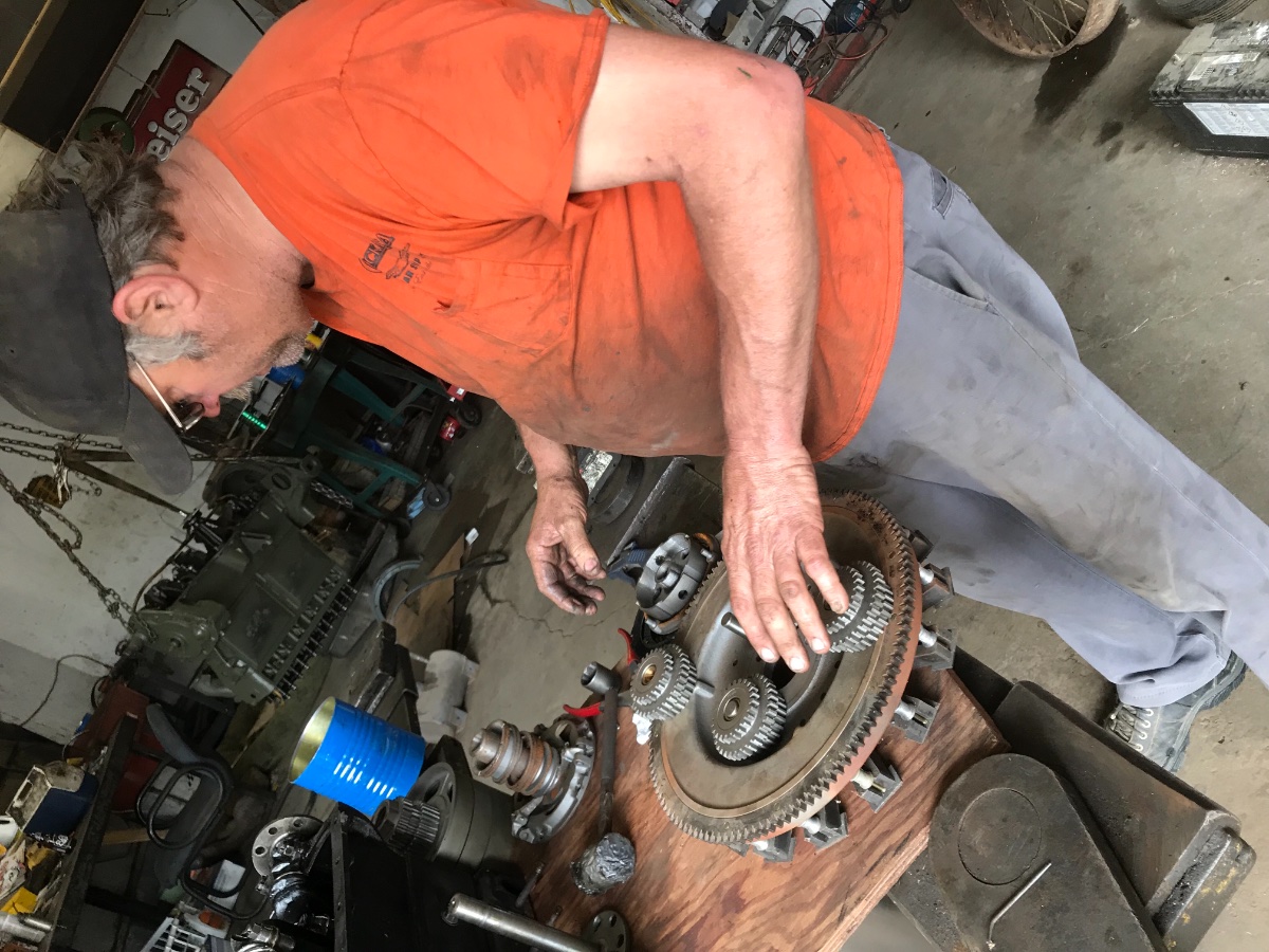

Well, Erik Barrett certainly saved the day. He’s got a completely rebuilt 27 trans we’re putting in the car right now. And he had a 280 cam just lying around that I’m putting to good use. And he’s touchingly up the valve seats.
The tranny is perfect. All new bushings, new clutch, new ring gear etc. And the drums have much more material than mine did. Talk about lucky - it’s my lucky day. I should be able to get it all back in the car next week.

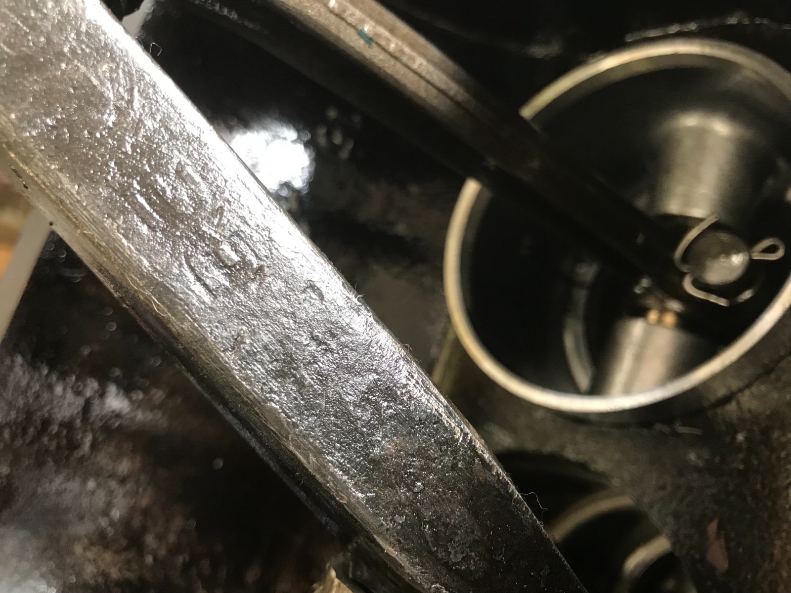

And I got a nice little surprise-Erik’s eagle eye spotted something on my crankshaft. See if you can see it.

Appears someone stamped a couple E's on there...Maybe Elvis

The cotter pin in the wrist pin bolt, isn't doing you much good.
Herm.
Herm.
Kerry
- Posts: 1463
- Last Name: van Ekeren
Re: New transmission - I’m saved by Erik Barrett
And while fixing what Herm has picked up on, I'd be drilling oil holes in the pistons for the wrist pins as well.

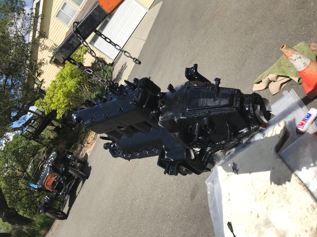

Jeff is going home tomorrow with his engine. We did it with partner Robert Weitzel. We took care of the other issues while we were in there, Jeff will be touring in no time. Would not have been possible without all the help.

That has to be the Understatement of the year (but it is only April...) Seriously, I’m in awe and now have a brain full of T knowledge to digest. I arrived at 10:30 am yesterday and we did all this by 9pm today.Erik Barrett wrote: ↑Tue Apr 16, 2019 2:04 amJeff is going home tomorrow with his engine. We did it with partner Robert Weitzel. We took care of the other issues while we were in there, Jeff will be touring in no time. Would not have been possible without all the help.
-New 280 grind cam, new tappets where needed
-New bronze cam gear
-Complete valve job including facing and grinding of all valves and valve seats
-Tear down of a “rebuilt” ‘27 transmission
-Adjust/reem all transmission bushings and bearings for proper clearance
-Replace low pedal shaft and refurbished/welded the pedal cam gears which were totally worn out and likely contributed to the low drum failure
-New clutch spring
-Re-banded low and reverse with Kevlar linings (destroyed by the “incident “) - thanks Harold!!
-Reassembly and adjustment of transmission
-reshim & adjustment all rod bearings
-clean everything and reassemble.
Wow. I almost collapsed from exhaustion last night but I paced myself today and made it thru ok. Erik and his dad are true gentleman and their Model T knowledge is simply amazing. Their shop is equipped with literally every tool, jig and “T” implement imaginable. And the spare parts...they go on for miles. I got lost more than a few times. Thankfully I left a trail of peanuts each time to help men find my way back.
This was a team rally like none other, and I’ve been racing cars for 20 years and had my share of rebuilds, of all types, and at all hours. But 100 year old technology kicks my ass. And in totally unexpected ways.
Things are simple but technically innovative and quite unique. Stuff had to be invented back then out of necessity where there was no precedent or prior art. Some of the fixes to problems we encountered had me scratching my head but this quote from Erik sums it up nicely, “it lasted 100 years so far, this fix will last another 100.”
Indeed, some of Erik’s fixed may last longer than that.
My sincere thanks to Erik and Harold “Dad” Barrett and Robert Weitzel for the last 36 “insane” hours. I’ll never forget this experience.

And the final touch before I put it back to work.
