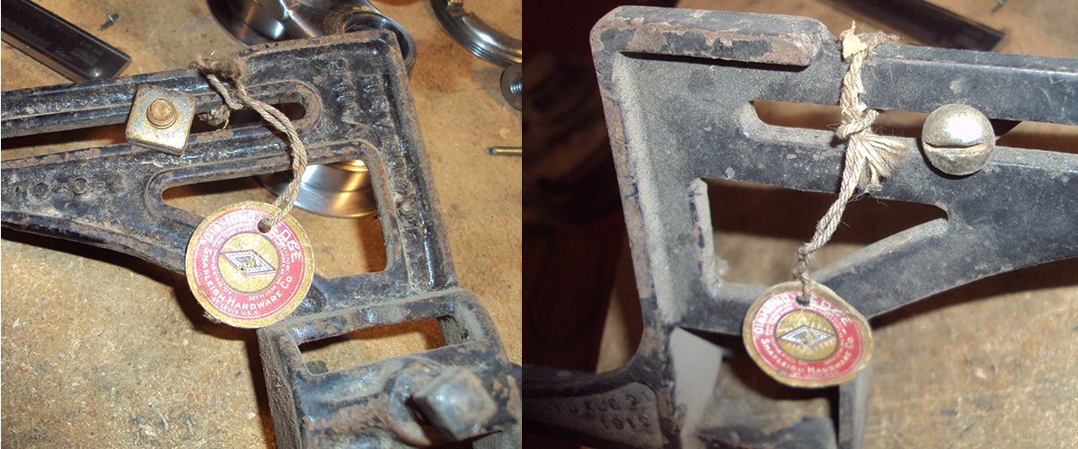

My thought is the factory would not supply bolts there. You would furnish your own if and when you bought your license plate. I have seen bailing wire there several times on survivors. I use stove bolts thinking they were readily available. That being said, this nice nickled bolt came with this accessory bracket (Pat 1912).

The question is about the bolts used to fasten the license plate bracket to the body, not the fasteners used to attach the plate to the bracket.
Re: 1915 roadster license plate bracket to body bolts
Post by Rich Eagle » Tue Apr 16, 2019 1:48 pm
Good call Erik. We should all read more carefully. It would make sense that the carraige bolt head stayed in the wood and the threads stuck out to mount the bracket. The question would be if square or hex bolts would be used. My guess is large hex with lock washers as your photo shows.
