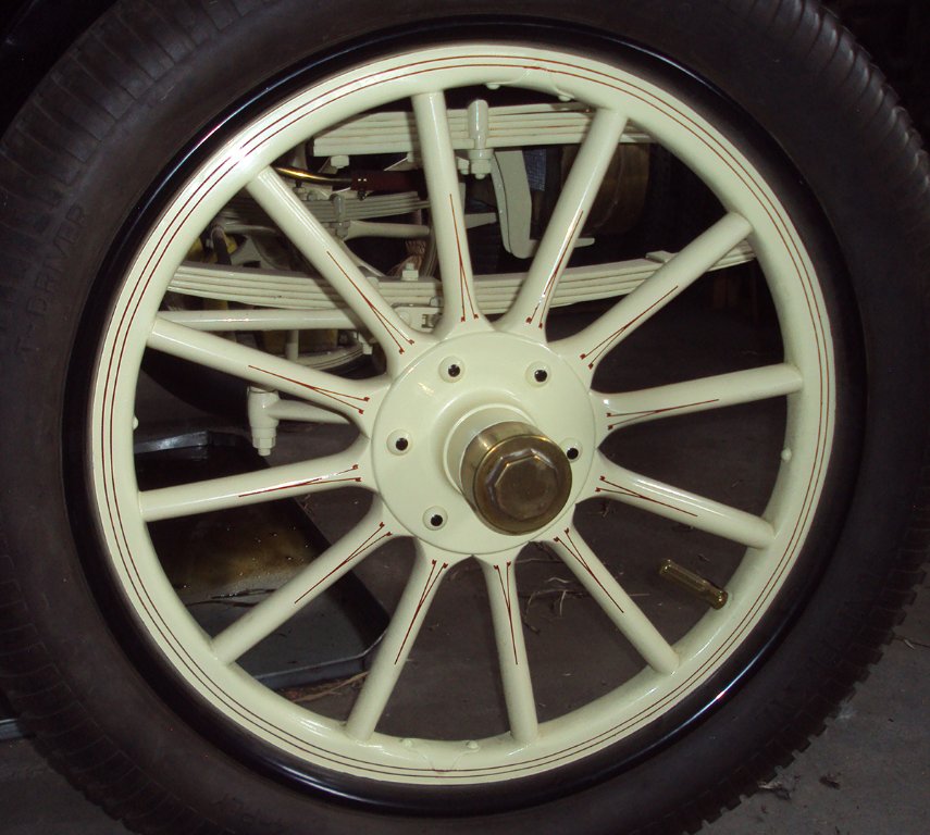

Did by Brush using finish is hard. The color of the wheel looks like its picture and not the paint chip. The paint flows well
ih white.png (119.78 KiB) Viewed 4235 times

Frank, Nice looking wheel, that is the color I want.
What do you mean "using finish is hard" ?
Bruce

was either dyslexia or Yoda - Did by using Brush, paint cured to a hard finish.
Needed several coats because of the light color. Pipe mounting shown is what I used to rotate the wheel (less the tire).

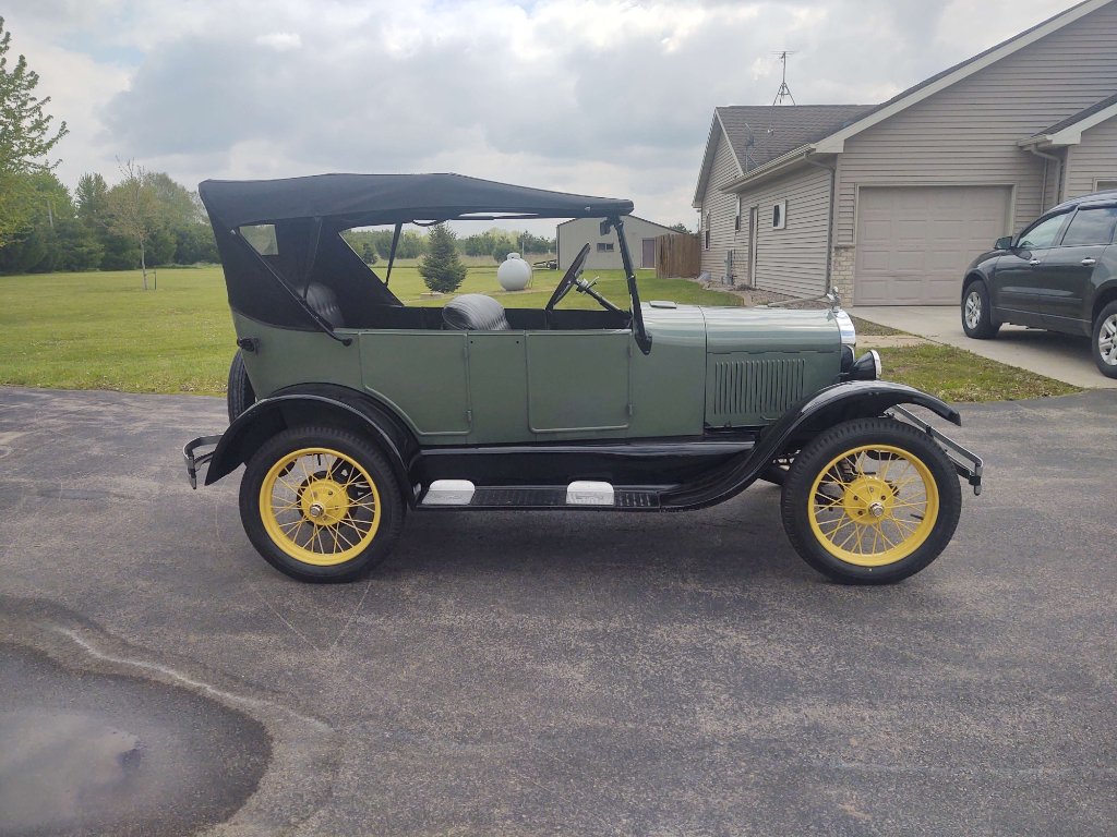

Re: Painting Wire Wheels by Brush?????????
Post by Rich Eagle » Sun Jul 17, 2022 8:40 pm

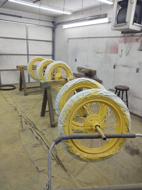

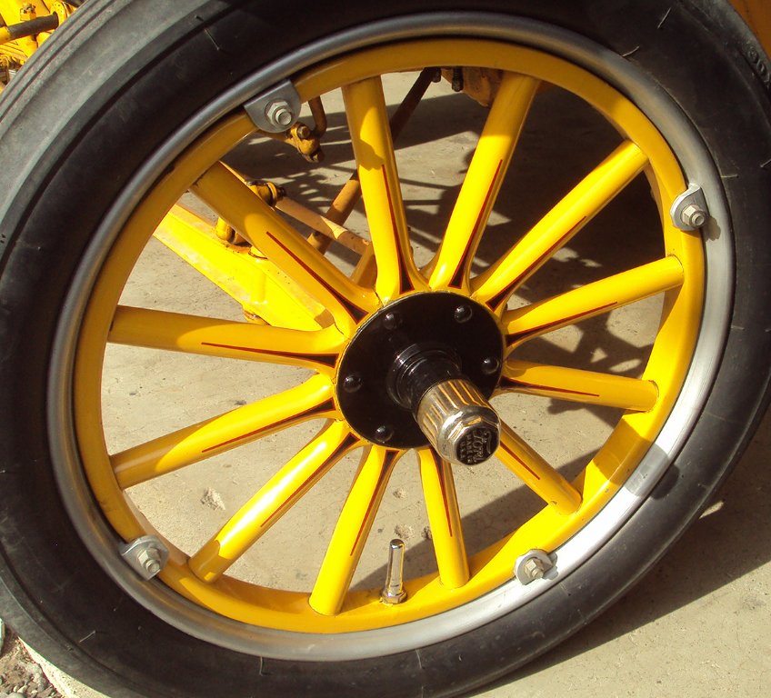

OK, I know these are wood spokes but the brushing is much the same. I brush painted the yellow Speedster wheels in 1985 when Dulux enamel was available.
This Buick wheel was brush painted with Centari® Acrylic Enamel with a slow-drying agent in about 2004.
Setting the wheel hub on a table I can paint one side of the first spoke, then flip the wheel over and coat the second side of the first spoke and this side of the second. Back and forth until they are all painted. The paint flows evenly on each spoke that way. The felloe can be done between each spoke as I go or all at once after the spokes. Upright on a bar would work just as well if chosen. There are no runs and everything is coated evenly. I put two coats on. After painting a dozen sets of wheels this is how I like to do it.
The pin stripes are fun to and add a lot to the look. The could distract from any imperfections too if there were any.
These pictures were just taken today so you see the paint has held up well since applied.

Post by catfishunter99 » Sun Jul 17, 2022 9:13 pm

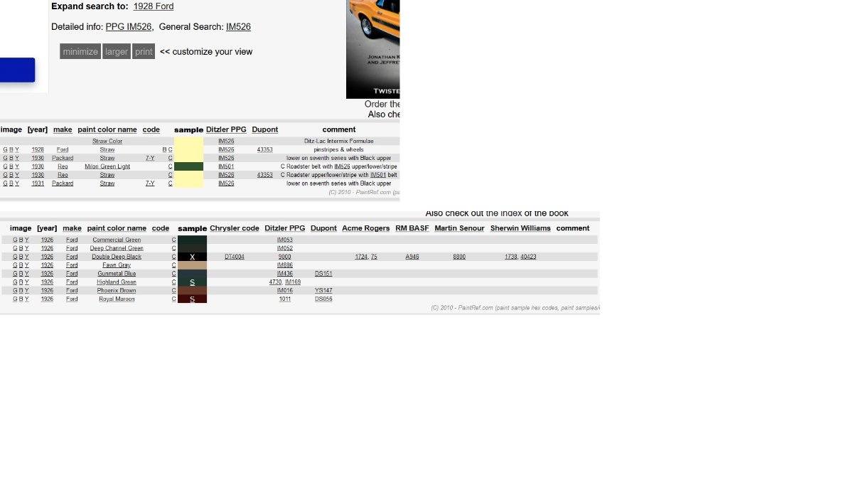

Sprayed the wheels on our 26 with single stage enamel with hardner. Had the local paint store mix up a quart using the original straw paint code.

Lorien, What was the "original straw paint code"?

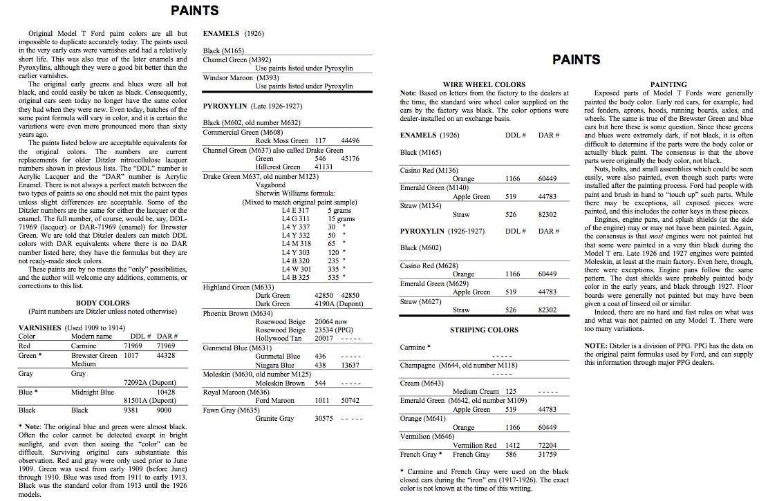

Posts: 6549
Post by TRDxB2 » Mon Jul 18, 2022 1:49 am
Paint Codes
