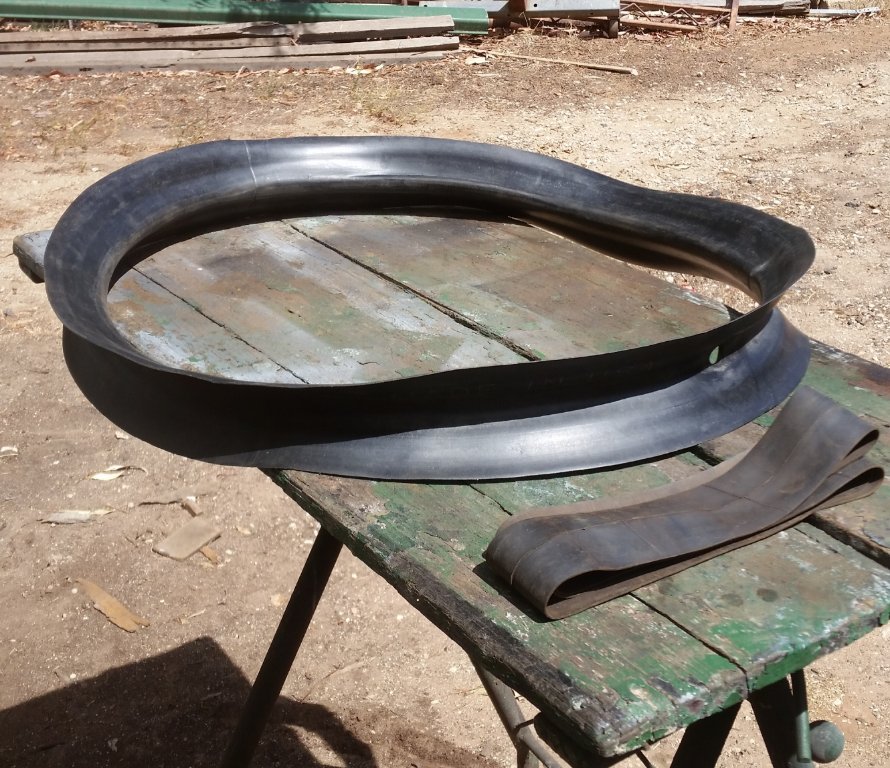

Here is a bulky new flap and a rim liner cut from the OD of a used 13" tube saved for me by my local tyre shop.

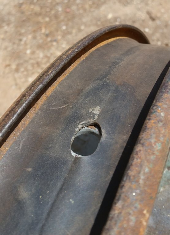

Here is the rim liner fitted to the rim. It is a snap fit and will not move when fitting the tyre.

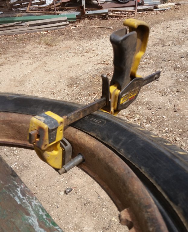

I put the partially inflated tube in the tyre, clamp both beads in the rim at the valve stem, and lever both sides on at the same time.
I can't see the value of adding all that weight to the rotating mass of the wheel, let alone the significant decrease in my bank balance for a set of flaps.

Your use of the clamps either side of the valve stem makes the job much easier.
