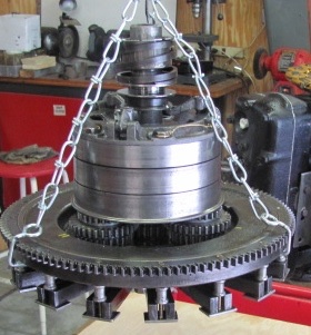

I've used this one for so many transmission jobs I couldn't count them all - never had a problem !

Mine I like Steve's, except that the hook not only goes under the flywheel, the ends are bent to go around a magnet spool and come back out again. I made them from tough wire wheel spokes.

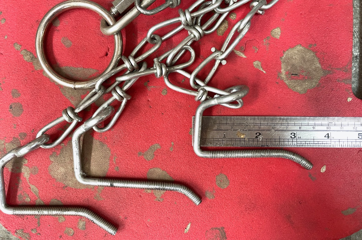

Steve, did you use an unmodified hardware store hook? If so, what size and can you show a better picture of the hook bolted to the chain? The MTFCA transmission book shows a homemade 1/4" hook design that requires several bends. Your design appears to be simpler to make. Thanks

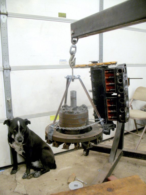

Here's mine. Works OK so far.

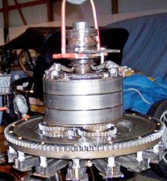

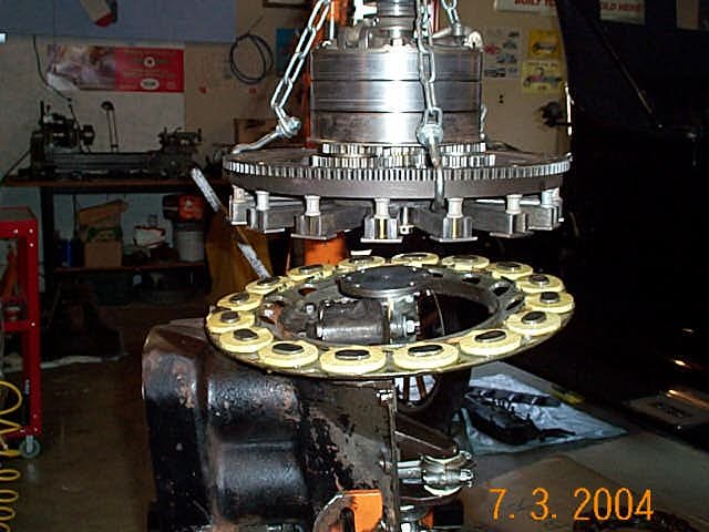

Another member posted his version of a plate, that seems good. For use, the chain assembly is easy to position, and to remove. You have to do that many times in setting the magnet gap to the coil ring, as you lift and drop, lift and drop :lol: The chain hooks hold firm, but you do have to take care not to twist fast the heavy piece around. The double hook around a magnet post is perhaps nice, but may take a bit more wiggle to get the 3 hooks in place.
Also mark, with an ink marker, the side and back edge of the crank flange at two of the holes, to be sure that the same two dowels always go into the same two holes as you set the gaps.

I made one like the first and last picture. Works like a charm. I’m through with it and would sell...

The dog ain't buyin' it.
